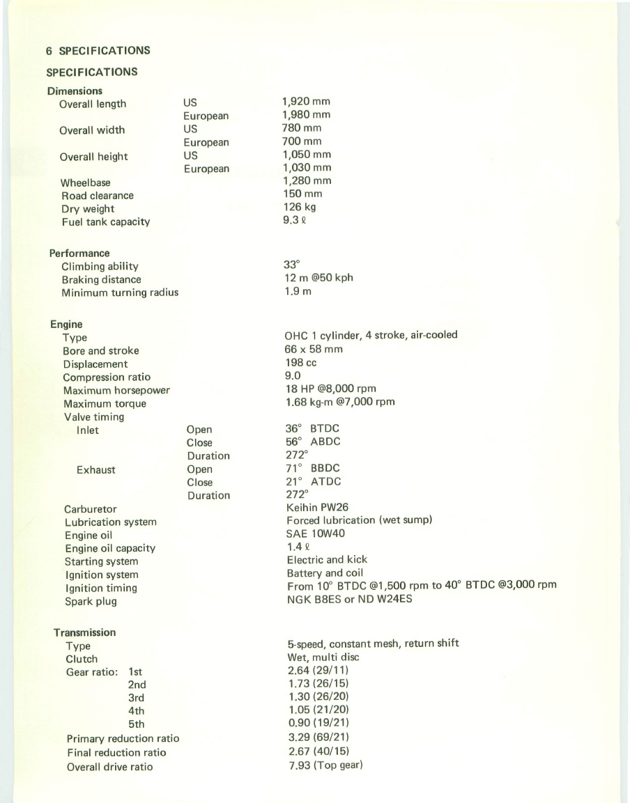

Hello Lasse i guess you are from Norway to. Are you sure you have the right sparkplug i think it should be b8es wich is a hotter plug.

B9ES Possibly a too cool plug.
Try a set of B7ES. They will run a little hotter and keep the electrodes cleaner which will allow a cleaner spark which is required at lower revs. .
Just make sure you don't have resistors in plug caps and resistor plugs (BR((resistor)) 7ES). Only one resistor at most in any one ignition line.

hi Rolf, I'm from Sweden.
@ Warren3200gt
I think I just looked at what spark plug was in the engine when I bought a new one, in my doc it says B7ES.
I'll buy a B7ES and check what happens

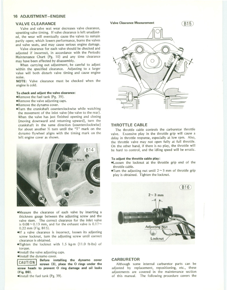

ok, I'll check the valve clearence, but wouldn't you here if the clearence is to small (valves not closing) when you pull of the gas handle?
I guess it could also be piston rings, but it doesn't smoke black.

21 May 2024 00:48You wouldn't necessarily "hear" anything but the valves would be closed for less time so the motor can't build pressure (same as long duration performance cams lower static compression for the same reason)@ Rolf1976_KZ900

Hard to start when warm is a classic example of poor compression, commonly caused by overly tight valves.

I've checked the valve clearance and it is between limits.
Oil level a little low but between marks.
