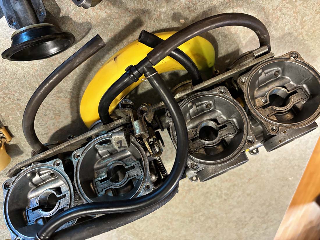

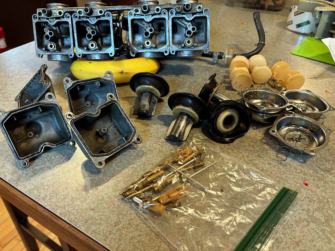

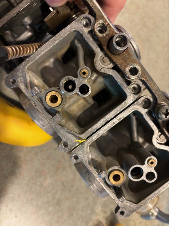

Here are the carbs that came off the bike.
When I got the bike (non-running) I pulled the carbs off the bike. Very clear PO took the carbs off the bike and 100% dismantled them. Then tried to put them back together. Yellow plumbing tape evident at carb joints, spacing is weird. He has one carb marked #1 which is is #2 on the rack. When I pulled them from the bike I could hear small springs hitting the ground from the rack of carbs.
I'm not a CV carb rebuild guy. At all.
monkey food for scale and prop use.

I'm a carb guy. Chances are high that I could get those sorted, as long as parts are not missing. Clay is another that could get them back together...
That "1" mark seems to be written on the throttle cable bracket.
