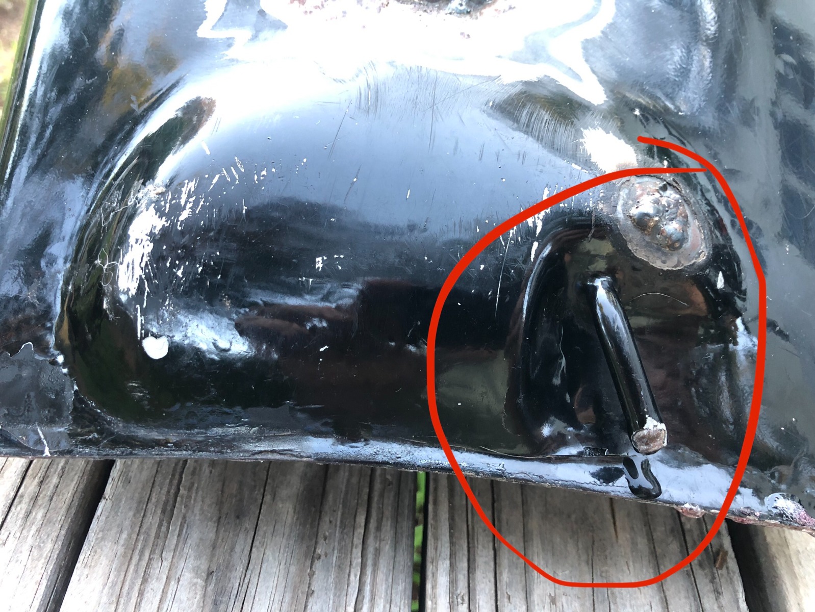

Hi all,
I recently picked up a 1985 LTD 1100 as a project bike. I've been working on sealing up the fuel tank, and am preparing to re-mount it to the bike. I've done my research, and everything seems very simple - but I'm confused at what looks like a small nipple/tube running out from the bottom of the tank. It's leaked fluid in my sealing of the tank, so I am very nervous about just leaving it open. I have two vacuum lines (one for the petcock), so I was assuming that this was some kind of breather line or something of that nature. I just want to make sure that I am not making a massive mistake by hooking this up to a vacuum line.
I've attached an image below, all help is appreciated as I am relatively new to working on bikes.
Thanks!
Thanks!

Can you show another picture that is not so close to the tank

Isn’t that the vent? It should come from the filler cap area, but if fluid came out, it may have rusted through, and will have to be repaired or it will leak fuel.
Parts diagram seems to show a pair of them.
www.partzilla.com/catalog/kawasaki/motor...-zn1100-b2/fuel-tank

Sorry for the delayed response. What I thought was fluid leaking from the vent, was from me spraying water down the vent while degreasing the inside of the tank. I've got the tank sealed up and on the bike now, but I've hit a new problem.
