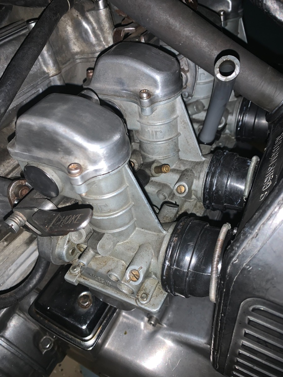

Recently I had my carbs cleaned by a local shop I've used in the past. I reinstalled the carbs. Since then I've had an issue with
the number two and three carbs not functioning properly. This morning I discovered the small connecting hose between the number two and three carbs
is not connected properly. (see picture) It appears that I will have to remove the carbs (again) to correct this issue. My question is: What kind of gas flow problems
would be caused by this hose not being connected properly? Would it affect the gas flow to the number two and three cylinders? Thanks for your help.

That’s a vent to help balance atmospheric pressure between carbs. Just an FYI that can’t be between 2&3 carbs. It can only be between 1&2 or 3&4. Your problem is more likely the open vacuum brass nipple on carb number 2 rear in your picture. That should feed vacuum to your Petcock.

My mistake. It is between 1 and 2. The gas tank of off. That's why the vacuum line is not connected.

What symptoms are you experiencing. That vent won’t cause any problems. If you could use a rounded blunt tool and push the hose back into position it will work as designed.

If those are #1 and #2 carbs...are the fuel/air screws facing each other? The carb on the left (#1 I think) looks to have the fuel/air screw facing inwards. If so then at least two of the carbs are mounted incorrectly on the face plate. If you look at the carbs carefully you can see ports on either side for the fuel Tee connection. But only one side on each carb is open to the float valve. The other side is sealed off.
Edited to add that each carb has a specific position on the face plate. They are not interchangeable.

I have a couple of sets of 24's so I went to check them just to be sure. The fuel Tee is in the middle, between 2 and 3. There are connections between 1 and 2 and between 3 and 4. So 2 and 3 have fuel inlet/outlet on both sides, not just one as I mentioned above. 1 and 4 have one access to the float valve. The other one is sealed.
As mentioned above, each carb has a unique position on the face plate. Can you confirm they are all in the correct place? A couple of photos of the carbs would be useful.

The coil for cylinders 2& 3 was cracked, so I replaced it. I borrowed a infrared heat gun and the number 2 & 3 exhaust read around 90. (This is in Florida). I'm attaching pictures of all four carbs. Let me know if you see something which might cause the problem. It's puzzling because the engine runs very smoothly. (I temporarily moved the air intake springs back in preparation of removing the carbs)

The carbs look to be properly mounted on the faceplate so fuel to the carbs should be correct.
You say you have spark on all cylinders, so the ignition system should be functioning correctly. Otherwise I might suspect a problem with the timing pickup or with the igniter.
Normal fuel flow is into the T between 2 and 3 and then from 2 to 1 and from 3 to 4. If 1 and 4 are running normally it suggests fuel is getting to them correctly. The problem may be with the internals on 2 and 3. Can you check via the bowl drain to see if you are getting gas into the bowls?

After further checking it appears that the carbs are way too rich. I pulled the plug wires on number one and four and it turns out that two and three will run, but not very well. The plugs are very dark/black. So, I'm going to lean them up a bit and see what happens. Thanks for all your help.

I didn’t get a chance to reply but I noticed #2 carb air pilot looked turned in a bunch more than #1. That would make #2 richer than #1. Turn them all in lightly seated and back out about 1 1/4 turns. Start the bike and adjust pilots for best idle. You can clean up the plugs with a propane torch. Or buy new. Either should be done before the next start/tune
