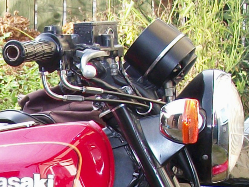

Well i have to say, never realised before how hard it is to fit the throttle cables, suppose you dont until you try, it also explains why mines only got the open cable and a large spring to close.
but when you look at the mechanics, i can see Warrens explanation makes perfect sense as after fitting the 1st the 2nd would indeed hit the 1st if the curves were identical, not sure how much flex is available on the curve to allow it to squeeze past, or whether screwing 1 fully home will allow sufficient entry of the 2nd but do know it doesnt take much to chew up the alluminium threads in the housing. Think personally I'd go for the different angled cables as they are probably easier to install and no issues bending them, which may cause fracture or risk damaging the housing thread.
like several others i was about to order 2 of the same, glad i didnt now.
Perhaps if someone manages it with identical 2 they could post a guide on exactly how they managed it, for all us doubting Thomas's!
ammendment, after writing the above post did a bit of research on this after looking at several cable options, push and pull on ebay, ive arrived at the conclusion there are 2 soecific types depending on
manufacturer.
The 1st type uses 2 different bend
angles to allow them to be screwed into the housing without hitting each other as per Warrens photo.
1The 2nd type uses identical bend angles but has the threaded part set a different height from each other, therebly allowing them to be screwed in without hitting.
either type will work as a pair but not sure if you mix them they will so pay attention when ordering replacements.
Thought this may help others.
