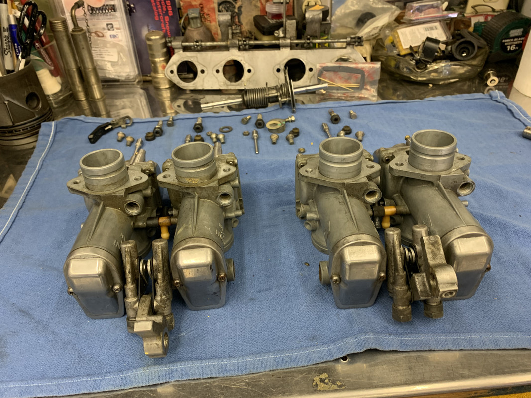

Re: Choke Plungers Failing ?
02 Aug 2022 18:53Please Log in or Create an account to join the conversation.
03 Aug 2022 06:38

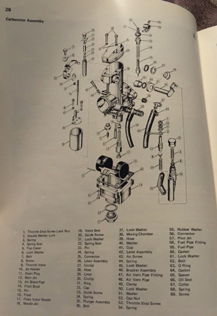

14 Aug 2022 14:50 - 14 Aug 2022 14:51Except for number 4 carb you can't get the other plungers out with the carbs in situ and it's still difficult with the carbs off but still on the backplate.Im contemplating getting the choke plunger seals replaced as the plugs are very sooty despite cleaning the carbs and setting up.
I really dont relish pulling the carbs off again so was wondering if they can be changed with the carbs still in situ.
Also has anyone else had similar with sooty spark plugs and found this to be the cure.
Other than the sooty plugs it runs quite well apart from a slight hesitancy if the throttle is blipped very quickly.
You need to remove the choke bar and lifters and then make a special wrench to undo the 14mm retaining nuts.
For all the messing and time it takes it's quicker to split the carb bank and use the opportunity to give the rest of the assembly a good going over.

- zak900
- Posts: 38
- Thanks: 4
15 Aug 2022 00:05
Thanks for the reply Zed even though it wasnt what I was hoping to hear.
Lots more work than I had hoped plus cost of new airbox rubbers as the current ones are pretty solid and struggled to fit them back on again a few years back.
Is there any other rubber seal on the choke plunger assys apart from on the tip (o ring inside the recess etc) ?
Also is there a rubber boot that sits over the top?
