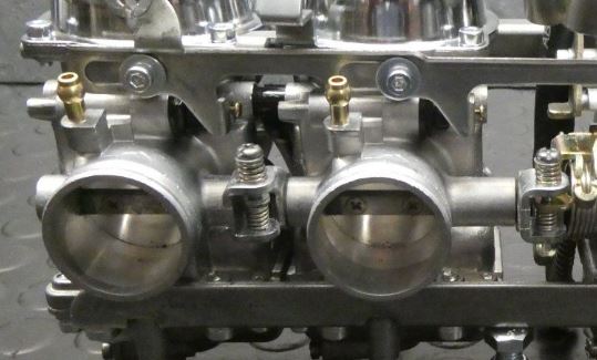

Did you have separate the carb bodys during a rebuild or cleaning?
Looks like a misalignment of the 1-2 and 3-4 sync adjustment mechanism.

I did seperate them, but I have double checked the linkage and they are bench and vacuum synced. I can also bring the revs back down by forcing the 3rd throttle plate down, but that gets a bit hot. When I force the butterflies closed I'm basically pushing against the lower of the two springs in the sync linkage. The Zephyr carbs have a single screw with a second spring instead of a lock nut.

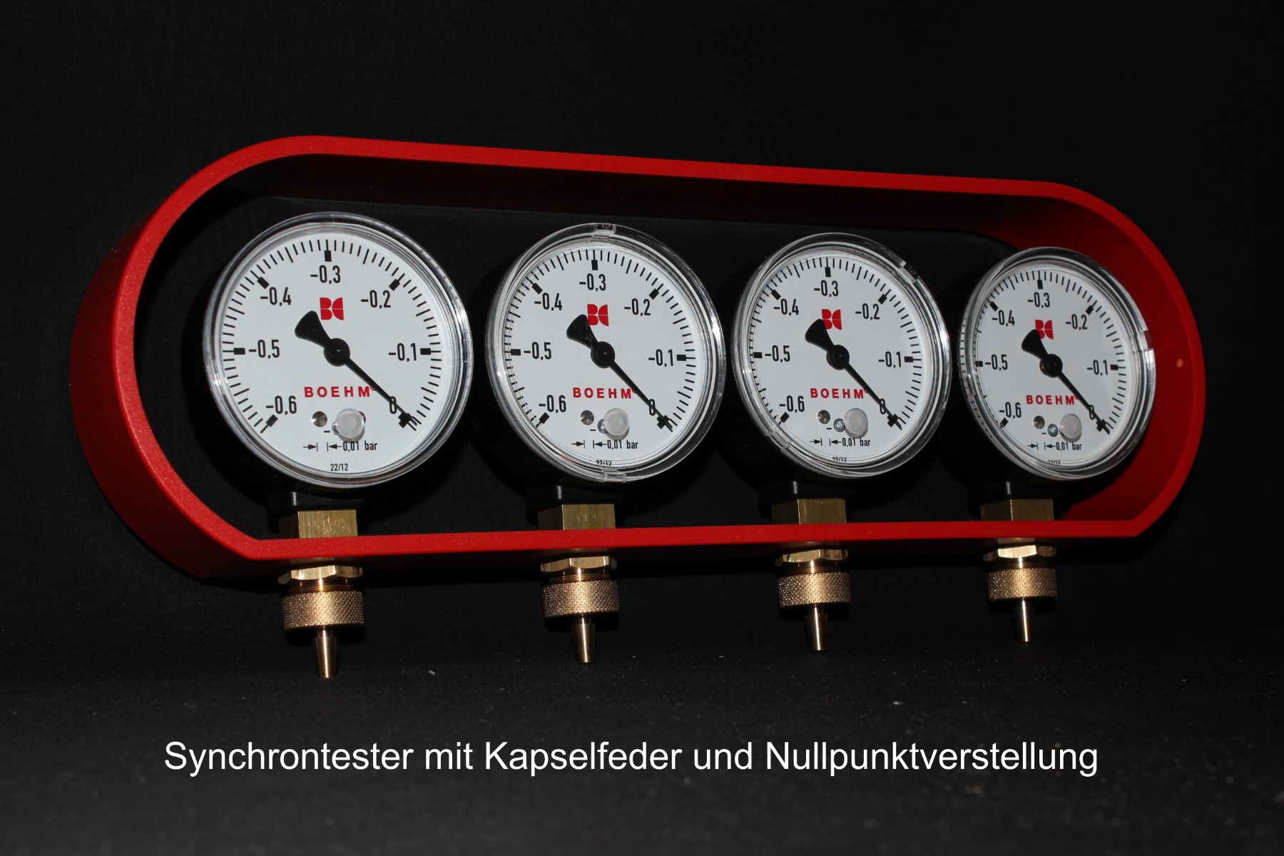

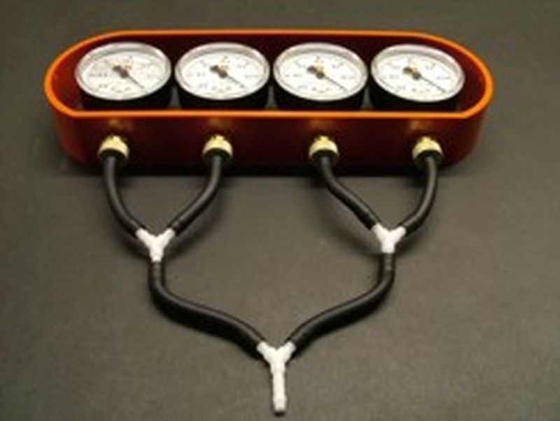

Ok, so did you syc/calibrate all of the vaccum gauges on one vaccum port before you did the carb sync?
Don´t trust cheap china fire cracker tools!
My Beohm sync tool i have to use for more than 25 year. Expencive but best investment ever for ever....

I Have the same gauges and have just recently checked the calibration and then synced my 750H with them. All good on that front.
