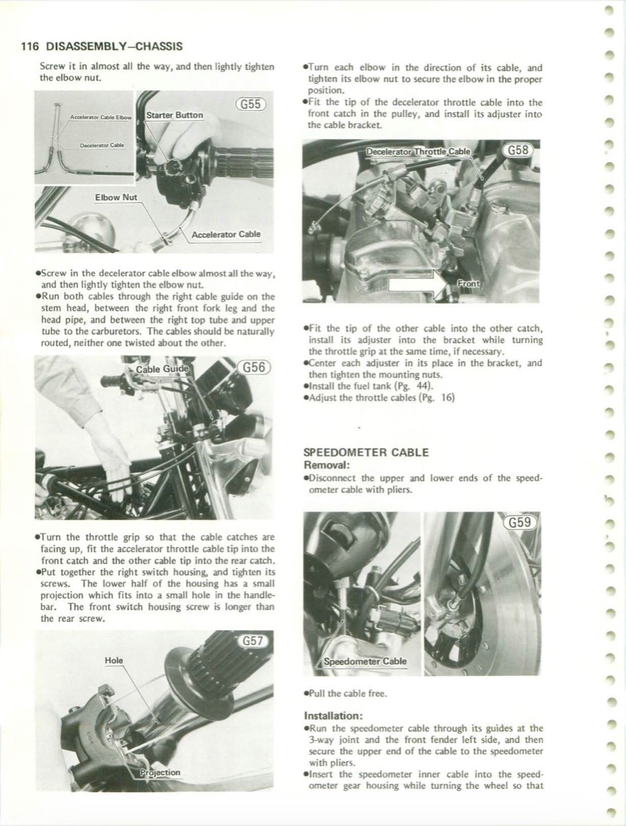

Your not getting much mechanical advantage with the twist grip so with the cables off, lift the throttle cable pulley and feel for smooth full flange operation. If you feel any sticking or it feels sluggish you will need to clean the carbs. To install the cables follow the included
