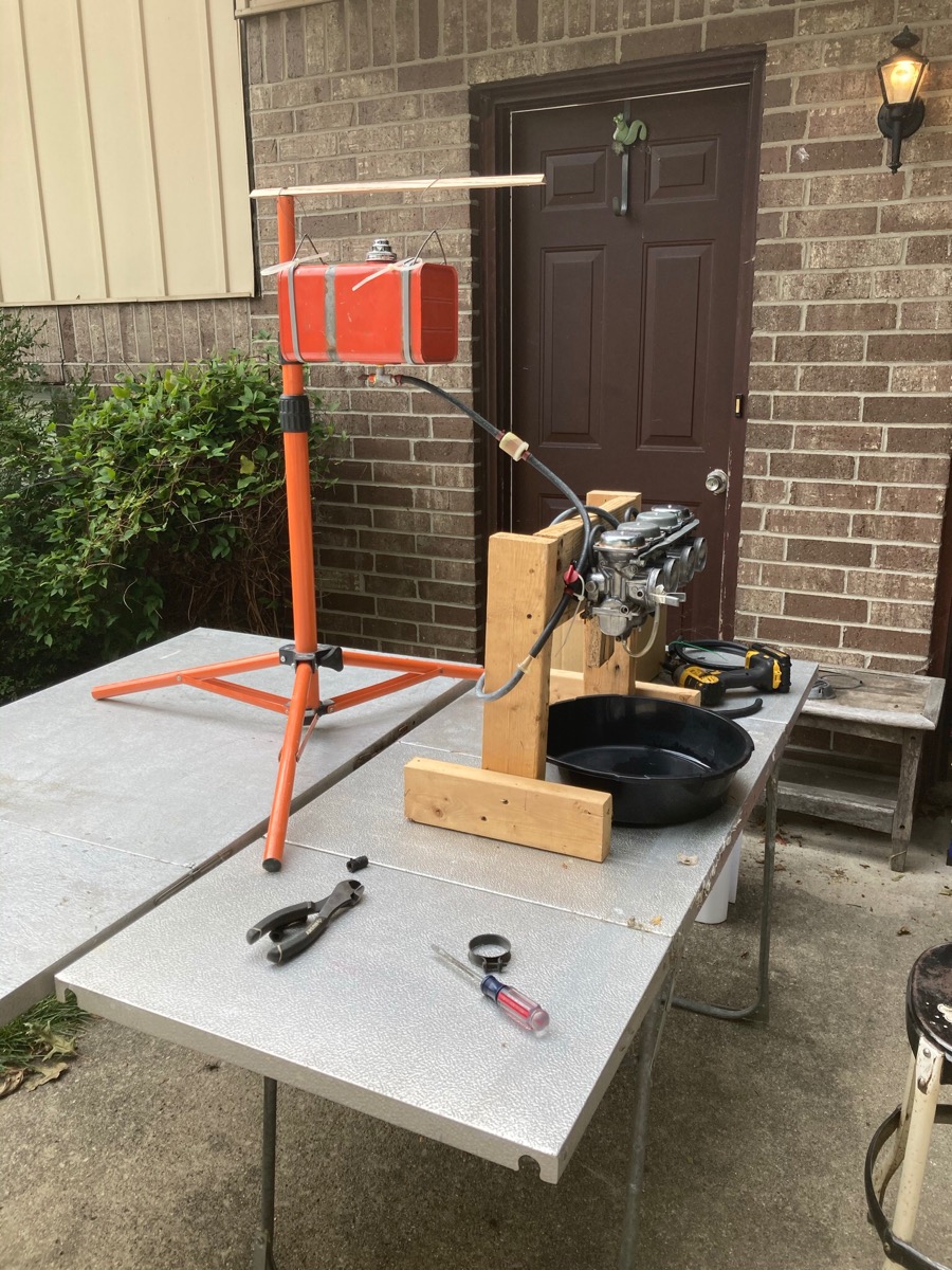

Is there a way to test fuel levels on a bench? Perhaps without buying the special tool the manual suggests?
- Posts: 3112
- Thanks: 1229
Re: Flooding left side carb
21 Nov 2021 12:37Is there a way to test fuel levels on a bench? Perhaps without buying the special tool the manual suggests?
Yes. Read this thread.
www.kzrider.com/forum/forum-index/3-carb...n-setting-fuel-level
- Thanks: 1851
21 Nov 2021 12:47
You can take your carb bowl to your local hardware or auto store and test fit clear hose into the drain screw. I’ve never tried but others say with the correct size you can twist (thread) the clear hose into the bowl. Then set the carbs in a quick homemade stand. Level and plumb them and test the float levels.

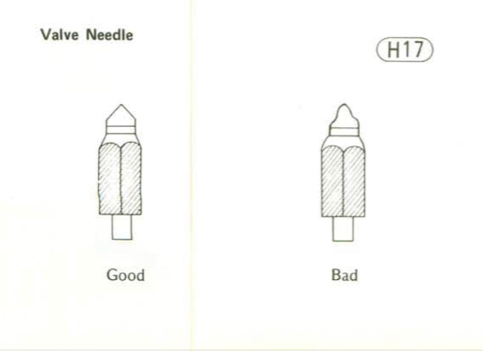

Did you use an OEM Kawasaki float needle?
from Mike Nixon at motorcycleproject
motorcycleproject.com/text/float_valves.html
"As a carburetor rebuild customer there is one thing you need to understand above all else. A thing you have probably never thought about, a thing that has probably never even been on your radar, and yet it is the single most important aspect of your carburetor rebuild. It's more important than the method of cleaning, more important than shipping methods, and believe it or not, even more critical than the experience and reputation of the rebuilder you choose. Float valves. Ninety percent of carburetor rebuilders, including some pretty well known ones, ignore the simple but scandalous fact that the huge glut of available aftermarket float valves from all kinds of sources are absolute crap and will turn even the most skillfully and carefully performed carb rebuild into a disaster. They're simply not well made. And with a carburetor's float system already by design being a tenuous quest for liquid tightness, aftermarket float valves just turn a peaceful but delicate detante into a full-fledged war, guarantying that the customer will have to be constantly vigilent and learn to make allowances and excuses for chronically incontinent carburetors.
Float valves
When I began doing carburetors full-time I tried using aftermarket float valves. They were incredibly bad. I began vacuum-testing brand-new ones right out of the package before installing them. The result was I had to throw more than half of them away. They wouldn't seal. I had to buy ten to get four, at best. And even the ones that sealed initially quit sealing after a short while. Or the valves would fit poorly, too small in diameter or too long, both causing issues. I tested both OEM and aftermarket every day on every rebuild for over a year. I don't test OEM float valves any more. One hundred percent pass the vacuum test. Every single one. Now, the first thing a carburetor customer looks for is fuel-tightness. I'm going to use crap float valve and send him carbs I know are going to leak? Hardly. I can't understand why anyone would use these parts, especially people who rebuild carburetors for a living. And don't forget, these bad float valves are often found in rebuild kits. Between this and the abysmally bad Chinese needle jets and jet needles, carb kits are no bargain. In fact they're death to your carburetors. I won't guarantee carbs that contain them.
Now you know why I rebuild only Honda carburetors. They are the only Big Four brand factory float valves can be got for now. Later Kawasakis used the same brand of carbs as Honda so I do late model Kawasaki carburetors frequently also. But if I can't get factory float valves for a carb set I won't rebuild the carbs. I won't make excuses. That means I don't do older Kawasakis, Yamahas and Suzukis. There are no OEM float valves left for these.
And now, finally, and tragically, even the Honda float valves are drying up. I won't start using crap float valves and making excuses to my customers. What a terrible thing to have to do. Here's the thing, though. Why aren't the rebuilders who use K&L, Keyster, Napco and other float valves making such excuses? Why aren't their customers being warned that the carbs will overflow? It's perplexing to me. Maybe most customers fail to maintain their carbs from one season to the next, and thus they never realize the poor quality parts that are in there, chalking up eventual leaking issues to "it's time to rebuild them again." And it's even more likely most rebuilders just don't care. Too awfull bad, that is."
