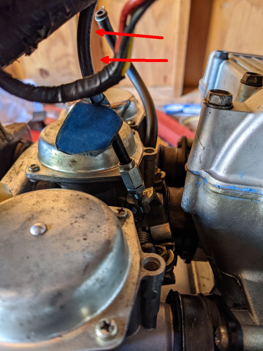

- Jakob
- Posts: 23
Re: Throttle Return Spring
22 Jun 2021 09:07
All right, sorry for being so needy I'm still a newbie, is that cable the push/pull and mine the opposite?
Trying to find one with threads on the other end.
Here's a pic attached.
22 Jun 2021 13:26 - 22 Jun 2021 13:27Your bike/carb/RH throttle is a pull only cable driven. Try to read the part# that is print on. It make the search much easier for all of us.All right, sorry for being so needy I'm still a newbie, is that cable the push/pull and mine the opposite?
Alternative you can buy a slotted adjustment screw.
Last edit: 22 Jun 2021 13:27 by Scirocco.
