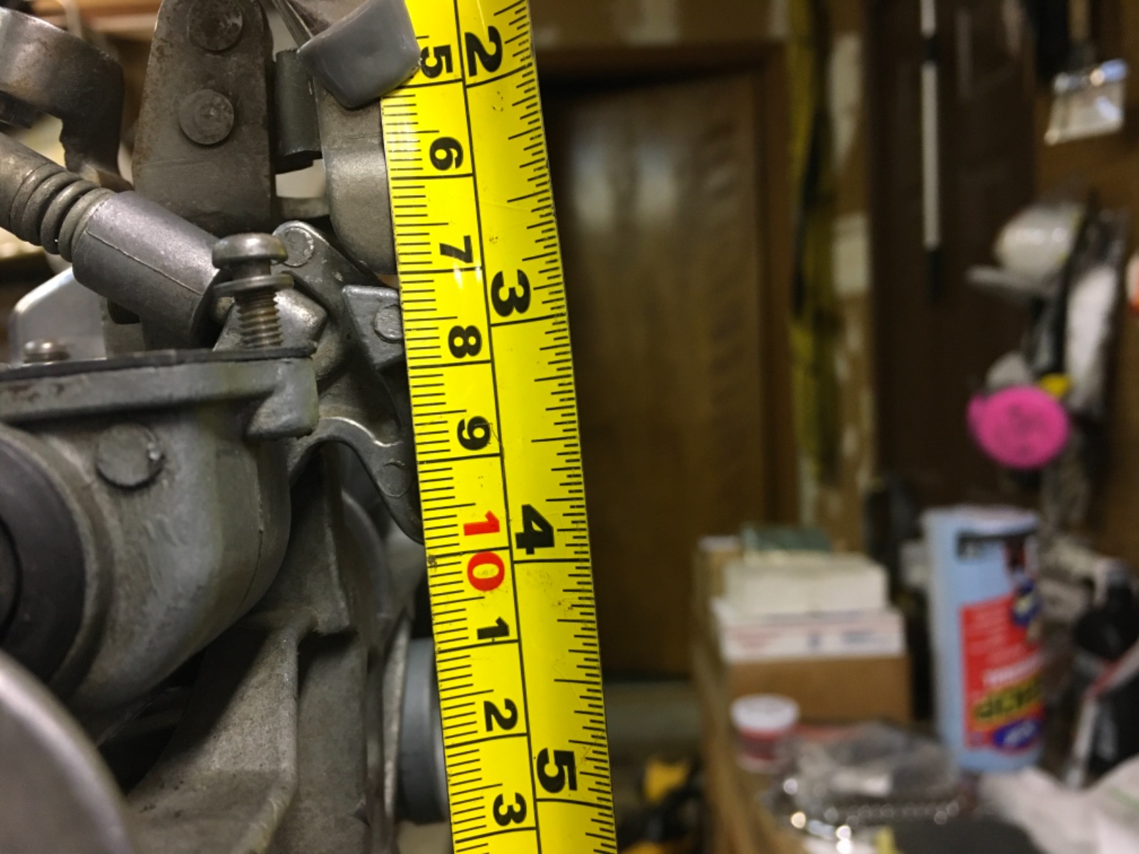

So I’ve got the bike back together after a bunch of work. And it’s running clean except that I’ve got a bit of a hanging idle when blip of throttle or ridiing and of throttle. I’m thinking I bench synced the carbs too far open. I’m gonna go back and re sync. My main question is, if in theory one is too bench sync .5mm-1mm wire with throttle stop screw set centered. Wouldn’t it work the same if your settle the carb slides gently closed with the throttle stop screw are out 3/4 of its position work the same??

My reasoning behind thinking i need to reset my slides lower is that I don’t have any more out adjustment on the throttle stop screw . Which tells me the carbs slides are set too high and/or didn’t set my throttle set screw close
enough to center for adjustment range

Open this manual and read pages 17-19.
www.kzrider.com/modules/ServiceManuals/K...Service%20Manual.pdf
The first step to a bench sync is to adjust the idle adjustment screw to 1.6 to 2.0 mm gap between the throttle pulley and the stop bracket.
