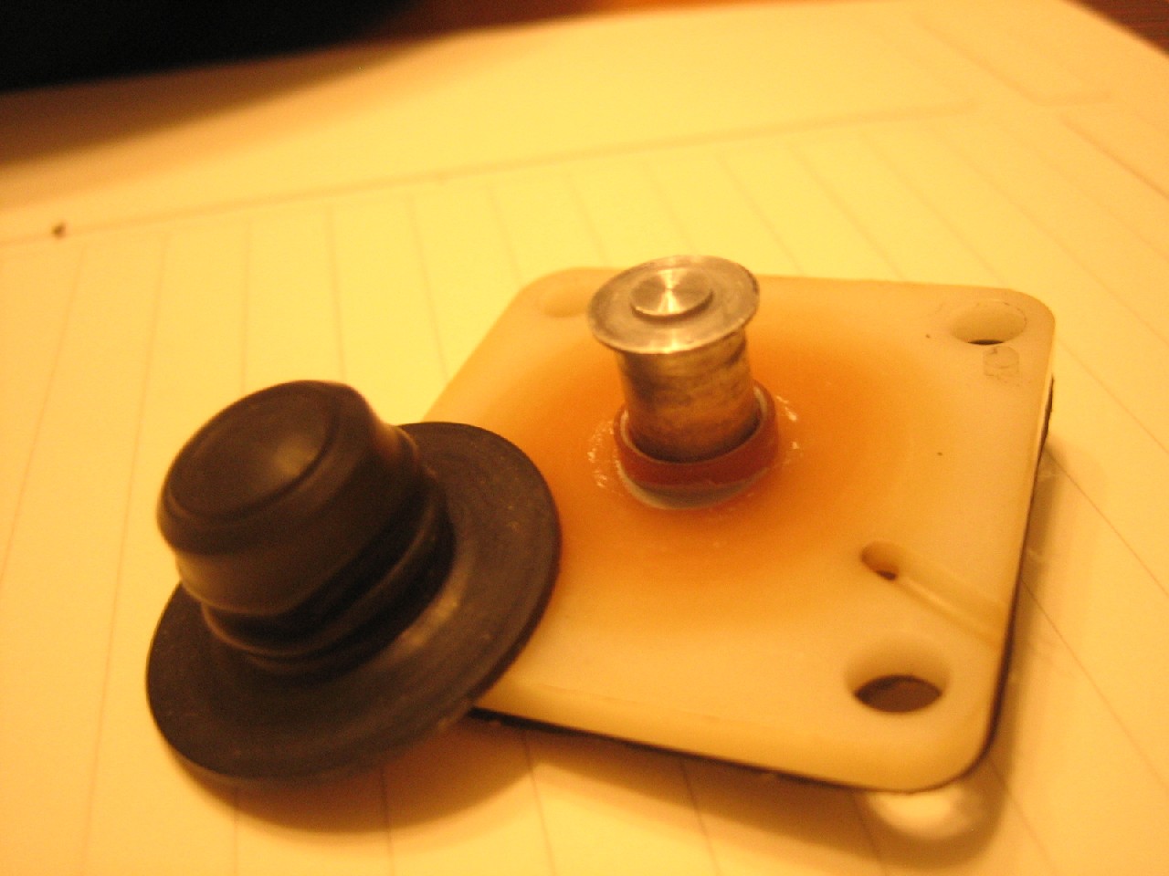

I agree that the pringle is a good item andd does appear to need an o-ring or gasket.  Yes just the earlier manual petcock it does need turned off.
I want to make sure that if you are going to rebuild the vacuum one on the bike make sure you get the right parts.  There are differences between some of them. See below for some pics of them. If you are going to open it up make sure you get the correct parts to rebuild it as they do not mix correctly.

  • Nessism
  • Nessism's Avatar
  • Posts: 7957
  • Thanks: 3329
Re: Normal Cost To Rebuild/Clean Carbs?
27 Mar 2021 19:57
#845638
