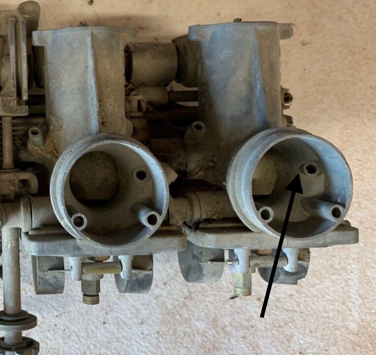

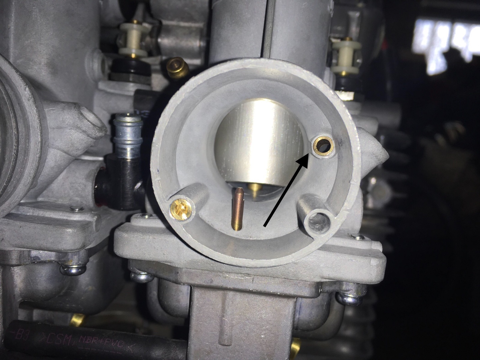

The only thing I can verify is the B1, B2, and B3 1000 Kz came with VM 26 SS carbs. The 1980-B4 came with the VM28 SSmm carbs with accelerator pump. My Eyes see the above posted carburetors as version 26. Compare the included photos of the bore proximity of the [strike]pilot air intake[/strike] orifice
EDIT, I think that is the enrichment air jet. [strike][/strike]
VM26
VM28

Correct me if I'm wrong but don't the VM26 and VM28 carbs use the same carb boots? The PN's seem to be the same. Anyway, the outlet flange thickness seems thinner on the 28's, and the carbs linked earlier have thick flanges so I agree they look like 26's. Makes sense; the LTD bikes are cruisers compared to the more performance oriented STD bikes, so it stands to reason that they would use smaller carbs.
