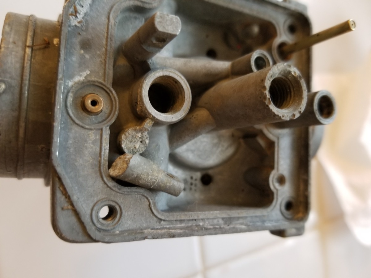

Bought some VM28 pumpers off ebay in June and just got around to working on them...only to find a broken float post in one of the carbs. I'm pissed, both at the seller and at myself for waiting so long to check them out. I've seen lots of busted float posts in BS CV Mikuni's, but this is my first experience with a broken post in a VM. Paypal says there is a 180 day window to initiate a dispute, which I'm very tempted to do, but before going down that road I thought I'd post here to see if anyone has come up with a righteous repair method. I'll be reselling these carbs so the repair must be solid and above reproach. NO JB WELD suggestions please.
The break is near the bottom of the post and after cleaning off some crappy epoxy, the pieces fit together nicely.
BTW, the epoxy bond had failed....thus my refusal to use anything like JB Weld.

Found an old thread where the post was welded. That may be the way to go...

If you are doing it to resell then the laser welding has to be the only real option.

I'm 95% sure that I'm going to send this carb body off for welding. Body is bead blasted nice and clean so hopefully there will be minimum contamination getting into the weld. VM's are made of (pot metal) zinc, so aluminum brazing type repair is a no go. I've tried that stuff before on an attempted (and failed) fin repair job. It's really hard to get all the parts up to proper temperature in order to braze it together. The main part is a heat sink and the tiny fin (or float post in this case) is super easy to over heat.

The dude with the welder charges $35 and has an excellent reputation. I plan to send the carb out tomorrow.
The break is on an angle. It would have to be milled flat and a new post fabricated before drilling and threading the parts together could be contemplated. I suspect it could be done but I doubt it will be as good as the weld repair.

Carb body is on it's way back to me. Seems pretty good. Repair guy didn't want payment until I get the carb in my hands for review. He seems like a real stand up guy. He's called me several times during the process. He takes pride in his work.
