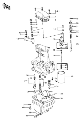

Hello,
I received some good advice on float needles in another recent thread, but there are a few more questions bouncing in my head. First off, this is only my second carb rebuild (first was on a GT750 that went well). I'm reasonably mechanically inclined, but I don't have enough experience to know what is important or not. Anyway, here goes...
Th motorcycle is a 1978 KZ1000-A2. Frame numbers fall in Japan manufacture range here:
www.zedder.com/Info/78%20KZ1000-A2.htm
But, when I look at carb internal parts, the numbers seem to fit the data in the Clymer manual for the 1977 Std. model (A1 I guess). This is what I have on my carbs:
Throttle valve: 1.5
Jet needle: 5CN8 - 3rd grove
Main jet: 110
Float valve: 2.3
That seems to match the 1977 Std. model except the main jets are listed as 107.5 (close).
(I have an A2A service manual too, and the specs on carb parts there match Clymer for 1978-1/2, very upper-right in the table.)
I read on another thread that the numbers stamped on the carbs below the choke lever can help identify sub-model and year, but I haven't found a resource that helps identify what I have:
299
02
OK, the questions:
1. Do I have an A2 bike with A1 carbs? Are these not the original carbs, or is it possible that they are original and some A1 parts made it into my A2? This is mostly curiosity, except in may influence how I rebuild.
2. What main jets should I have in there? There are old 110s in now from when I bought it. I also have aftermarket sets of 105s and 102s. 105 is the size Clymer gives for the A2. I don't have the stock size for the A1 (107.5s). Should I buy 107.5s or use something I have? BTW... What do these numbers mean? I'm sure they have something to do with the size or shape of the jet hole, but is bigger number = bigger hole? How sensitive is change in next size up/down on motorcycle performance?
3. When I first took these carbs out 2 years ago (motorcycle not running well since), I did not note the setting on the piolet screw. I have since learned that this is important and the nominal setting is about 1-1/4 turns out. Should this go smoothly if I roll with that, or am I in for trouble? What should I know to sort this out? Also, should I:
- Use old Mikuni pilot screws, little worn, I don't know which came out of which carb
- Use new aftermarket screws (which I have)
- Buy new Mikuni pilot screws?
(Like I said... I don't know what's important.)
4. Anything else I really need to know?
Thanks for your help, and bearing with all my questions,
Tristan

Give all carb parts a good clean, check/set the float level, check/adjust the static carb sync, replace the old and brittle seals and fuel tees and get the bike running. 110 main jets are a good starting Point to fine tune the carbs later. The numbers on the main jets are not the bore ID, the number describe the flow rate.

It's impossible at this point to know what version of carbs are on your bike. The A2 model used VM26SS carbs with 15 pilots, 105 mains, 5DL31 needles and O5 needle jets. The A1 model used the same carbs with 17.5 pilots, 107.5 mains, 5CN8 needles and O6 needle jets. Both years used 1.5 mm cutaway. (In '79 they went to 2.5.) You say yours have 5CN8 needles, which suggests A1 version, but that's not definitive by a long shot. The carbs may have been switched at some point, or A1 needles may have been installed to richen things up a bit. Or it may have been a set of '77 carbs left over at the start of the new bike season. Hard to say unless you have the complete bike history.
Kawasaki went through some hoops between '73 and '79 as they attempted to comply with tighter emissions levels. To meet new regs they made a number of mods, mostly downsizing the pilots, mains and needle jets. The poorest version of the VM26 carbs was '78, although the carb bodies were essentially the same as '76 and '77. But the internals were different.
Hardly anyone changes the needle jets during a rebuild, so you can get a pretty solid idea of your carb year by popping a needle jet. If it's an O6, matched with a 5CN8 needle then I would be confident that you have the '77 version. If it's an O5, then I would suspect someone changed the needles on an A2 version at some point. Likely to try to get more fuel into the engine.
My opinion (not shared by everyone) is that a carb rebuild should replace the needles and needle jets because they go oval from wearing against each other as the throttle opens and closes. I would not bother changing pilots or mains that look clean, except when re-sizing them due to other mods. I would also change any non-metal parts, like gaskets, O-rings, etc.
If your bike has stock air intake and stock exhaust I would suggest going back to standard specs for an A2 or A1 bike. If I wanted to go with stacks or header or both....I would consult zed1015 on how to properly jet my carbs.
Do your carbs have pilot screws on the bottom at the manifold side? I think you said they have fuel/air screws. I can't remember what the '78 version used, but I believe the '77 version had pilot screws underneath and not fuel/air screws. Memory is poor though.
Edited to add...to remove a needle jet...remove the bowl, float mechanism, main jet & diffuser, carb top & slide mechanism. Looking down from the top you can see the needle jet. Drop a wooden dowel down on top of the jet and tap gently on the other end with a small hammer. The jet should pop out the main jet tunnel. If you check carefully you will see the jet number scribed on the side.

A2 carbs will have a brass vacuum take off stub on number three carb for vacuum operated petcock, so if they are, numbers 1, 3 and 4 will have stubs 1 and 4 are breathers and 3 the vacuum, A2a carbs will have an accelerator pump system on them, A1 carbs will not have vacuum stubs, pictures of the rear and underneath of your carbs will help us make a better identification.

There is no brass stub on #3 for petcock vacuum. There are brass stubs on #2 and #4 for breathers. Here is the rear.
And here is underneath.
I'm not sure from your comment if A1 has no stubs "at all," but there is nothing for petcock vacuum and the 2 present were previously breathers.
Everything else I see is consistent with A1, except for the main jet, which is 110, closer to A1 (107.5) than A2 (105). Also, P/N's 42, 43, 44, and 45 below are identified for "late 1977 on" in Clymer. Mine does not have them.
This leaves me with one question at this point... The petcock is vacuum activated, and I scratched my head for a second trying to remember where that comes from, because it has not been assembled in a while. It must be that the petcock vacuum hose is attached to the port on the bottom of the rubber "holder" between carb #2 and the engine, P/N 28 in the image below. It has been missing the rubber plug, and I forgot why. Is the a common/acceptable way to draw vacuum to operate the petcock?

kevski,
