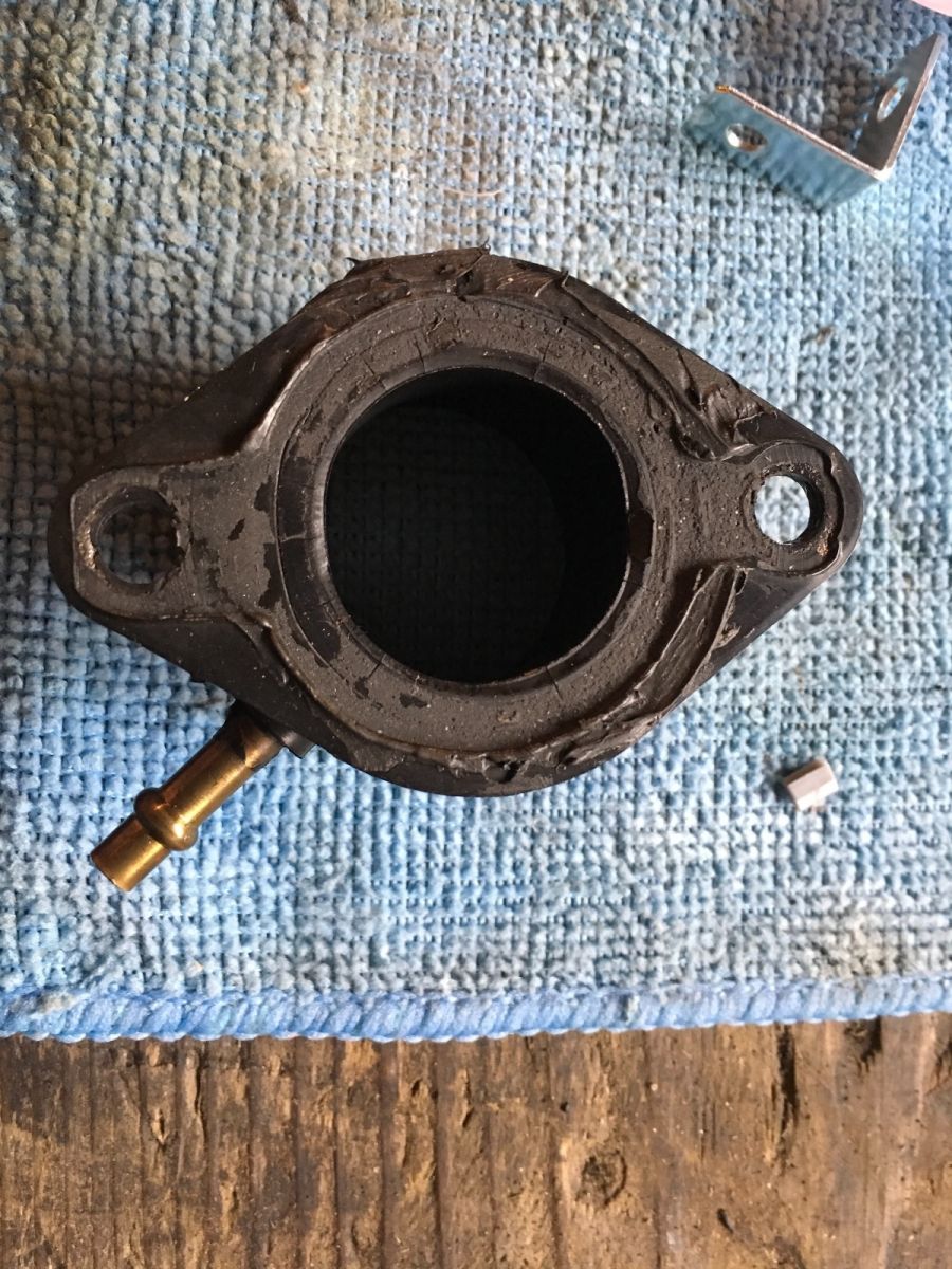

Hi Mitch. Welcome to the forum. I agree with Zed1015, I chased a similar issue on a ‘78 1000 Ltd... turned out to be the rubber manifolds. You don’t need to spend big bucks on NOS OEM, but don’t go to the $40 sets off evilbay either... get them from a good vender. RedLine Cycle, Z-power UK, a quality set should run in the $70 to $80 range... makes a huge difference and hopefully is a low dollar investment that will solve your problem.

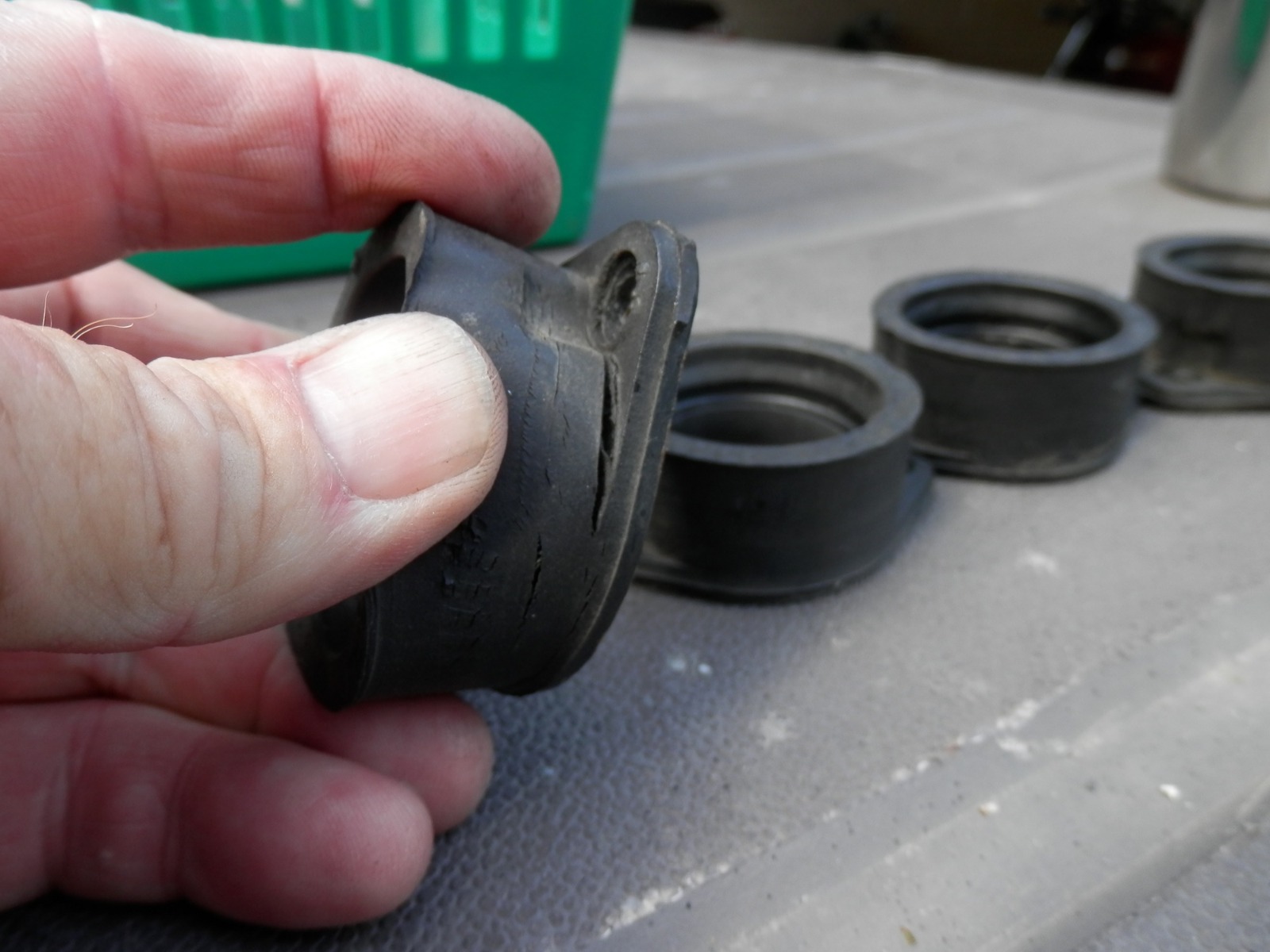

Spit back through carb when warming up and at low rpm on my 750 was caused by cracks in these thingies
Not always obvious but easy to spot if checked carefully.
They dont last forever. I have replaced them twice in 17 years
