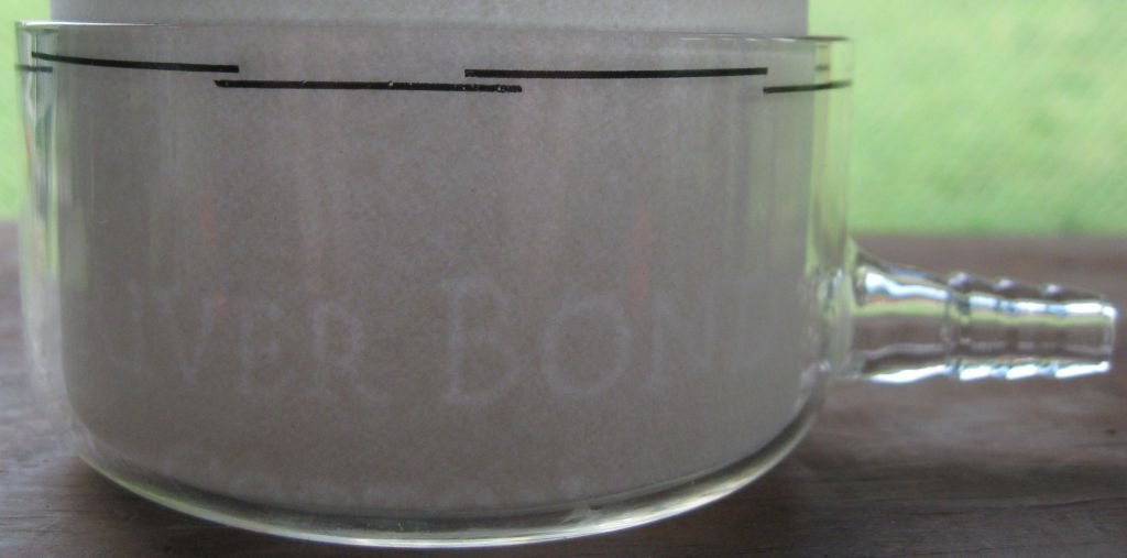

As noted, we engaged the expertise of a custom glassblower that specializes in laboratory glassware to make some glass vessels specifically for setting Z1 3mm float height. Other dimensions and calibrations would be possible.
We desired something more elegant and convenient than the shallow bar-glass prototype with the glass-cutter-etched 3mm line in this OP.
We tested about a half-dozen iterations, wherein they made Pyrex vessels with very thin (0.3mm ~ 0.5mm), ceramic, colored calibration lines permanently fired onto the glass, precisely 3mm from the top edge. We tested solid lines, dashed lines, red, green and black, lines spaced in 1mm increments either side of 3mm. This was not an inexpensive project.
Glass vessels are surprisingly difficult to photograph. We only very recently found some detailed info on doing so without unwanted artifacts. We'll add photos of the different iterations of line colors, spacing & solid vs dashed as we get pics worthy of posting.

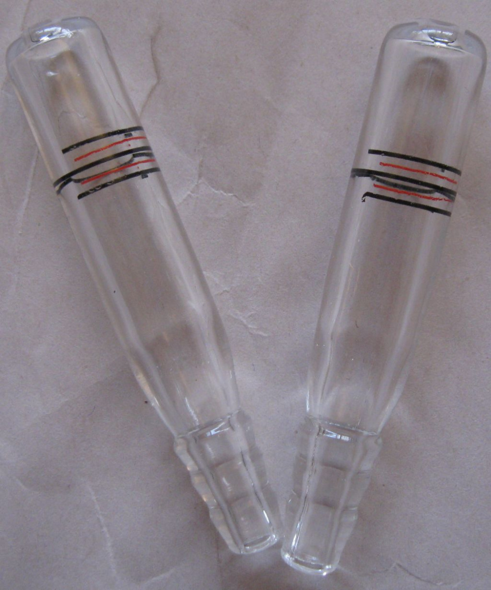

As a lark, we asked the glassblower to made a few short, calibrated tubes, similar to the float height tool with calibrated lines that Mama Kaw offered as a special tool in the day. We'll post pics when we get some good ones.

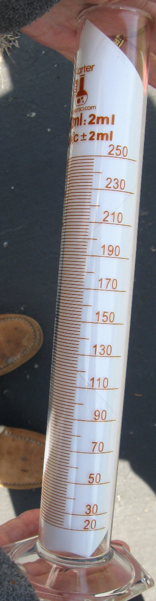

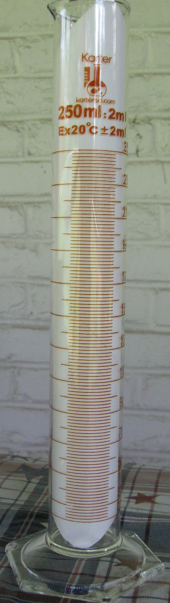

We bought a good lab-grade fluid hydrometer with a range of 0.70 to 0.81, and a tall enough graduated flask to float the hydrometer, to test specific gravity (SG) of fluids. See OP, our earlier updates, and helpful contributions from other KZR members for more details on SG.
The hydrometer:
Graduated flask:
About 15 in. base-to-top It doesn’t hold much volume, but is tall enough & just large enough in dia. to allow the hydrometer to float freely near the top of its scale. The graduations on the flask weren’t needed, as fluid level exceeded the topmost graduations using some fluids anyway, and we don't care about precise volume for this project. We inserted a sheet of paper into it only to contrast the graduations.
We tested SG of many common fluids one might have in the household and shop. Many were entirely off the scale of the hydrometer or, far below the necessary range of gasoline to be useful, . None matched gasoline, so were of no interest.
SG of pure gasoline ranges ranges from 0.71 to 0.77. It measures 0.731 on our hydrometer @ 15 deg. C.

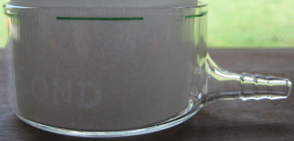

A cup with drain barb that has green, dashed, offset calibration lines at 3mm and 4mm was commissioned from the glassblower. We spec’d the cup with dashed green calibration lines this time, as black is difficult to see against the fluid meniscus under some shop lighting conditions. The 1mm vertical offsets help with accuracy. This image shows a sheet of white plastic sheet foam inserted for contrast:

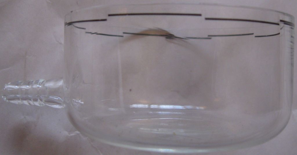

Other different prototype cups we tried are seen below. A few more are in our earlier updates. Clear glass is tricky to photograph, so the image of the black dashed lines is confusing, as the foreground dashes are at the top, with the lower dashes in the background visible (although somewhat distorted) thorough the glass, but lack visual depth:
Red lines would be preferable, but the glass shop doesn’t stock it, and they have to buy ceramic line decals of any color in expensive quantities. We looked into buying some ourselves, but the stuff truly is cost prohibitive. The green, offset 2mm / 3mm dashed-line cup has become by far our favorite.
Using FICF, we set a rack of carbs to 3mm ~ 3.5 mm below the edge of the carb bodies. We then tested with E10 (outdoors) to evaluate accuracy. We chose to use E10 this time because it’s by far the most common in out area. Formulation of E10 varies twice yearly here. We used fresh winter blend E10. We'll test with summer E10 when it's available.
There was no discernible difference between winter blend E10 and FICF within the resolution of the green dashed calibration lines.

The experimental short, graduated clear glass tube, rough prototypes we commissioned. A hose barb at one end, a small drain hole at the other.
These work identically to Mama Kaw’s hard plastic, graduated tube that was part of the OEM Z1 float tools. Maybe useful for a quick & dirty fuel level test with carbs mounted on the bike, but simple clear tubing of appropriate ID would work just as well. The glassblower shop had a tiny quantity of thin, red ceramic solid-line decal they used for these. We’d prefer the red lines to be thicker. Again, background lines visible through the glass look confusing, because the pic lacks depth.
The hydrometer:
Graduated flask:
