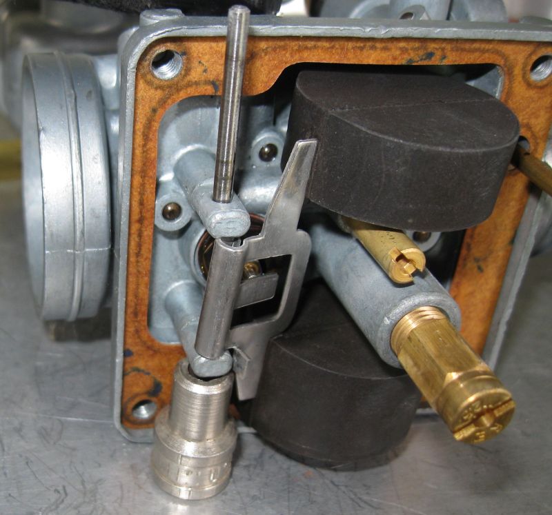

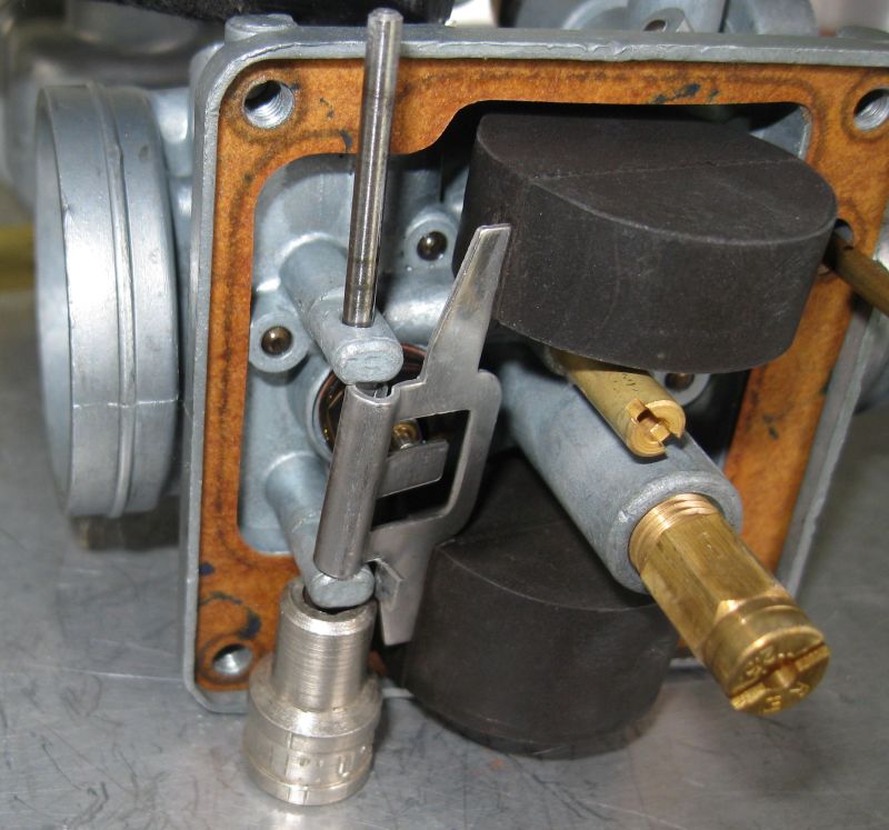

Float adjustment on many motorcycle carburetors is done by physically measuring the distance from a common reference point, such as the float bowl gasket surface of the carb body, to the bottom of the float bulb(s) with the carb body in a particular orientation. This sets what we'll call the physical float level. Another method of float adjustment is often referred to as the clear tube, or wet method. The wet method sets actual fuel level, not the physical float level. Setting physical float level can result in fuel level being incorrect in some instances if the float is misshapen or otherwise not perfect.

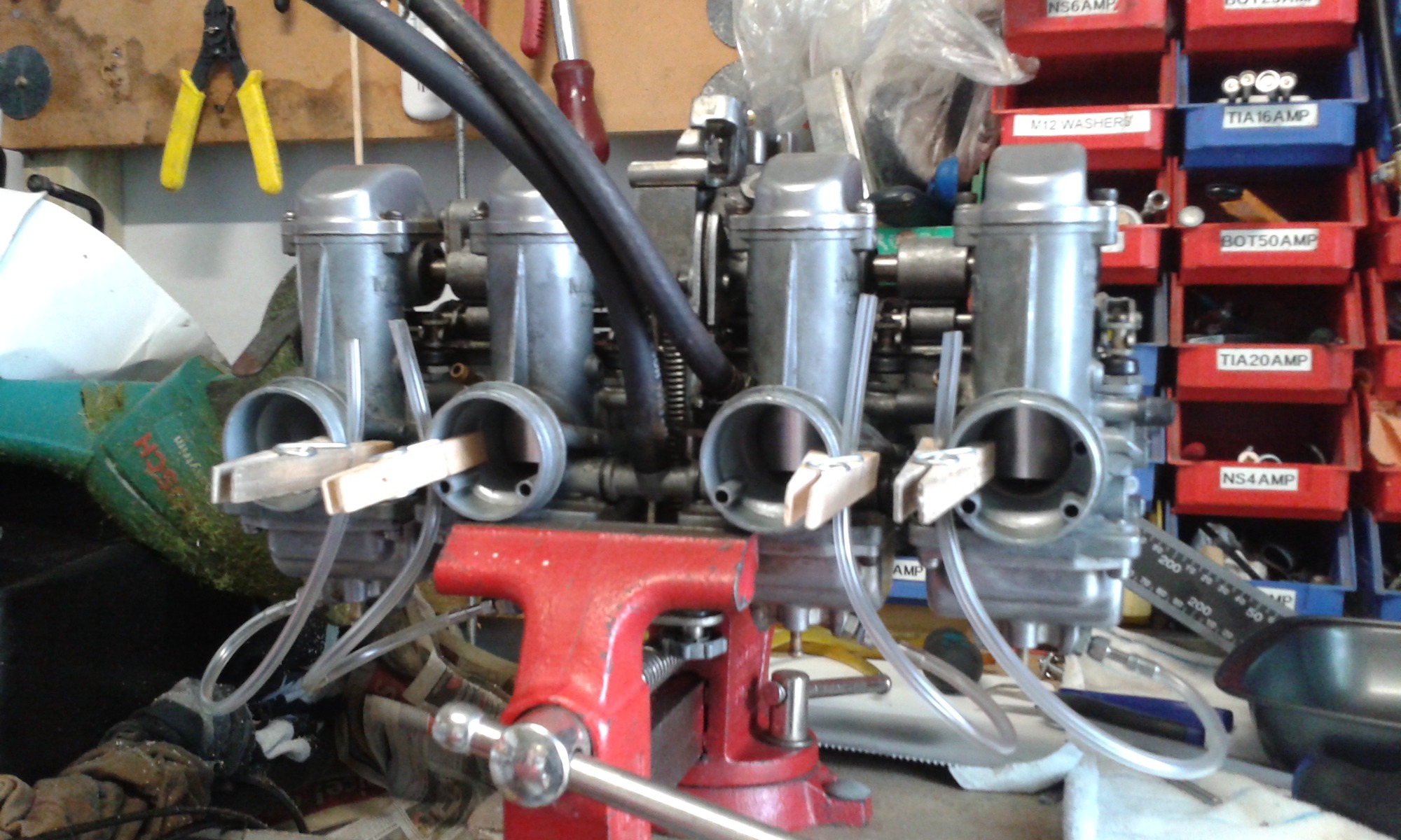

In this article we're going to explore a variation of the clear tube, or wet method of setting carburetor floats. We, the authors, cannot lay claim to this alternate wet method. slmjim saw it described long ago, either in print or online. We merely present it here in hopes our experiments might benefit other DIY Riders.

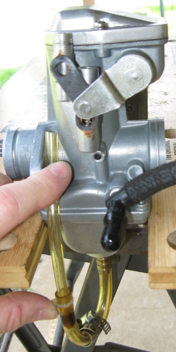

The wet method has historically involved attaching a clear tube tool to a carburetor float bowl drain in such a way that the actual fuel level in the float bowl can be observed externally. The wet method is specified in the OEM Kawasaki White Manual for Z1's. We focus exclusively on Z1's for our vintage bike affliction, so we will use Z1 carbs as examples.
Kawasaki offered two, very different, clear tube special tools for the Mikuni VM28SC carburetors on Z1's, because two variations of the VM28SC's were installed during the 3 year production run of Z1's, with each variation utilizing very different float bowls. Those OEM tools have been difficult to find for a long time, and are expensive if located. When using the Kawasaki factory fuel level clear tube tool, if the float needed adjustment, the float bowl screws would have to be removed along with the float bowl, then the float pivot pin removed, freeing the float itself. The float tang could then be adjusted ( formed* ) slightly, the float reinstalled, the float bowl and screws reinstalled then test again with the clear tube tool. If the float level was still wrong, the float bowl screws, float bowl, pivot pin and float would need to be removed once again, tang adjusted, float/bowl/screws reinstalled and fuel level observed again in the clear tube. Tang adjustments are very tiny. Moving the tang just a few thousandths will produce a relatively large change in fuel level. It's sort of a learned art.
Repeat as needed.
For four carbs.
Tedious? Indeed...

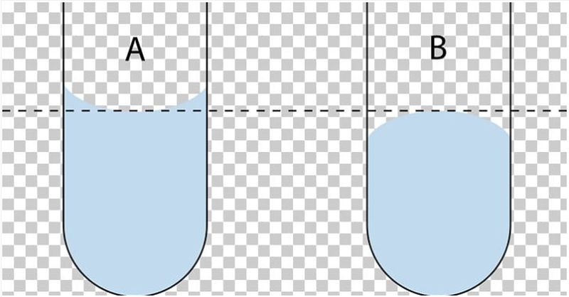

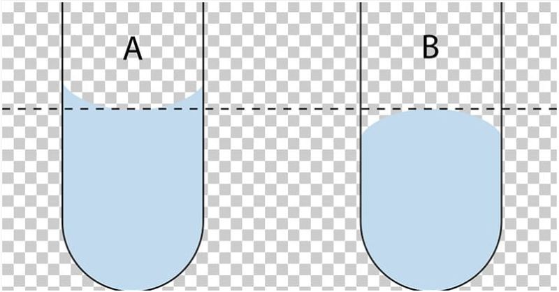

Before we get into the particulars, we must first revisit our high school chemistry class 101. The term we are looking at is meniscus.
A meniscus is a curve in the surface of a molecular substance (in our case liquid fuel) when it touches another material. With water as a common example as well as fuel, you can think of it as when water sticks to the inside of a glass. A concave meniscus occurs when the molecules of the liquid are more strongly attracted to the container (adhesion) than to each other (cohesion), causing the liquid to climb the walls of the container.
Fuel forms a concave meniscus. See illustration.
For our purposes, we are only interested in the example of a concave meniscus on the left, labeled as ' A '.
' A ' is an example of a concave meniscus in a small vertical tube, wherein the true level of the fluid is at the bottom of the curve at the dashed line; the liquid meniscus that has climbed up the sides of the tube due to surface tension is to be ignored. In a large enough vessel, the meniscus will only be present where the fluid is in contact with the walls of the containing vessel. The remainder of the liquid surface starting at a very short distance (1mm ~ 2mm) from the inner wall of the vessel will essentially be flat. Later in this article we'll be referring to this large, flat liquid surface as the flat fuel level.
When observing fuel level in a clear tube tool, care must be taken to read the fuel level at the bottom of the concave meniscus. That can be difficult depending on lighting and viewing angle. Fuel dye could help. Too, if the inner diameter of the tube is too small, surface tension can cause the meniscus to creep up the wall of the tube far above the actual fuel level, thereby creating an equally large error in the perceived fuel level.

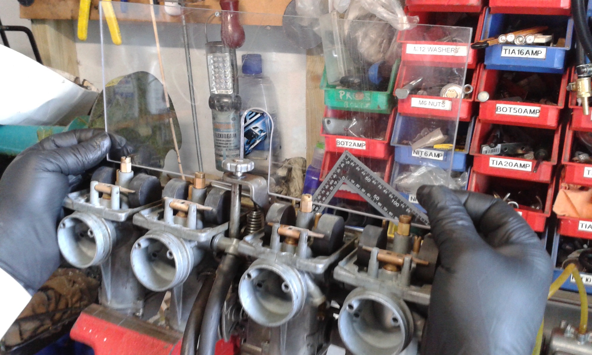

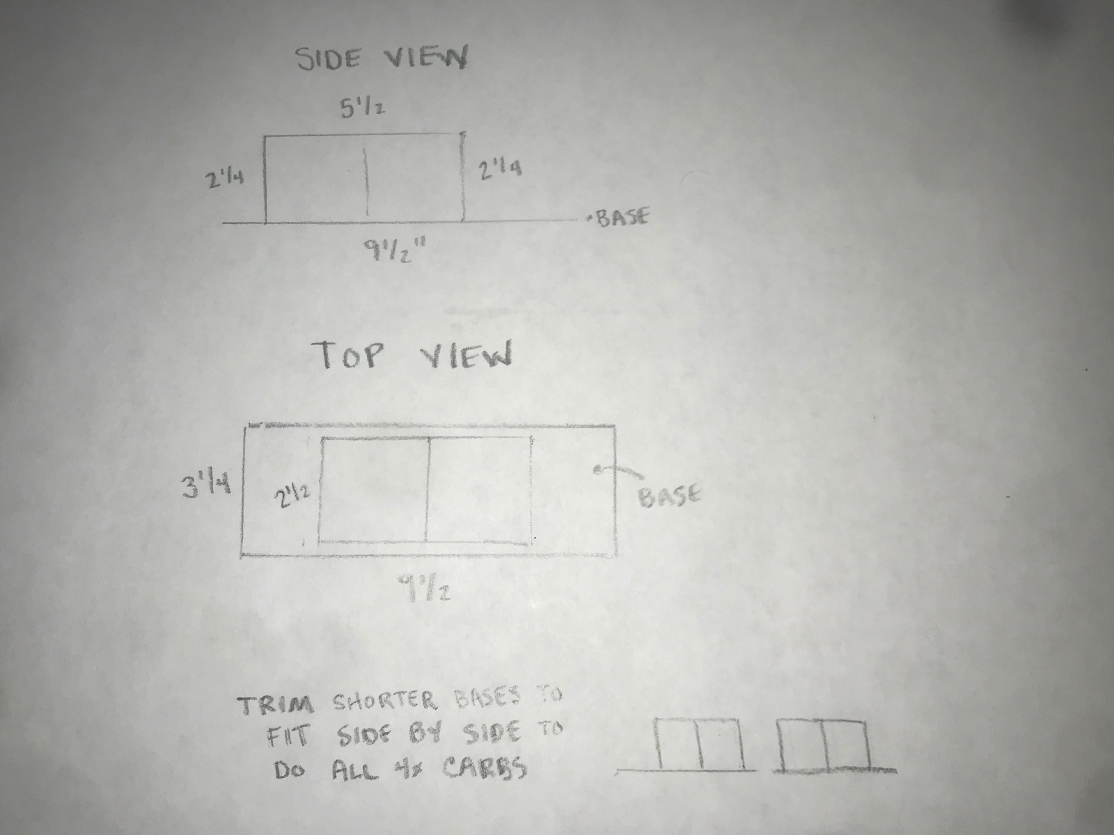

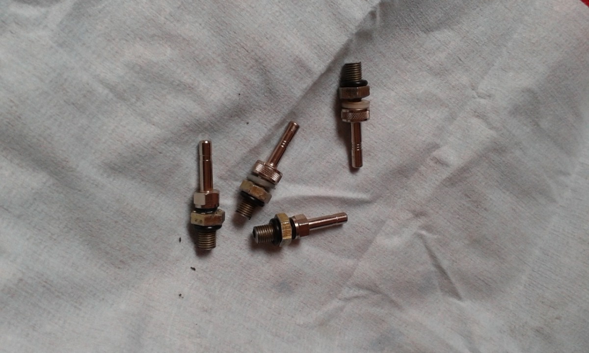

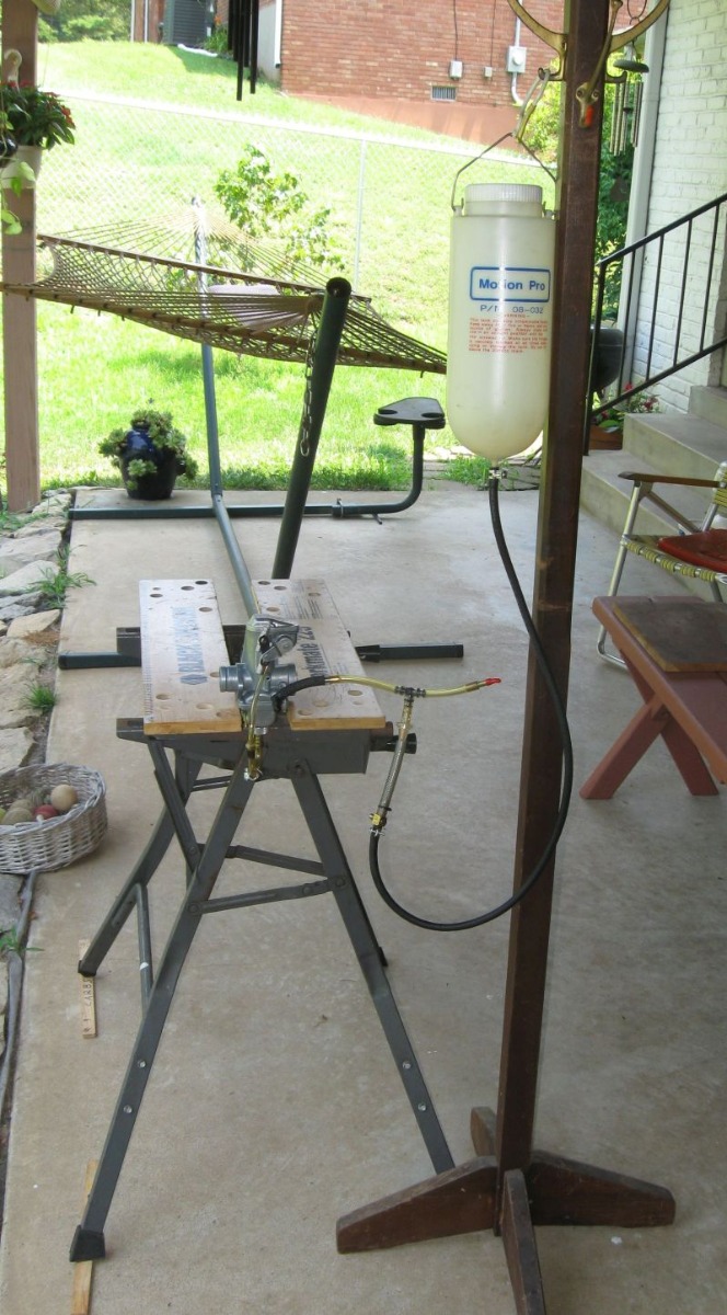

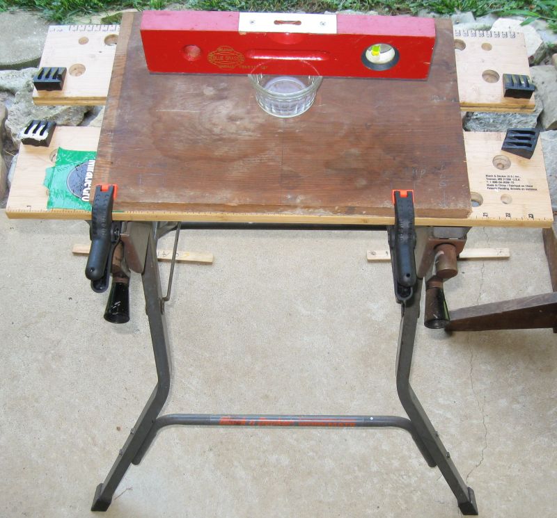

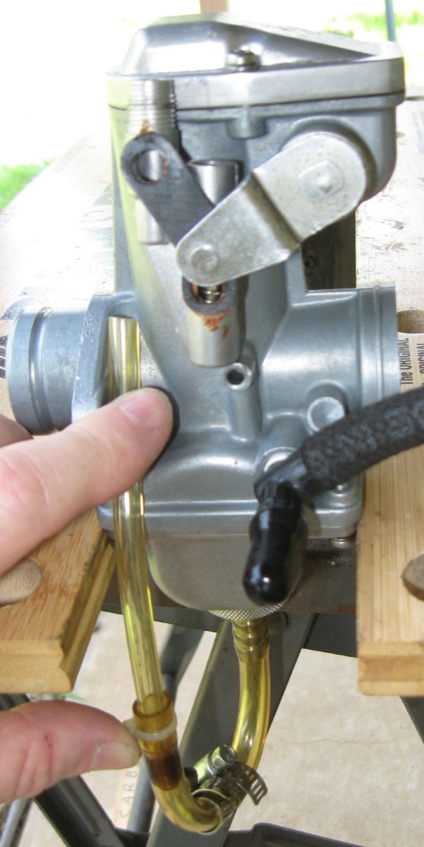

Our test setup consists of an external fuel tank, a fuel ' T ' with one outlet blocked, and a level surface on which to mount a carburetor and/or flat, level surface for a glass cup (test vessel) to observe fuel level. Here it is shown with a single carb clamped for easier use of a clear tube tool. Table is an old, first gen. Black & Decker WorkMate portable work table. Vintage coat rack/aux. fuel tank hanger courtesy Goodwill.:
The two halves of the WorkMate act as a vise, and can be easily separated and adjusted to clamp a single carburetor gently, level and securely as seen here. The table can also hold a board to use as a flat work surface for the glass cup test vessel described later. We also place shims under two legs to account for pitch of the patio floor. While carbs often are not bubble-level when mounted to a bike engine, we feel good leveling is necessary for reproduceability.
Now on to the experimental wet method that is the main subject of this article.

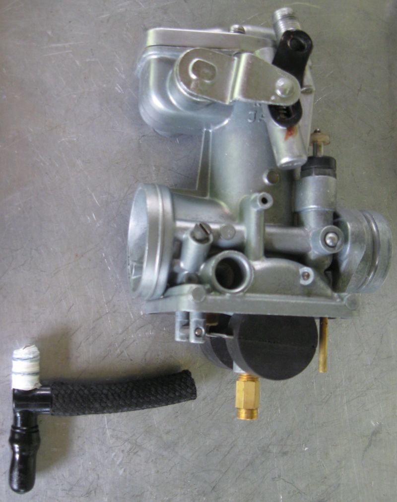

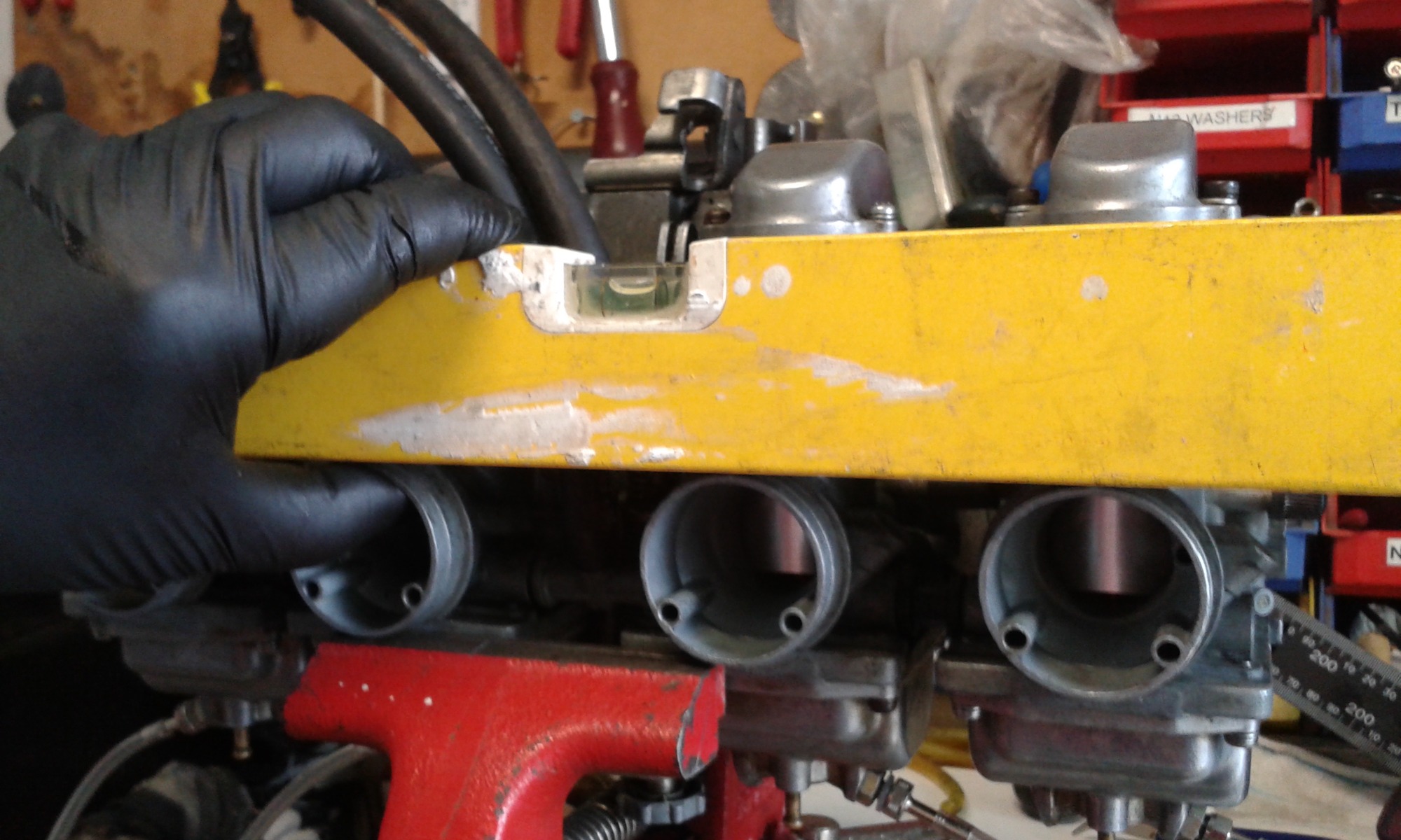

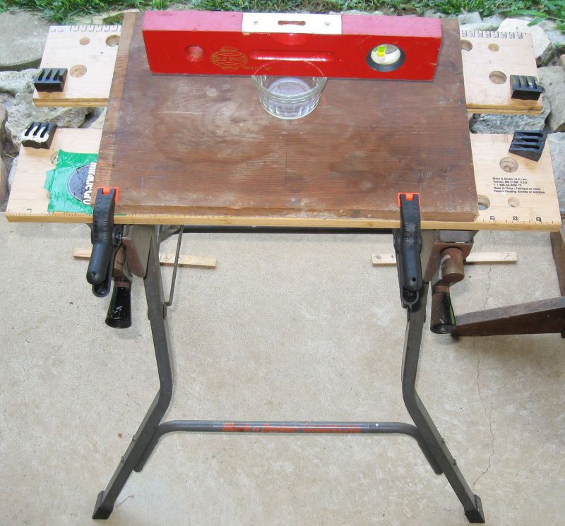

Here we see the WorkMate with the flat work surface board clamped in place, along with the glass test vessel (glass cup). For you eagle eyes, make no mistake; the Miracle-Gro box top is a Über-precise shim for precision leveling :silly: . More on the glass cup shortly:
Carb with fuel ' T ', one outlet capped. Teflon plumbing wrap enables an old, time-and-ethanol-shrunken ' T ' to be used without leaks.:

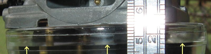

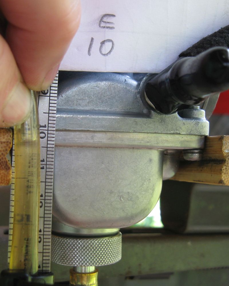

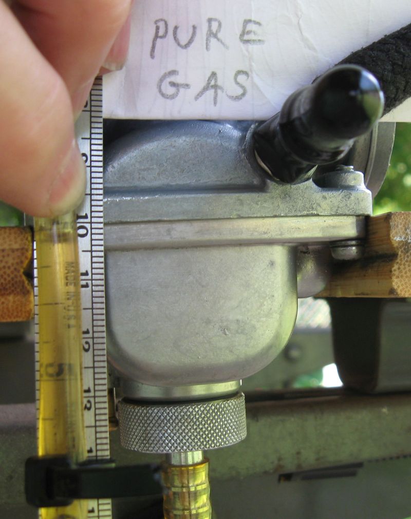

Our first set of tests are to establish a baseline. Slmjim ( Z1BEBE..., not so much ) has been curious for years as to whether there is a difference in fuel level between pure gasoline and E10 (10% ethanol) fuel. These baseline tests are done using the old Kawasaki OEM clear tube adapter that screws into the 17mm drain plug / main jet cover at the bottom of the float bowl that was only used on Z1 and early Z1-A carburetors. Late Z1-A and all Z1-B carbs used an entirely different float bowl and clear tube tool. A Z1-B-style clear tube tool can be easily and inexpensively mimicked as described at the end of this article for use on many other carbs.
The OEM tool is seen here empty prior to turning on the tap but held in viewing position. The two small hose clamps seen at the bottom of the clear tubing are simply there to keep the tubing from kinking at the bend; they serve no other purpose.:

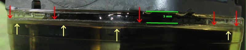

Here we see fuel level using pure gasoline. The level appears to be ~3mm below the edge of the carb body, which meets calculated spec. Note that it's a little difficult to discern where the meniscus ends at the bottom of the concave.:
And here we see the same carb with E10 fuel. Concave bottom slightly more defined. Function of the ethanol content..?:
Considering the 0.5mm error in the position of the mm scale re: the edge of the carb body between the two pics, the fuel level of E10 appears to be ~1mm lower than that of pure gasoline. That helps reinforce the observation of slightly lean running behavior observed on the bike these carbs came from. The lower the fuel level, the leaner the mix. While 1mm doesn't sound like much, we'll see shortly that there is very little wiggle room in the spec of Z1 carb fuel level.
So, there apparently is a small but perceptible difference of fuel level, pure gasoline vs. E10 fuel. Which is correct? Well..., both. Because E10 fuel is so ubiquitous in our region, we used E10 fuel for the remainder of this experiment.

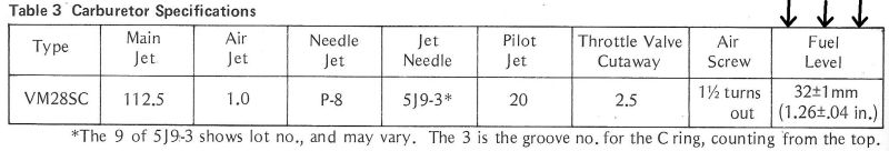

In the OEM Kawasaki White Manual for Z1's there is a specification in Table 3 for fuel level of the Mikuni VM28SC carburetors. It is given in a table as 32 millimeters +/- 1 mm or, 1.26 inch +/- 0.040 (40 thousandths):
That specification confounded us for years until it was finally realized the spec was describing the fuel level as the distance below the centerline of the venturi bore to the flat fuel level in the float bowl. See White Manual illustration #273 below. The added arrows and text for HORIZONTAL BORE CENTERLINE, FUEL LEVEL IN CLEAR TUBE, and 32MM ( flat fuel level position below centerline ) are ours for clarification:
Notice that when measuring 32mm below the venturi bore, it falls somewhat above (not to scale) the level indicated in the illustration of fuel level in the clear tube, which shows fuel level being at the shoulder of the float bowl. The shoulder of the float bowl is slightly beyond the lower level of the range specified in Table 3. Many (including us) have been frustrated by performance problems when setting fuel level to the edge of that shoulder as illustrated due to lean running on the needle jet.

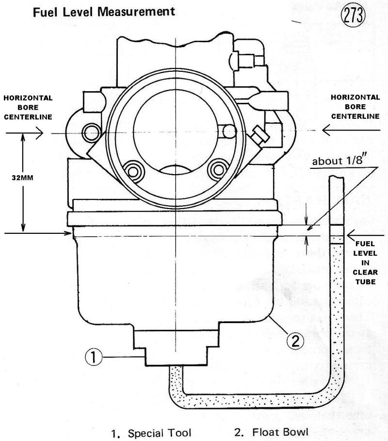

Elsewhere in the White Manual, Mama Kaw specifies a fuel level of “ 'about' 1/8 inch, or 2.5mm ~ 4.5mm below the edge of the carb body”. That seemingly tiny range can result in surprisingly wide variations of richer-to-leaner running while on the needle jet and at the transition from pilot jet to needle jet at small throttle openings. In our experience the lean behavior is most pronounced on the late '74 Z1-A and all '75 Z1-B carbs with the 1.5 slide cutaway and other factory jetting changes.
Being a Technician by temperament, slmjim really doesn't like vague 'about' descriptions where some precision is not only preferable, but readily available in the specs. Once it was realized what was meant by the vaguely referenced 32 mm (flat) fuel level, we could ignore the vague 'about' description and pursue a precise flat fuel level adjustment.
Now we get to the real meat of the clear tube/wet variation. What we are testing is the concept of removing only the float bowl of the carb to be adjusted, and placing the carburetor with float installed into a shallow vessel (referred to henceforth as 'glass cup') suitably wide enough to not interfere with float movement, narrow enough to securely support the carburetor body in a level position at all four corners, and shallow enough to not require a large volume of fuel.

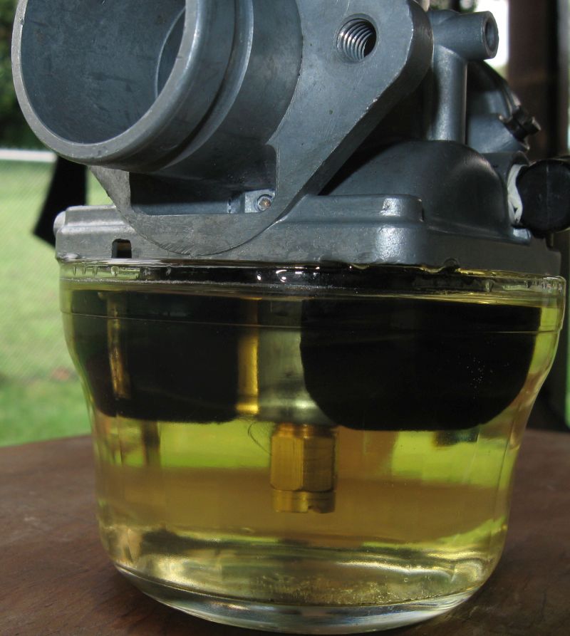

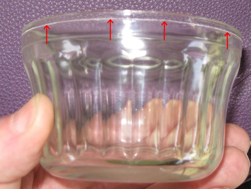

The glass cup used in this project was found in our kitchen cabinet when we moved in 27 yrs. ago. The Lovely Z1BEBE mentioned that it might be antique. All the better, because we're working with vintage technology anyway. Still, what are the chances the universe knew that, one day there would be VM28SC's, and slmjim one day looking for some random clear vessel specifically for them... coincidence? Another conversation for another time & a few beers.

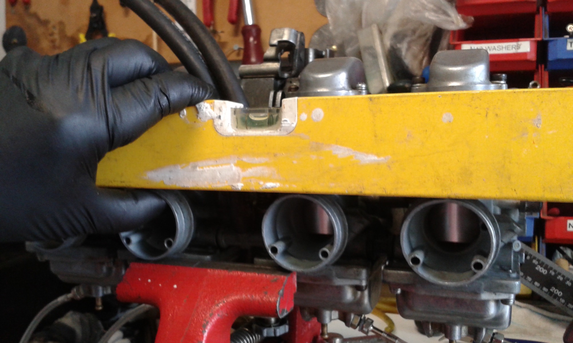

Carefully measuring 32mm below the center line of the venturi bore places the intended fuel level at 3 mm below the edge of the carburetor body. With that specification in hand we used a glass cutter to scribe a line all the way around the glass cup precisely 3mm below the lip. That becomes the target flat fuel level in the glass cup when the float is correctly adjusted. Scribed line seen at red arrows.:
Completely set up, using the same carburetor with which we determined the baseline variations of fuel level re: pure gasoline vs. E10 and, filled with E10 until stopped by the float, the experimental arrangement looks like this:

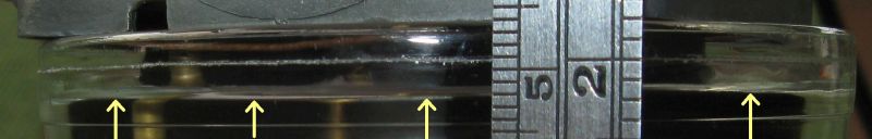

The meniscus that develops all the way around the inside of the glass cup can be easily ignored by focusing on the flat fuel level in the cup, which discounts the meniscus altogether. The flat fuel level can be seen much more easily in person than in the pic above. We can easily see that the flat fuel level in the glass cup is lower than the 3mm scribe line. A closeup helps. Red arrows at scribe line, yellow arrows at flat fuel level:
Now it's just a matter of removing the carburetor from the glass cup, placing it on a larger work surface, removing the float pivot pin, adjusting the float tang, and reinstalling only the float. Empty an ounce or so of fuel out of the glass cup, place the carburetor on the glass cup once more, turn on the fuel and wait for the fuel level to stabilize. No screws, float bowl or clear tube tool to deal with.
Because of some distortion resulting from diffraction of light passing through the fuel, and some distortion caused by the curvature of the glass cup, being able to precisely determine the flat fuel level in the glass cup can get a little tricky if the meniscus falls directly on the scribed line. We were able to make the flat fuel level much more visible by gently tapping the work surface, especially if the meniscus fell directly on the scribed line. The resulting movement and ripples of the fuel in the glass cup made it easy to see where the flat fuel level was, while making it much easier to ignore the meniscus. We also quickly realized that we had to pay careful attention to eye level when viewing the flat fuel level, so that we were viewing it on the same plane to prevent parallax error.
Once the float level was set we simply repeated it for the other three carburetors. A project that would usually require at least 2 tedious hours of removing and replacing float bowls for each adjustment on four carbs became much more rapid.
An aside that may not be specific to Mikuni VM28SC's - The float pivot pin is more of an interference fit in the float pivot pegs of some carburetor bodies than others. In the past, we have seen a few forum entries, and a few ruined carb bodies at swap meets, where unfortunae do-it-yourselfers have broken a float pivot peg off of a carburetor body by using too much force while attempting to remove or install the float pivot pin from an unsupported float pivot peg. Our solution is a random quarter inch drive socket from a mismatched set that we use as a support for the float pivot peg when removing and installing float pivot pins. It just happened to be exactly the correct height:

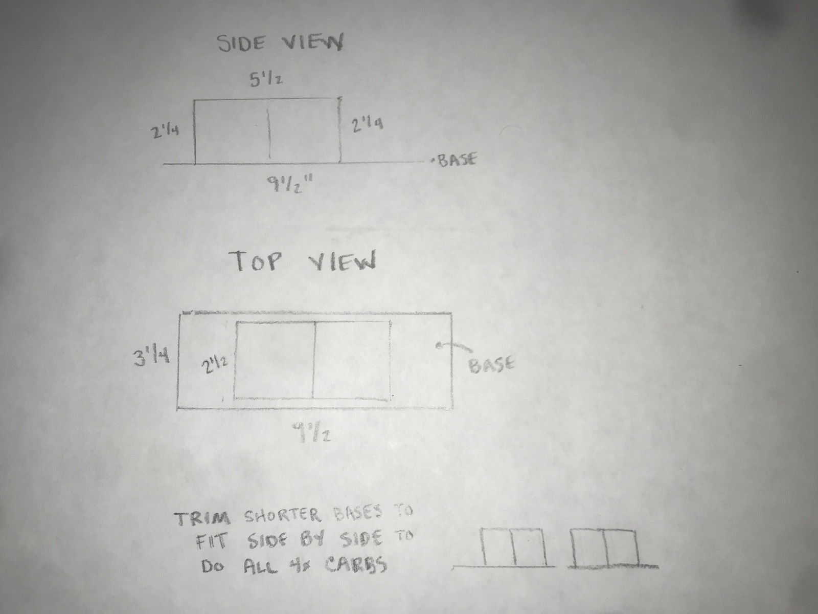

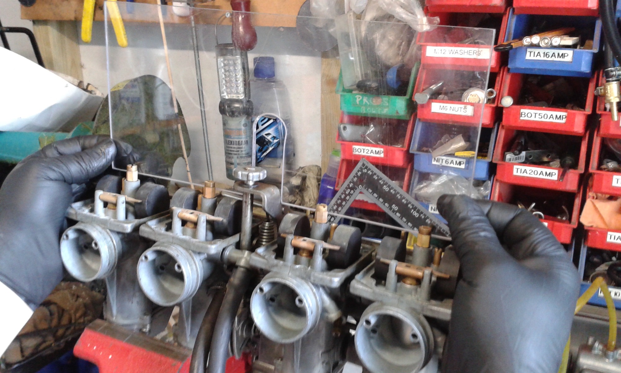

We mentioned earlier how to simply mimic a tool like that used on late Z1-A and all Z1-B carbs that have a small drain screw instead of the large 17mm main jet cover/plug used on early Z1 carbs. That OEM Z1-B tool replaces the small drain screw at the bottom of the float bowl with a hollow screw and hollow ' T ' that has the clear tube attached to it. An easy & cheap alternative is to use any flexible, clear plastic tubing of appropriate length and outside diameter. Simply 'screw' one end of the tubing into the float bowl drain hole until it's firmly held. If necessary, trim the end to a blunt conical shape to ease entry. A dab of of slickum can help ease with twisting into the screw hole threads.

Did your previous owners leave 4 of the glass bowls ? As you know from my posts re carb balancing I like ingenius alternative tools.
Thanks for posting. If you had 4 identical bowls you could theoretically do a bank of carbs and save a heap of time.
I may have to go shopping for suitable containers.

Rick H wrote:
"I may ask, how did you finally determine that the 32mm measurement related to the centerline of the carb bore? I don't believe I have ever seen that anywhere.
Rick H."
The 32mm fuel level is not clearly documented in the White Manual, only hinted at; that's been the problem ever since the White Manual was produced. But it is indeed there, at least in our opinion. We have no firm documentation to support this belief, only empirical evidence based on much consideration, experimentation, careful measurements and many conversations with other, more knowledgeable Z1 enthusiasts.
See Table 3 from the White Manual:
32mm +/= 1mm is clearly indicated but, nowhere in the manual are the measurement points specified. That's been the problem for many, including us, and for a long time.
Now. see Illustration 273 from the White manual.:
There is a poorly-printed horizontal line that intersects both mounting holes on the flanges of the carb body, as well as the centerline of the venturi bore. This would make a convenient and precise point from which to specify any number of things. We added arrows at each side of that horizontal line for clarity.
Our belief is that the horizontal venturi bore axis is the point from which fuel level is specified. Overall performance would be critically dependent on fuel level, that being the depth at which jets and other fuel-filled passages are immersed, especially the pilot jet and needle jet's emulsion tube. Very careful measurements bear that out. To the left of the illustration we added a vertical line with '32mm' centered within it. The top terminates at the horizontal line of the bore axis. The bottom shows where 32mm falls (although not to scale) 3mm below the edge of the carb body. The 3mm spec is the result of careful, repeated measurements 32mm below the venturi bore. There is no other precision point on the carb body from which to measure that falls anywhere near the 32mm spec.
Note that the +/- 1mm wiggle room defines only 2mm as service limits. That's a tiny variation. Too, there's the fact that the spec in print under 'Fuel level and Adjustment' on Pg. 75 indicates "about 1/8 inch, or 2.5 ~ 4.5 mm below the edge of the carb body." 3mm is at the upper portion of that spec.
Like many things related to Mama Kaw's beloved Z1, some technical info is the product of sleuthing. Our suspicion is that Mikuni supplied the 32mm +/- 1mm spec, and the White Manual service writers fudged it some to give the dealer Techs some breathing room.
These are experimental results based on a theory which takes into account many different aspects. So far, testing has supported the theory. Out hope is that others will chime in with the results of their experiments to confirm or refute the theory.
Good Ridin'
slmjim & Z1BEBE

Once you set it with gasoline, you can use water to see the difference. Then knowing the difference, couldn't you just use water from then on? Or do you think it won't be repeatable?
Great thought... you could reverse engineering it and set them using water height minus gas height. Then set them up with gas to determine the accuracy. Lou you might be on to something here.
- slmjim+Z1BEBE
- Posts: 1588
- Thanks: 1063
Re: UPDATE 4/01/26-Experimental alternative to a clear tube when setting fuel level.
12 Jul 2020 06:38loudhvx wrote: Excellent write up! I look forward to seeing it in print.
We'll be testing that with distilled water. That should offer reproducibility for anyone wishing to experiment with it themselves, regardless of the mineral & chemical content of their water source that may affect the results.

A member at the other forum posted this video. Thanks Dave240!
We're lusting after this guy's container that has the bottom drain nipple.
Good Ridin'

If you look at the info we added to the left of Illustration. 273 above, you'll see that we ended the arrow slightly above the shoulder of the float bowl. In the text we mentioned that was not to scale. In fact, it's a very close indication of where 32 mm falls on the float bowl.
Another member at the other forum posted this inquiry.:
"Refering [sic] to your picture above are you suggesting that there is a disparity between the 32 mm fuel level mentioned in manual & 1/8’’ fuel level in clear tube method for correct float level adjustment ?
Could both these be actually the same level due to capillary action of the fuel in the tube".
My (slmjim's) reply.:
"I'm a slow, simple-minded individual sometimes, and being a guy, I'm a visual animal. Illustration 273 clearly shows fuel level at the shoulder of the float bowl. That's the target I aimed for often, early in my Z1 days only to find the bike tended to run lean, especially on the later VM28SC's. I eventually learned to go 'out of spec' (higher) than what was shown in Ill. 273 but never understood why until much later. Then, when I realized the significance of the unexplained 32 mm fuel level in Table 3, it all finally clicked. The "about 1/8 inch" caption only serves to add uncertainty. That sharply-drawn shoulder is really a taper approx 1 mm wide to begin with, so there's already some imprecision introduced by design. Too, and by my measurements, the actual 32 mm level falls about 1 mm above the top of the shoulder's taper, where it has transitioned to vertical. In other words, setting fuel level at the top of the 1 mm wide taper as shown in the illustration already has the fuel level at the lowest limit specified in Table 3. If the visual representation of the fuel level in the illustration is taken literally as shown, there is no lower fuel level that stays with the 32 mm +/- 1 mm range; it's already at the lowest -1 mm limit.
The OEM clear tube tool originally came with a short length of clear, flexible tubing that had a shorter length of stiff plastic tube inserted into it. That stiff tube had thin red graduations spaced 1 mm apart IIRC. It cracked with age years ago and was no longer usable. The tubing I replaced it with has slightly larger ID than the original, so capillary action causing false elevation of the fuel level in the tubing is unlikely. I'm going to test larger tubing anyway to see if the bottom of the meniscus' concave is more pronounced, just out of curiosity.
We did do an experiment we didn't document, 'cause we didn't think it to be of any use.
We tested a vertical length of tubing that had a very small ID of 2 mm. What we saw using that was, fuel level climbed up, far past true fuel level. So high that if the fuel in the float bowl had truly been that high, fuel would have continuously drained out of the overflow pipe. We tried that experiment 4 times, draining the float bowl each time to make sure we weren't somehow seeing false readings."
Good Ridin'
slmjim & Z1BEBE

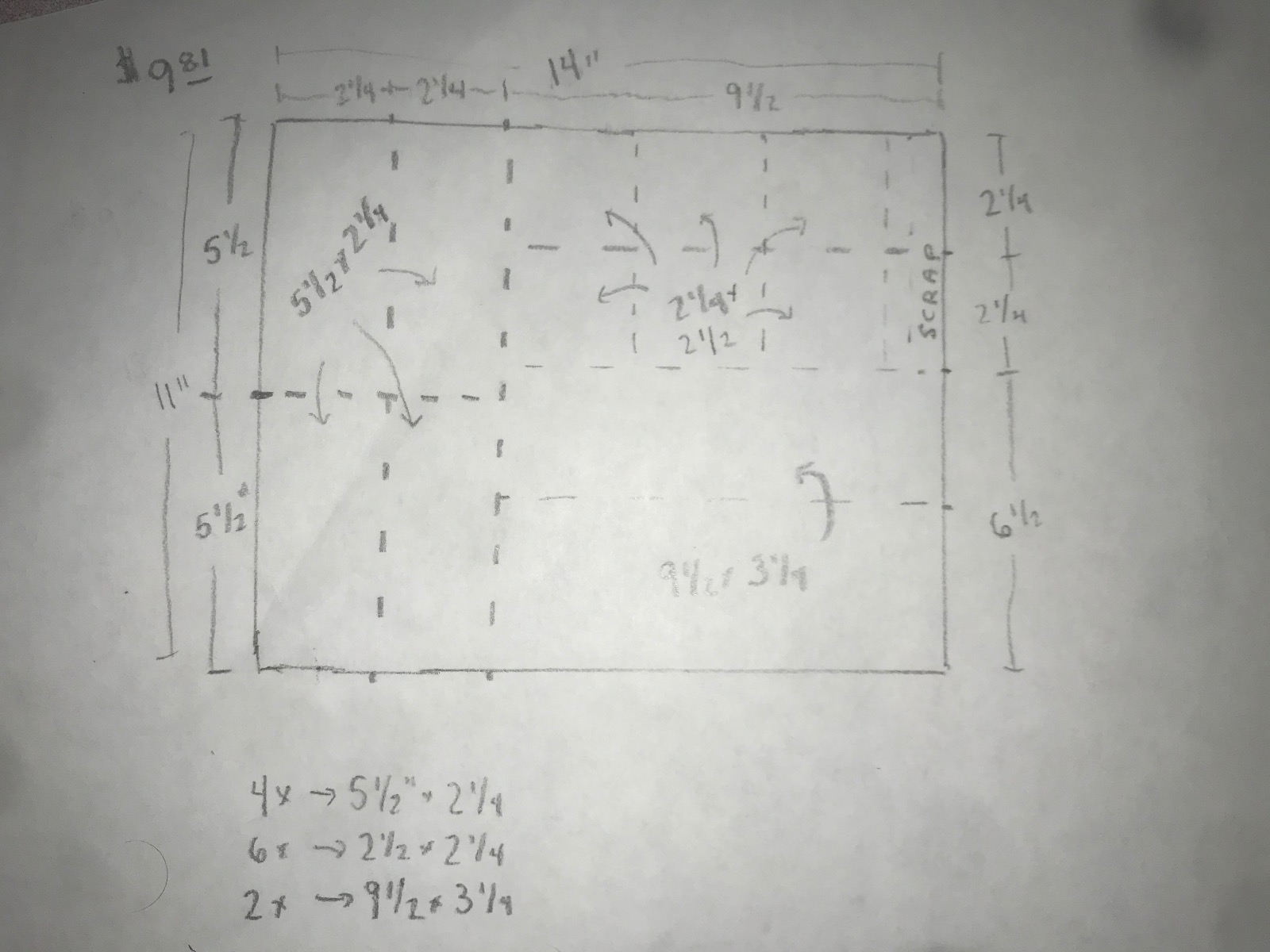

Full credit to slmjim&Z1BEBE for being the inspiration of this design.
While drinking my cup of morning motivation I had the idea to fabricate a float level box that could be used on 2 or 4 carbs while still being on the rack, was economical, and readily available for anyone that wanted to build.
If you already own a straight edge, a box knife, and some silicone the total price should come in at around 10$ and some time. All else that is needed is a 11”x14” sheet of plexiglass (Lowes has it listed locally for $9.81!)
I drew up a sketch of how to turn that one piece into two double carb float level boxes. I designed it as two double boxes because I figured the system would be easier to get level, plus it worked out for the single sheet of plexiglass.
My measurements were based off of my mikuni 26ss carbs. You will want to measure and adjust for your set up.
Here’s my idea for a slmjim box, or maybe a BEBE box?!!

I'm no mechanic but I do like to learn how things work and problem solve so about 4 years ago judging by the state of my spark plugs I thought I'd try adjusting the float levels, first time for everything :laugh: I figured the best chance I had was to measure the float levels using steel rules, calipers and a sheet of perspex I made up and then use the tube system but I didn't want to spend £20 on a tube tool and do one at a time so I simply drilled and tapped four bolts and made four tubes, it was still a pain adjusting, assembling, filling with fuel and measuring ,I think it took five adjustments as in five times disassembly and reassembly but I got there and the bike has run amazing and strong ever since, I also balanced the carbs as soon as they were back on, even now the spark plugs are a nice off white and a teeny bit sooty and all the same as each other so I'm glad I did the job and maybe learnt something too

What a great informative thread.
Sheath messed about with clear tube on y Z500 carbs, did the end ones with the tube easy enough then measured the float "height" of 1 and 4 using this measurement I set the height for 2 and 3. only time i need to redo is when i change that fibre washer on the petrol inlet., will now make a perspex "go no go" gauge for all 4
