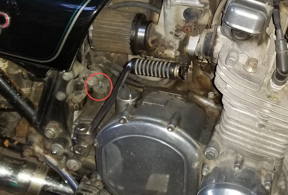

Not really sure on the mounting point.
What is more important----is it a good ground electrically?

Re: KZ1000 won't start after carb cleaning
09 Jul 2020 08:14
Yes that’s were battery negative is landed. Pull it and clean..,
