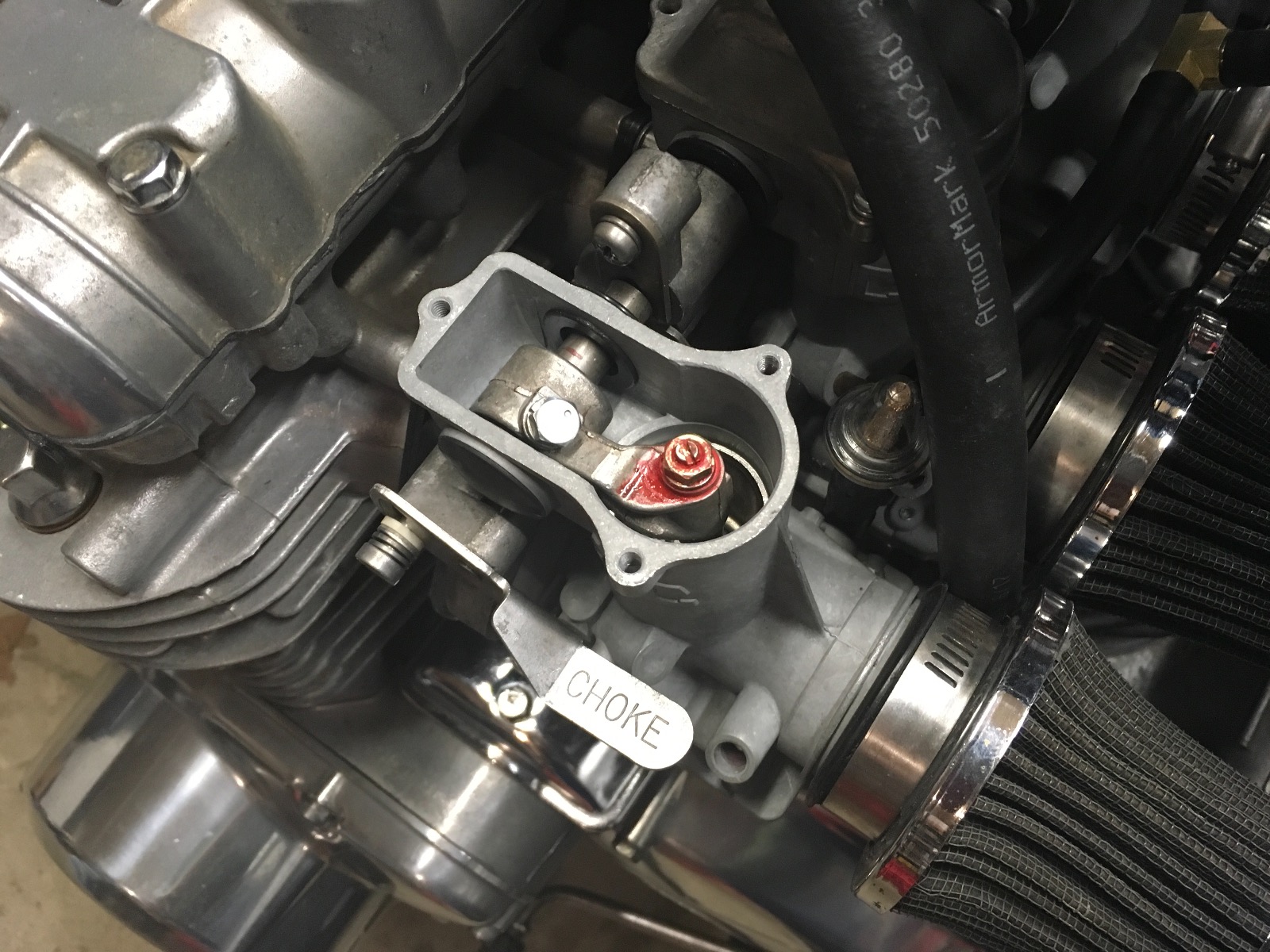

First question, the pumpers are done, installed and started for the first time. I am impressed with how well they idle just from a bench sync. Still going to put them through a carbpro sync. Unknown how but there is an unusual amount of locking paint on the synchronizer adjusters, see photo. Do I need to be concerned of paint flakes falling into the carburetor while performing the sync? I did have paint flaking off during the bench sync.

That red paint does not look stock. I've seen yellow, just a dab on the adjusters, but not red and not such a large quantity.

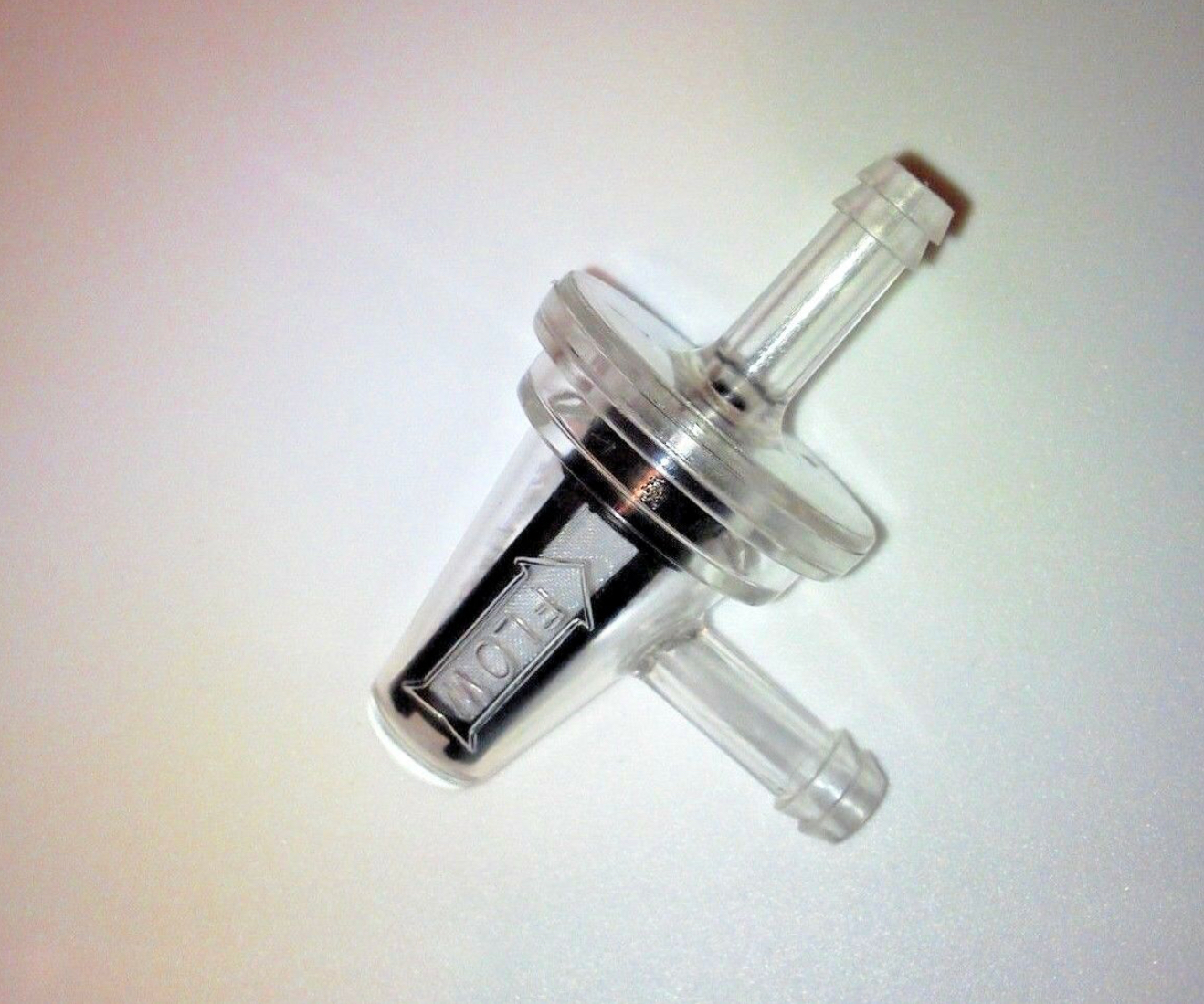

First critical path is the fuel leaks. Anyone have a connection for Corbin spring style fuel hose clamps that will fit and work on 10mm OD hose. I installed a Pingel petcock with one “goesoutta”. Used this fuel filter to make a 90 from The petcock to the tee, that’s were I’m getting the leak.

I use the red hose clamps you can find at the local hardware store. They come in all sizes and are easy to put on and take off.

Hardrock. Thank you, I gave up for now on the odd sized fuel line and installed some that I knew I could seal and take the fuel leaks off the list. Went for a 10 mile ride around the neighborhood this afternoon. Hanging RPM is gone. Pretty impressed with the performance. I'm going to guess it was me being concerned about the fuel leaks and I wasn't letting the float bowls completely fill. Nessism was correct, it was lean. Planning on another short ride tomorrow to warn it up then going to put them thru a carb sync. How worried to I need to be with the possibility of the red locking paint flacking off and getting into the carbs while syncing?

24 Mar 2020 01:39Mikaw wrote: How worried to I need to be with the possibility of the red locking paint flacking off and getting into the carbs while syncing?
Edit: Should I tune first before sync?
The paint shouldn't be a problem or get past the slides but you could slacken off the adjusters to disturb the paint and blow the tops out with an air line before syncing.

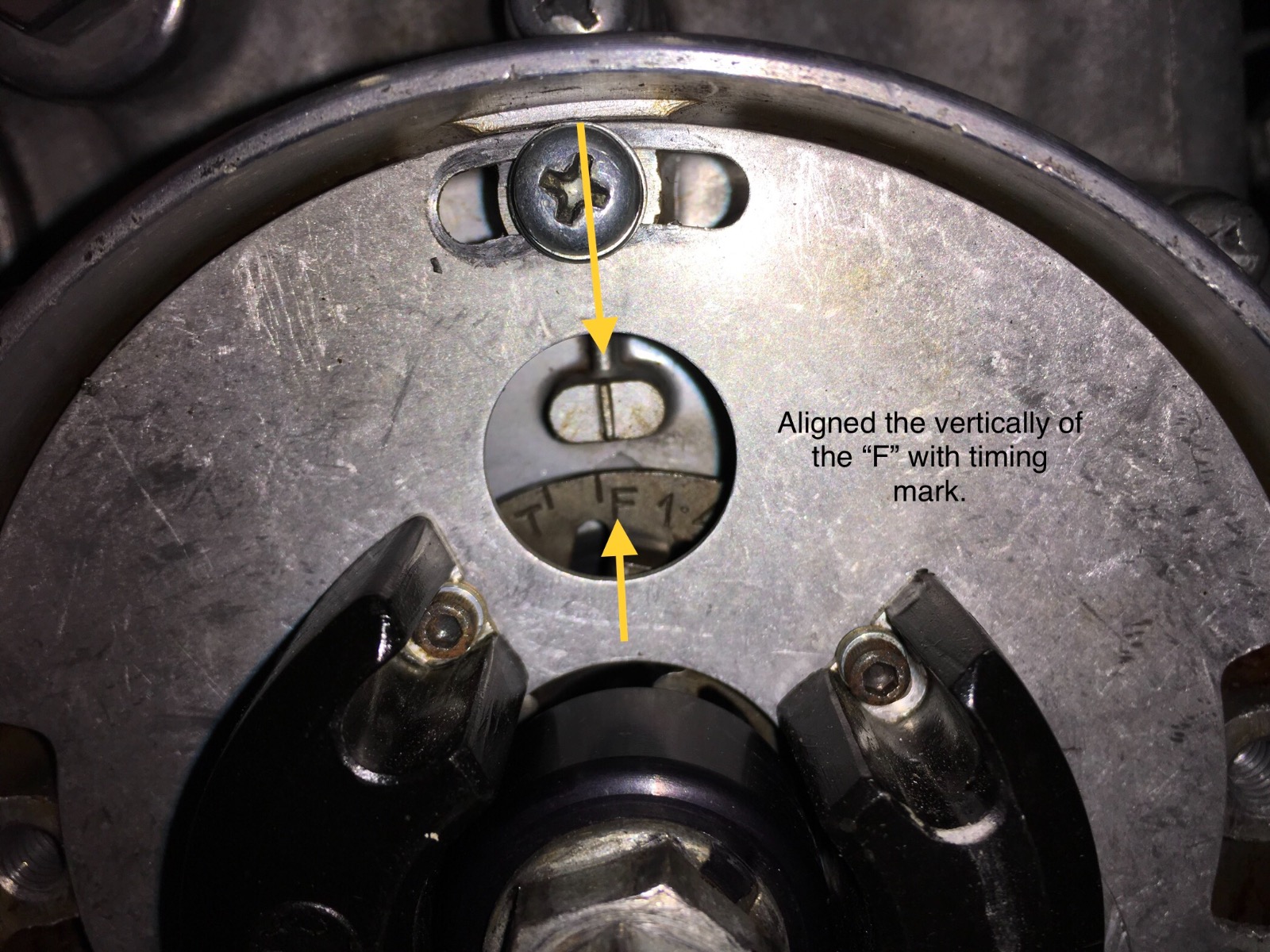

Do you have a comment on timing. Can it be advanced or is it better to leave it alone. Full disclosure I advanced it last night before the run. I have no way of telling number of degrees. My advancer plate has a line for the “F” mark.
And the letter “F” is stamped on the plate just advanced of the line. I only advanced enough to get timing directly over the stamped letter F
