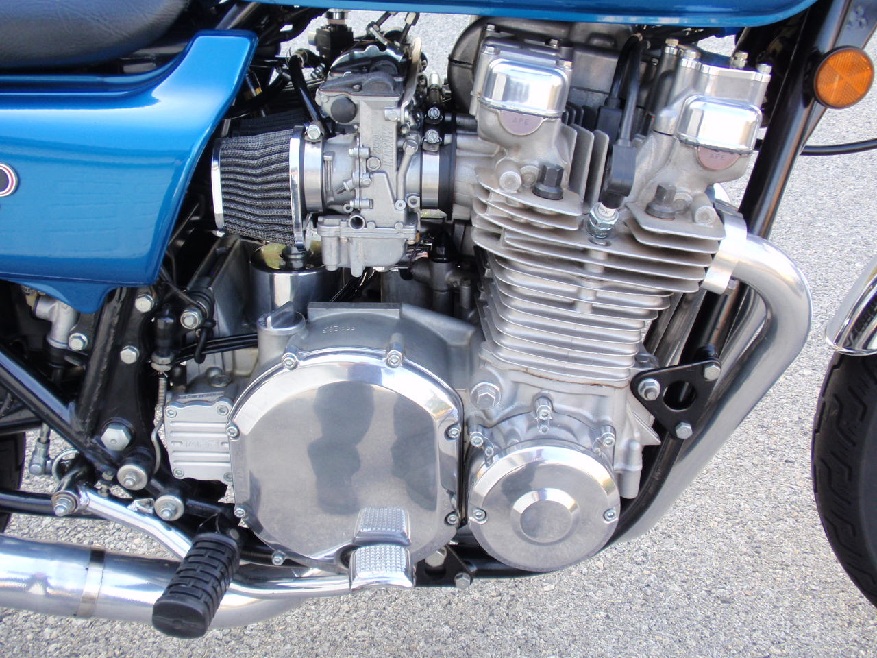

Like baldy110, I had the floats adjusted to lower the fuel level at one point, but decided to reset them to 17-18mm. per Mikuni recommendation.
Had to bend the tabs an awful lot to achieve 22mm, and it just seemed awkward to do something that Mikuni had not suggested in the manual. Nowhere could I find a reference to use the clear tube method for the RS carbs, or to set the levels 2-3mm fuel level below the bowl top. I did use the clear-tube to verify that the levels were the same across the set...

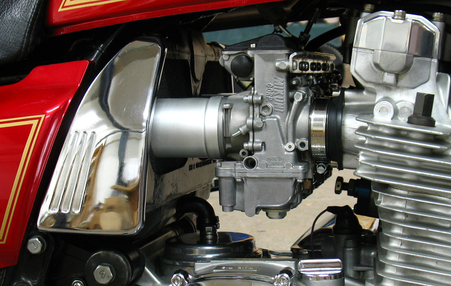

Yeah the ease of tune-ability is a major bonus. Changing the needles can be done with the carbs on the bike rather than dissembling half the rack. Heres RS-34s on my kz750 twin. The stock carbs on the twin are terrible in comparison.

The ease of tune-ability is awesome, but a pain to access with an air box in the way.
I recently reconfigured my air box to fit velocity stacks and RAM AIR filters. Once those have been removed through the air box, access to the Pilot Air Jets becomes unobstructed. Those jets are a pain for their size, but especially to get their tiny threads aligned and started correctly.

I like your air box idea, really clean. Am curious Dave what was your final carb settings and what did you do to the engine?

115 Mains
17.5 Pilots
0.7 Pilot Air
Stock Needles-Center Slot.
Stock Needle Jets
Pilot Fuel Screws-1/4 Turn
KRS-004 Mikuni Stacks
117.5 Main Jets messed with the low-end jetting, so I put back the 115's before pack-down. Will likely play with the jetting again in the Spring.
Engine is stock other than:
G1135-3 MTC piston kit w/cyl. bored and prepped by Pit Stop Performance.
Stock ZN1100 bath tub head milled .005 in 2015 for flatness; valves/seats touched up and Viton seals installed.
1984 ZX1100A camshafts using the stock ZN shim-on-top valve buckets.
APE Cyl Studs/Nuts, and Cam-Chain Adjuster
Non-Smog Cam Cover
Some Chrome
Bike is stock other than:
Dynatek 2000 with Mini-Coils, Copper Wires, Res-Caps, Non-Res U-Groove Plugs.
V&H 13009-J Header w/Street or Comp Baffle
Shindengen SH775
Progressive Shocks (12.5"), and Fork Springs
HEL SS Brake Lines
Pingel Petcock
160 MPH Speedo
:woohoo:
Shoot, now I want to go for a ride. :evil:
