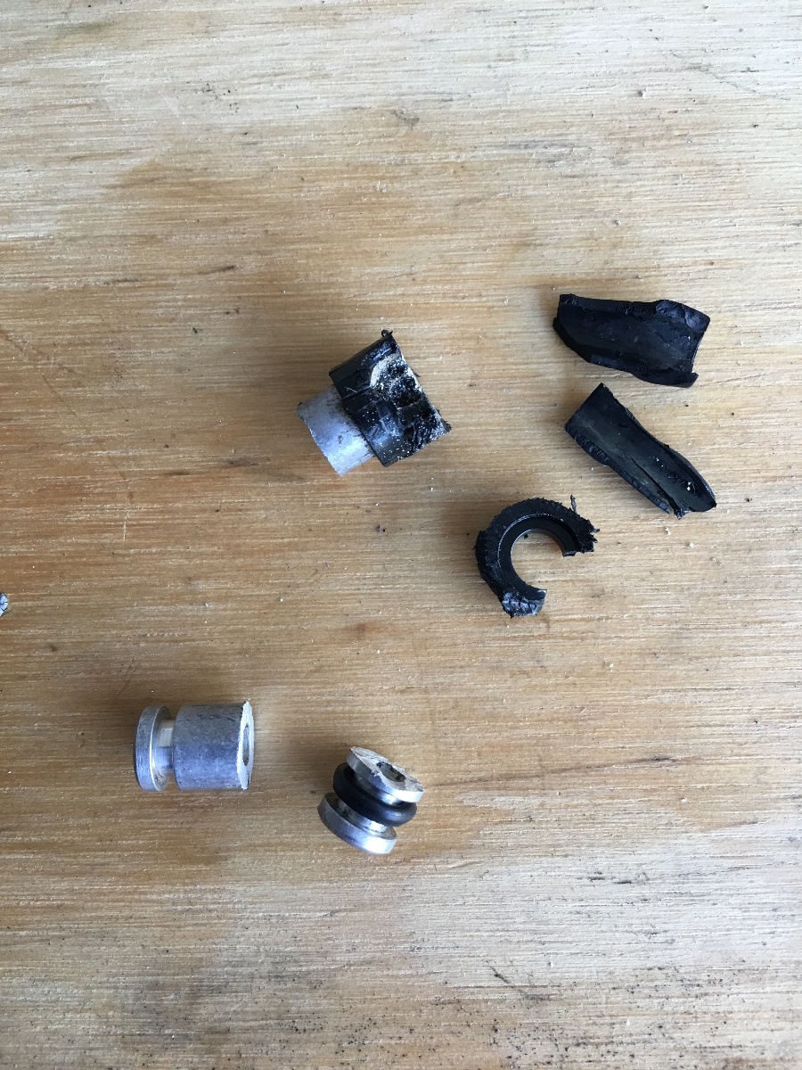

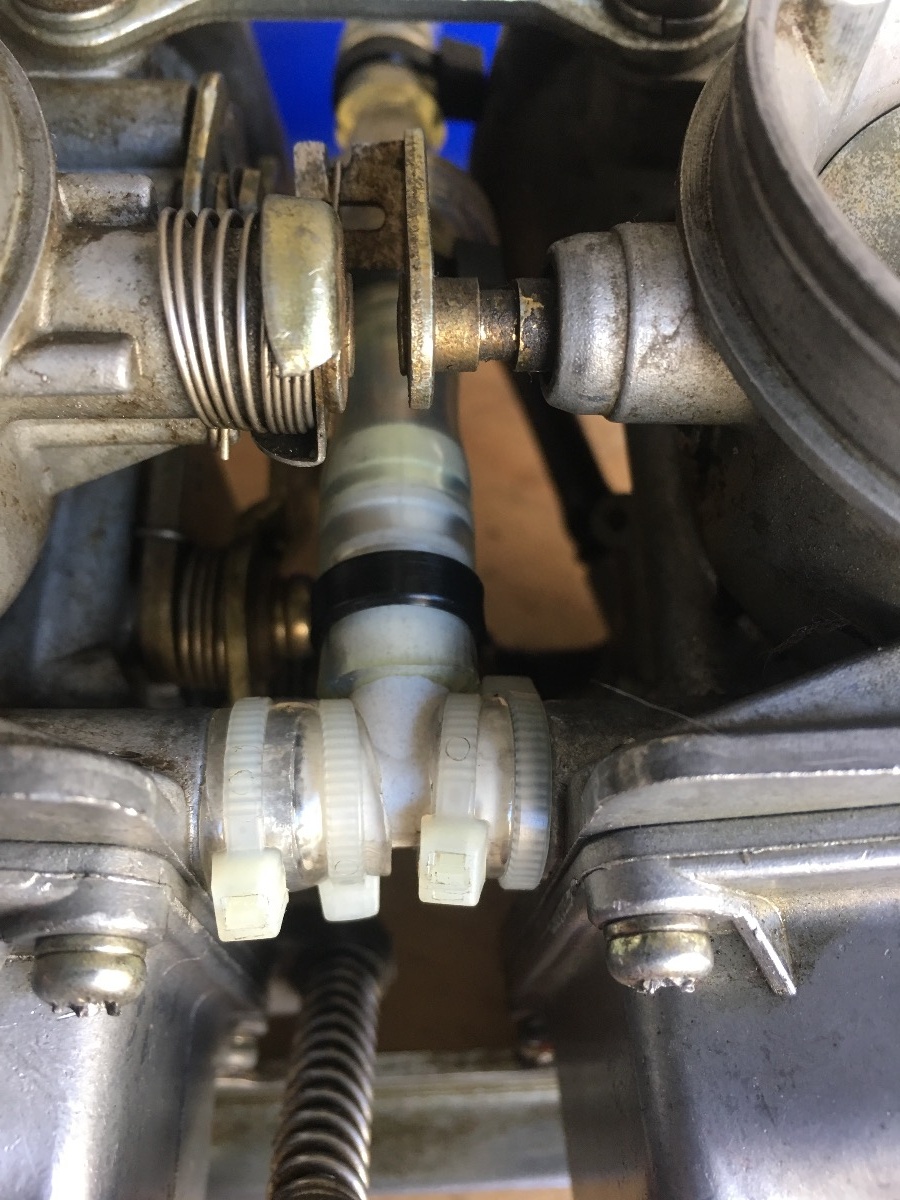

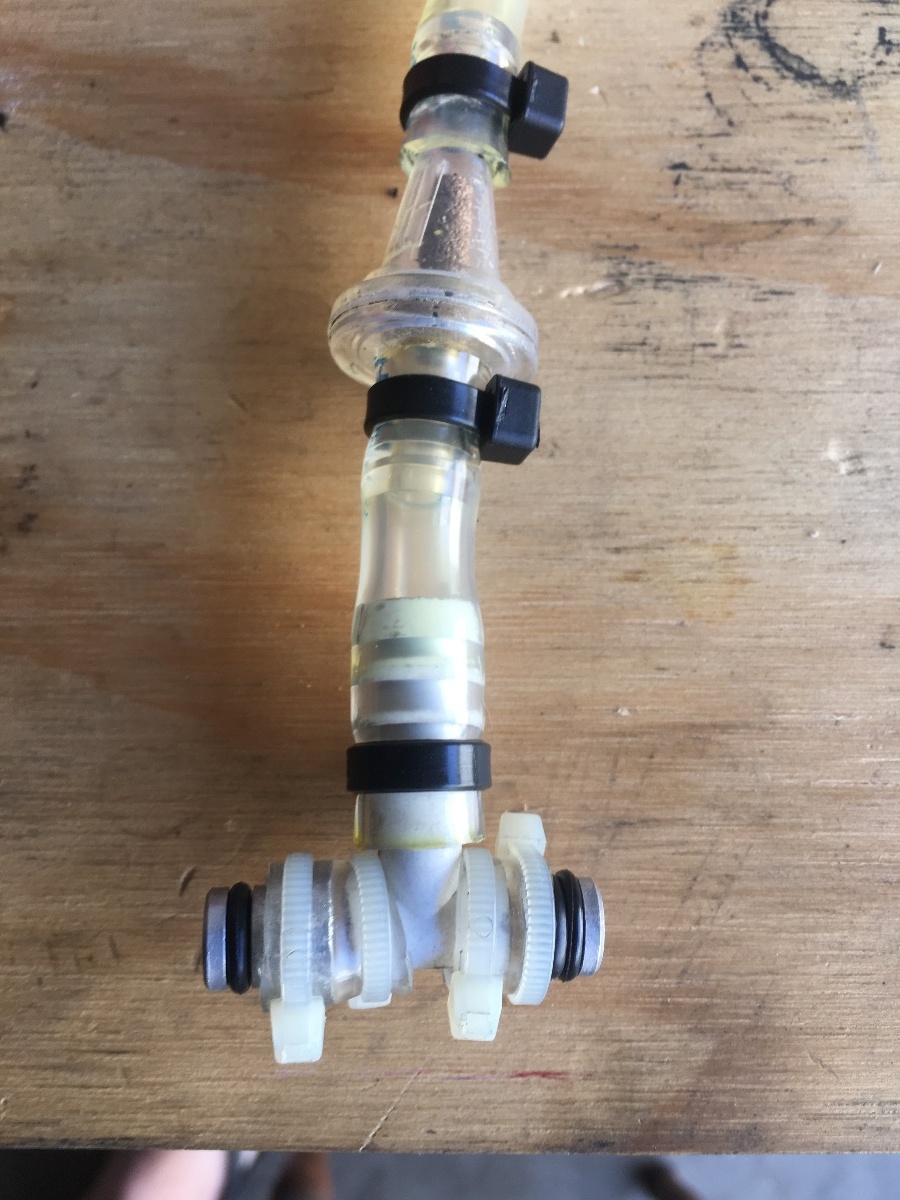

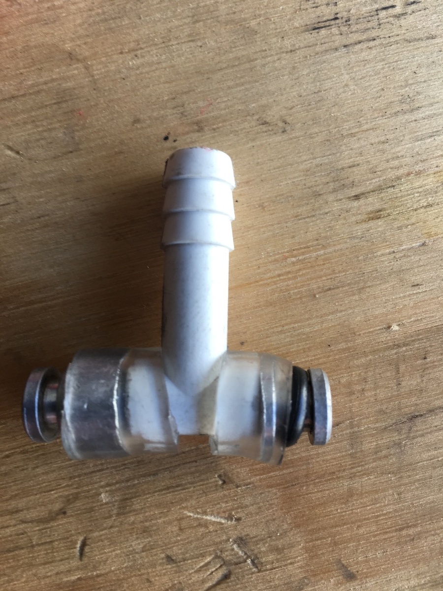

So I've been leaking gas from the fuel hose area between the carbs on my kz440 lately.
After troubleshooting I found a crack in the "T" fitting that splits the flow of gas from the fuel line to both carbs.
The ONLY replacement part I found online was eBay and was $40.
Instead of shelling out $40 I wasn't planing to spend..... I decided to fab up my own version.
In a YouTube video I watched recently, a guy was going to the same thing and decided to use a plastic universal T adapter and cut it to fit somehow.
I bought a package of misc sized fittings and this is what I came up with.
Instead of trying to get the actual plastic bits of the fittings to make a good seal with the hole in the carbs, I decided to just cut the nipples off of the original broken T fitting and use a bit of fuel line and zip ties to attach them to the new plastic fitting. This way, The fitting and original O-rings would make a nice seal inside the carb body.
It's not the most beautiful fabrication in the world… But it seems to be working! It's been over 24 hours and no leaks!
......oh and I didn't realize I should take pics until AFTER I cut up the old fitting. So the pics start with the cut up pieces.

A jerry-rig fix like that would be fine if you broke down somewhere on the road and need to get home, but I don't recommend it as a long term fix. Gasoline leaks are serious business, particularly when they are less than a foot away from your crotch. $40 to fix the bike properly is a bargain.
- loudhvx
- Posts: 10863
- Thanks: 1622
Re: DIY "T" Fitting
18 Sep 2017 07:49My thoughts exactly. That clear tubing is not going to hold up to ethanol for very long. Disassemble the rack and replace it with a proper part as soon as you can.Nessism wrote: A jerry-rig fix like that would be fine if you broke down somewhere on the road and need to get home, but I don't recommend it as a long term fix. Gasoline leaks are serious business, particularly when they are less than a foot away from your crotch. $40 to fix the bike properly is a bargain.
1981 KZ550 D1 gpz.
Kz550 valve train warning.
Other links.
Other links.
- Thanks: 2833
Re: DIY "T" Fitting
18 Sep 2017 08:07
I hope you have fire insurance and asbestos underwear. :laugh: Ed
- kevski
- Posts: 453
- Thanks: 174
Re: DIY "T" Fitting
18 Sep 2017 12:50
Jeez mister or is that miser the part you need is cheap enough, how many times will you botch it before you realize that you have spent more money than it would have cost you to do the job properly in the first place, please for your own safety and more importantly the safety of others around you put the tools away forever and give the bike to someone who is responsible enough to do the job properly!
