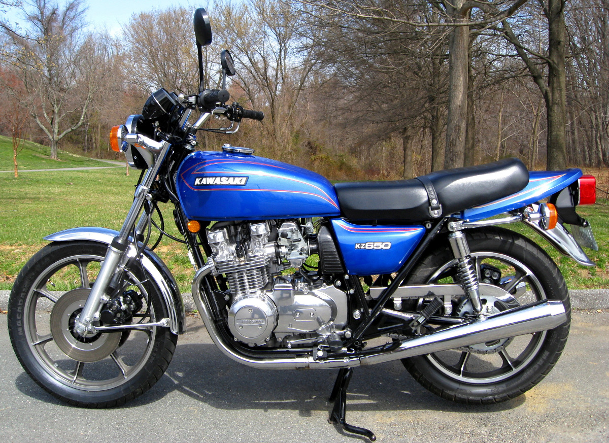

Regarding fuel line, fuel filters. etc. Take a look at the link below. It shows what I have been using for a number of years with zero problems. Keep in mind that I have owned my 1977 KZ650 since it was new (40+ years) and a BSA for 11 years prior to that, so I have tried quite a few different fuel lines etc. My current setup works great; I installed it all about 5 years ago. Ed

650ed, wow! That's so cool that you've had that bike for so long!!! May I ask how many miles are on it?

A bit over 60,000 miles. The bike has always performed well; other than routine maintenance (oil changes, points, etc.) I've never had to do any work on the engine. Ed
