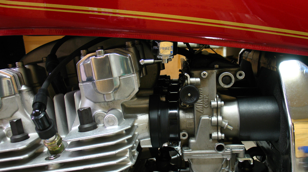

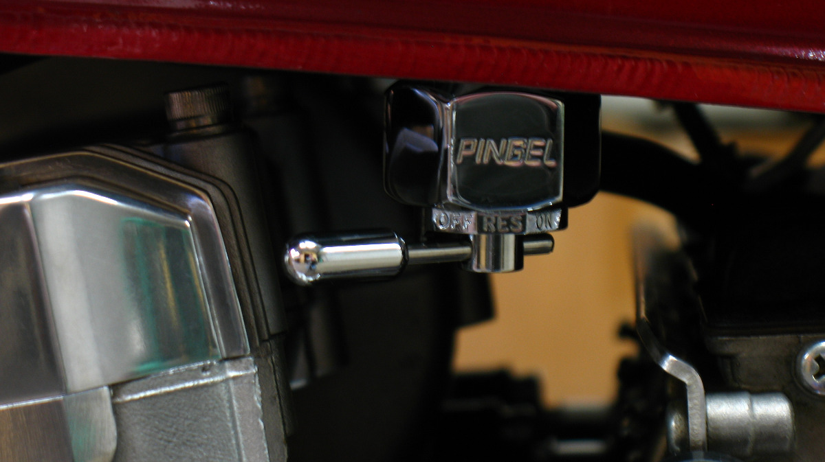

- Thanks: 2831
Re: Vacuum to manual petcock
11 Mar 2017 17:35
Looks good! Ed
