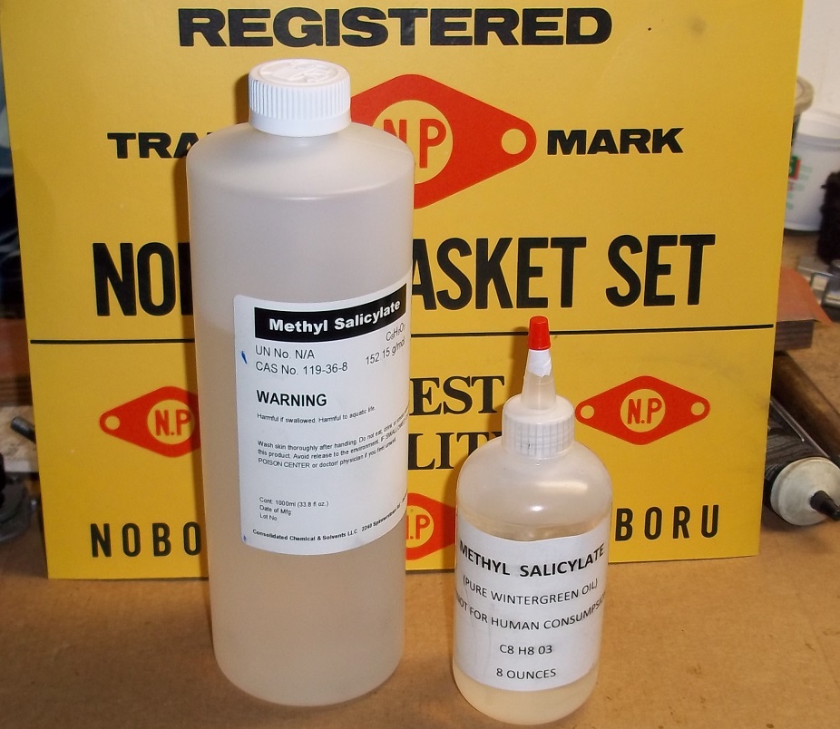

"Noblehops" - Nils Menten. Just finished the nice Z1B restoration thread - Restocycle in Arizona.
Wintergreen oil! It works! I could not believe it until i tried it.
I had let some same air box boots soak. I let it sit in cool mix. I forgot about them.
They were almost gray-white in color. But after i rinsed them 24 hours later they were black again.
The stuff smells like wintergreen life savers still
www.cbxclub.com/forum/viewtopic.php?f=27&t=8753

02 Sep 2016 09:47z1kzonly wrote: "Noblehops" - Nils Menten. Just finished the nice Z1B restoration thread - Restocycle in Arizona.
I'm very glad that worked for you - it has saved me time and money several times. I diluted mine with water and heated the brew, but I think the very best way to use it is to dilute it in a gallon of xylene and use it cold. I think it is a very BAD IDEA to heat xylene and be anywhere near it, so you didn't hear me suggest that you should. It was bad enough heating water and wintergreen oil - I could smell nothing but wintergreen lifesavers for three days after I used it
Get a nice new empty paint can from home depot (get the xylene there too) and save the brew! Mine is 3 or so years old by now, works fine.
