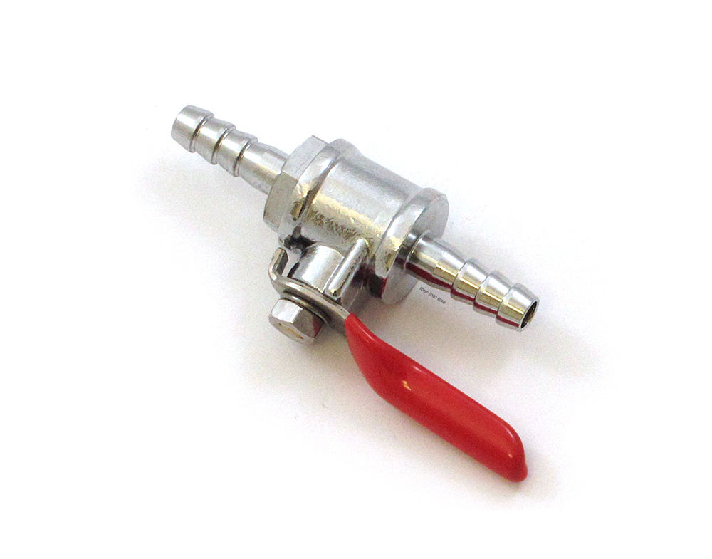

No eBay APP ID and/or Cert ID defined in Kunena configurationMaybe you can keep your reserve and use this. Thinking on a fuel cell in my top box.

Im going to be looking at several options for sure, and that is something I have considered. I am waiting to hear back from Pops on the bolt hole spacing on both my bike and his. Then when I am off work today (took the afternoon off paid, WOOT!) I am going to head to my local Kawi dealer and talk to the parts guy there and see if with his help I can't figure out the bolt hold spacing on the ZRX's and the Concourse 1000.
I suspect (still chewing on it and waiting to make a final decision) that I will just stretch the spring and replace the rubber on my current petcock on the old tank. Then when I have a bit of time while I refurbish the replacement tank I will have the answers and research I need to put in place a permanent solution when I swap the replacement tank over in a month or so. That way I can either order a kit, different petcock, in line shut off valve.... whatever I decide. I would like to make it trick but also clean and good looking.
