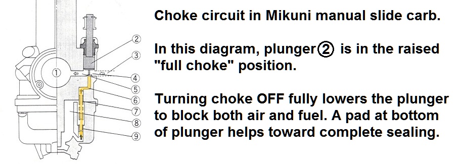

Air may also leak through worn or defective pads on the choke plungers.

Would double-check the other possible air leak sources before investigating condition of the plunger pads. Worn or damaged pads are more likely to admit fuel rather than air when the plungers are fully down (choke OFF). In the case at hand, would just assure that all four choke plungers are closing fully down when the choke is off.
