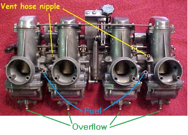

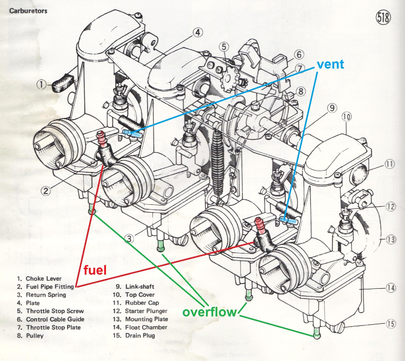

There are 2 nipples. One between the #1 and # 2 carbs and one between the #3 and #4 carbs. I don't know if they are overflow tubes or vent tubes.
