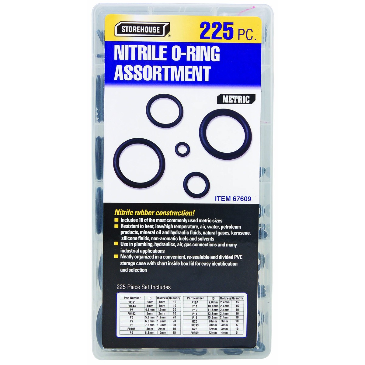

This pack At Harbor Freight has some that fit. Put a small amount of lube on the new o-ring, so it doesn't shear/ tear when installed. Sil-glide is a good product, but just some Petroleum Jelly/ Vaseline, works great for this.
www.harborfreight.com/225-piece-metric-n...ssortment-67609.html
