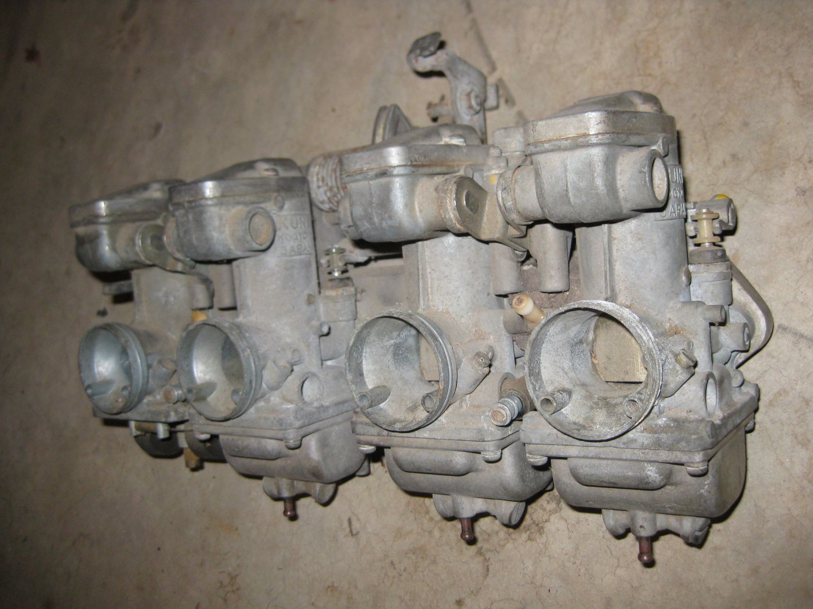

These are what I'm working with:
I took the top caps and float bowls off last night, they are clean inside, I was surprised! It just looks like there is external corrosion.
Should I completely disassemble the carbs before boiling in the lemon juice solution? I was just going to dip the carbs in an old metal toolbox sitting on my propane grill outside to boil for a few hours.

You don't have to take them completely apart. You can at least leave them attached to the rack. But because of the rubber parts you will need to take most everything else off (accelerator shaft due to the the grommets, any diaphragms, floats, etc) off. Should take all the jets off to allow better flow of the solution and so forth. After the lemon juice/water cooing is done. You should still use carb cleaner through the passages (pilot circuit as per Patton's instructions and the choke circuit) and compressed air through the passages to finish it off. Mine had mud packs in some of the passages. And the boiling will not work on that as great as other debris. So the better you clean it the less chance for issues later on. Good luck.

Try some PB Blaster down the sides of the slides and let them sit for an afternoon, it will allow the slides to free up nicely. As for the chokes, I found that removing the carbs from the rack will allow you to remove them easily and soak them separately to get them moving, again as said before, remove as many parts, especially rubber stuff to free things up faster and not ruin anything. Be careful trying to move the choke lever as they are prone to cracking around the area marked "choke" and are expensive little suckers to replace!
