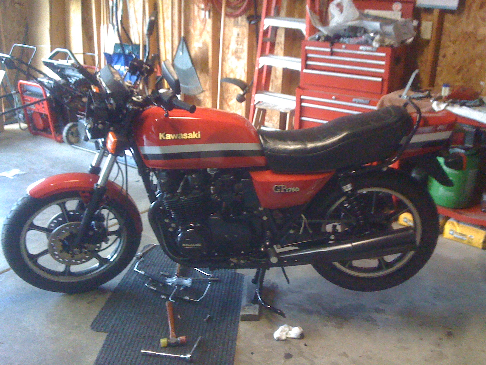

I'll give her a go! I reset the fuel levels. The float levels set at factory specs were not giving me the proper fuel levels in the bowls. So I set the floats to where they gave me the proper fuel level. I don't know if the after market carb kits don't allow the floats to get a proper height or the floats have been bent up and down so many times since 1982 that they need tweaking to work. What do you think of my project? (pic)
