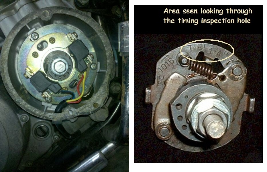

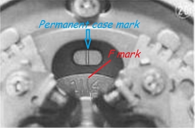

bike is an 83 with electronic ignition so the timing check you described won't work I believe -- the idea here is not checking the timing, but to assure functioning of the automatic advancer.
Could be mistaken, but thinking the bike at hand has a typical timing inspection window through which function of the advancer may be observed under a strobe type timing light while the engine is running.
Must remove the "points cover" to see through the timing window.
These images are different from the bike at hand, but should be similar enough to illustrate viewing marks on the advancer through the inspection window.
