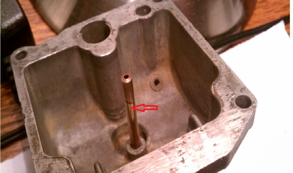

The carbs are off the bike, the parts are in the mail, and the service manual is on my computer as a PDF. I started to take apart the carb a little to see if there was any leaky drain needles. I filled both bowls up with water to the brim of the bowl, and there was no leak:
I filled them with water and left them above the sink to see if they leaked. Is there any problem testing these things with water? Gasoline is not so great to have in your house..
Untitled by Project Nate , on Flickr
The next thing I looked at was if the Floats, Float. They do. So I moved on to the float needle.
Here is a closeup of the driver side(lol) float needle. They are both VERY similar as far as wear goes, but I could include a photo of both of them if you wanted. I don't know if these are worn or not simply from my lack of experience, but I'll let you all make the call.
Finally I check the float needle seat. Again, very similar wear and I'm showing the one that was leaking 'more'
For my last test, I put the drivers side carb together and filled it with water. It didn't leak and I don't think I could cram anymore liquid in there. Maybe I fixed it, just by opening it up and some piece of crap fell out?
So I don't really know what to do except replace the parts as each piece looks to be in decent condition. float level adjustment?
please advise

No problem using the water. Some people like using rubbing alcohol. Not sure it matters with regards to the fluid properties (surface tension and the like). If you had a problem with the overflow tubes or drain plugs, it would have been evident with your test. Your needles have seem better days, they could be the cause. Once done with your carb cleaning and rebuild. Bench test the float levels using the clear tube method. If test fails, keep adjusting/testing until proper float level is achived. Once you have a good level, you can bench test the carb assembly for leaks to see if you get any more drips prior to installing on the bike. Don't forget to bench sync.

+1 on the water and needles.
You'll probably get replacement needles in the rebuild kits. With the needle seats it's a good idea to run a Q tip soaked in carb cleaner around the seats when you are cleaning everything else. With dirty seats I have used Brasso to good efect when carb cleaner was not good enough.
Good luck.
