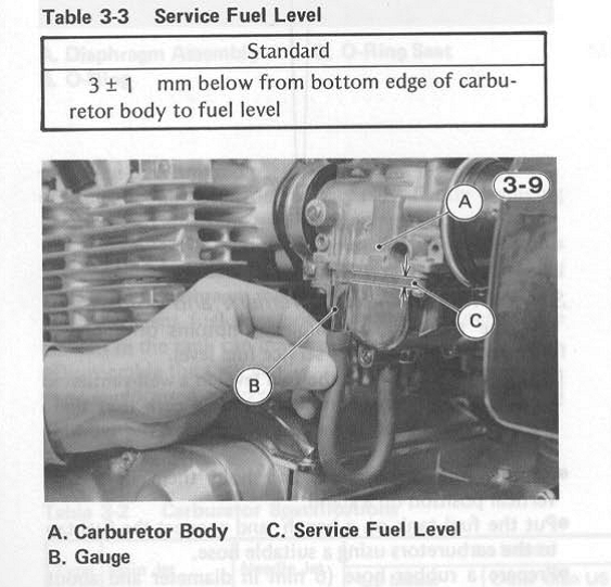

I checked all my carbs using the clear hose trick and what I have are 1,2,3 all about the same equal with the gasket. 4 is about .200 below the rest where should the level be?

This Is from the FSM.

Thank you for the picture. That is where #1,2,3 are and #4 is now there.

same as the other ones

yes they are all the same now.
