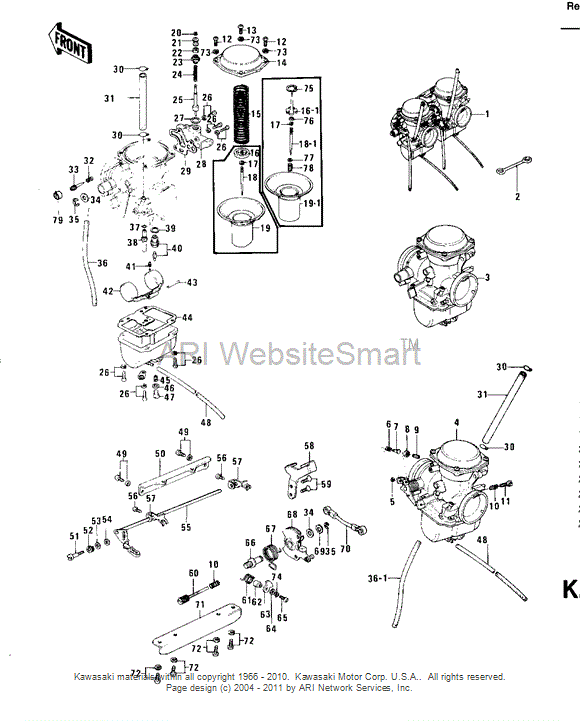

Is yours the B4 model?
here is a picture of the carb parts. You may still have the #79 plastic cap/ limiter which won't allow for much adjustment. But checking for air leaks and having dirty carb circuits will be issues that must be addressed. If you pop off these caps, then you can remove the mix screws, spray some carb clean into the passage. Might help, but really a through cleaning is more than likely required. As if these caps are still in place, they are most likely Virgins.

Did you do a thorough cleaning of the carbs? The mixture screws are standard the black caps that are on them that limit the amount of adjustment can be just pulled off.
