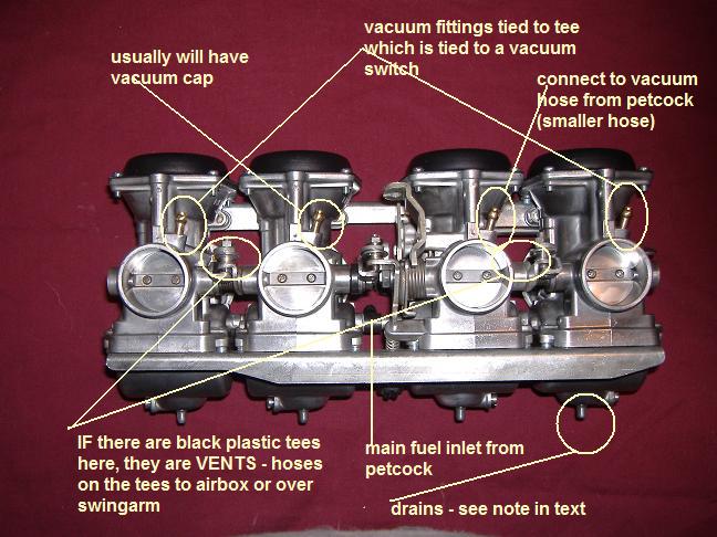

Must say not too sure how airbox to carb should be set up. Originally carb 1 and 4 were blanked off, with 2 & 3 having breather to aibox and fuel breather pipe attached.
After my Mate has had a play he has now blanked off 2,3 and 4 leaving fuel breather on 1 and no air box pipe to carb connected. Tho that said either combo has made no difference to my 6000 rpm prob!!:pinch:

29 May 2011 11:12wyliewix wrote: Must say not too sure how airbox to carb should be set up. Originally carb 1 and 4 were blanked off, with 2 & 3 having breather to aibox and fuel breather pipe attached.
I think a photo would be helpful here as this is really confusing. What is being blanked off? Also, knowing for sure which carbs you have would help, again a photo could help us determine that.

Carbs are cv type. By blanked off I mean a cap has been put on carb vents/nozzles found on the top.

Pretty sure nothing should be capped off from the factory. But others who have the 650 with CV's will pipe in, I'm sure. Check the manual download linked above - it may provide some clues.
