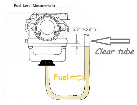

this is the clear tube taest as posted by patton.u can buy or make this tool. just put a line on the tube if u make your own, this will insure the same amount of fuel comes out of the bowl each time. and set the fuel level to the manufactures spec.
as for setting the slide level, any small drill bit will work fine. then u sync the carbs with a vacuum gauge later.

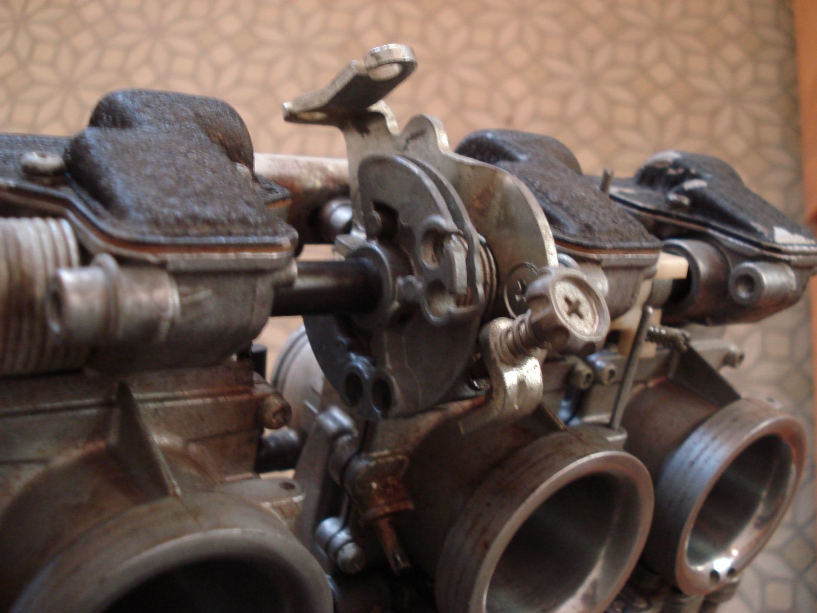

- mjg15
- Posts: 698
- Thanks: 18
Re: Mikuni RS34 Flatslides Help
30 Apr 2011 17:11

Yea, that was an ignorant statement on my part. Its been about a year or more since I touched these carbs and I remember reading somewhere that someone said they didn't have a thumbscrew. But they do. Just like the ones in your pic. What they DON'T have for sure is a small bowl drain screw, only the large drains similar to 29 smoothies to access the main jets easy.
At the end of the day, I got the bike running pretty well but its still not right. I moved the jet needles 3 seperate times, starting with them being in the middle, which caused the bike to fall on it's face HARD when hitting on the gas much past 1/4 throttle. Raised the needle up a notch and it corrected most of this problem, but still some hesitation if too hard. Decided to raise it to the last position (Needle highest) and that started to go the other way and make it worse, drowning it out so I put them back to the #4 position (if counting down from the top of the needle).
Still not really happy with the way its running though and I would think my bike could handle 34's at this point. Just put a 1075 kit in it and had a mild port/polish job done on the head, making sure to match the larger boots to the head's intake ports, no spots for the gas to puddle up. Also running a kerker header and pod filters of course. Anyway, not really sure where to go from here as I know I can't set the needle in any better position than what I just described. According to the tuning manual (HS tuning manual), I don't think my main jets have much to do with the issue as I start to get issues I'd say right past the 1/2 throttle position and the manual says the main jets don't even really matter until about 3/4 throttle. Anyone have any thoughts? Also, the accelerator pump is adjusted to start working as soon as the throttle is pulled and to work as long as it is possibly able to (the stop screw is adjusted all the way out). I have no issues up until about 1/2 throttle or so.
