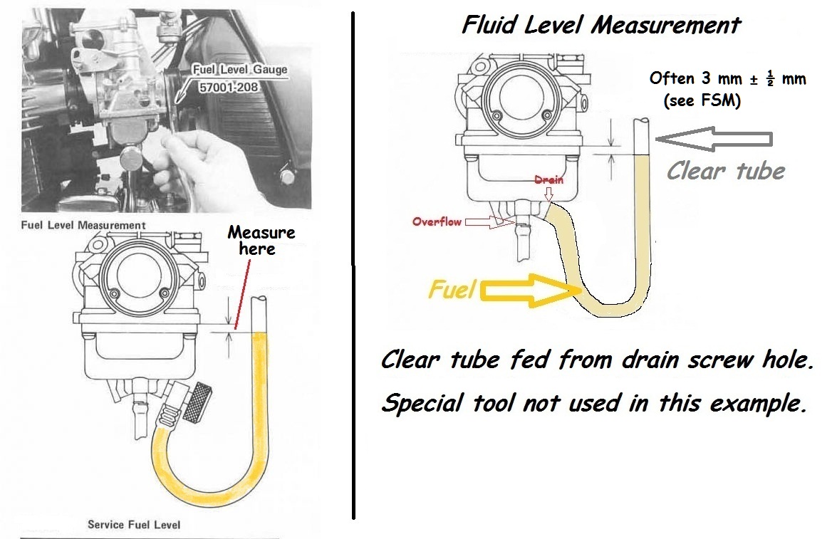

Next, would perform the clear tube test to assure fuel levels in carb float bowls are within specs.

Thanks. The coil voltage is perfect. I did the WG mod and put new coils on this winter. I did think about fuel in the oil. I can't really smell it but the sight glass has a beige foamy substance behind it , even after a new oil change. The filler cap also has a frothy almost whip cream beige sludge in it. The oil is normal when drained. What is the tube test?
