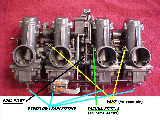

Carbs with a single fuel inlet tee use only one fuel line from the petcock.
Where petcock has dual fuel outlet nipples, may use only one of the nipples, and cap off the other unused nipple. A vacuum cap (plug) may suffice to cap off the unused petcock fuel outlet nipple.

The triangle shaped piece is a fuel pump, which imo isn't needed.

17 Apr 2011 23:35 - 17 Apr 2011 23:42Where carbs have the extra (green) vacuum nipple, it's usually for a hose to a vacuum petcock.
Any unused vacuum nipple should be capped (plugged) during normal engine operation (including the vacuum nipple on each carb holder).
Last edit: 17 Apr 2011 23:42 by Patton.
- Posts: 18567
- Thanks: 2103
Re: 79 kz1000 carb question
17 Apr 2011 23:44
Hoses connected to the vent nipples should exit to open air.
