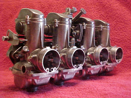

so guys, i bought this kz 650 a few months ago for this summers project and didnt get much time to look at the bike other than the nice mac exhaust and quality 2 up seat it had. this last weekend i went home and got my bikes running and checked the new one out and it had aftermarket coils, chrome guage covers, nearly new tires, all covers were in great shape, the original kawasaki tool kit, and most interesting to me, WAAYYY different carbs than i have on my other 650 sr...doing some research, i am nearly positive they are smoothies! how can i be certain??? i have a picture but its on my phone and is crap quality, it has the 17 mm drain plugs on the bottom... thats all i know for id'ing them!

Some of the early VM28's had the 17mm drain screw as well. Post a picture of the air filter side of the carbs and somebody will be able to identify them.

those float bowls fit pretty much everything from early 28s on z1 900s to 24s off kz650s,26s,newer 28s and 29 smoothbores.
the smoothbores are made of aluminum and weigh next to nothing compared to the regular die cast zinc bodied carbs,got a picture?

Looks like a smoothbore to me. Congrats, you got a good score on that one.

here are a
few pics....the 29's changed a bit to from the early to last ones i believe...
mine look most like the last pic shown here

the pic triangle posted that have the little square box obove the bowl on the right. is what your looking for when determaning 29 smothies
