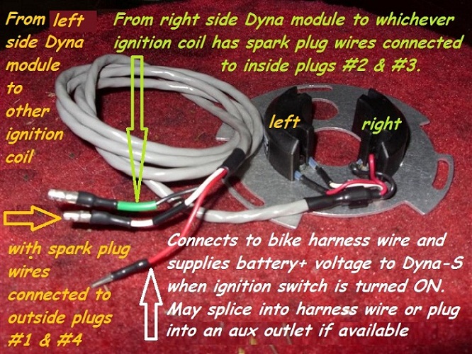

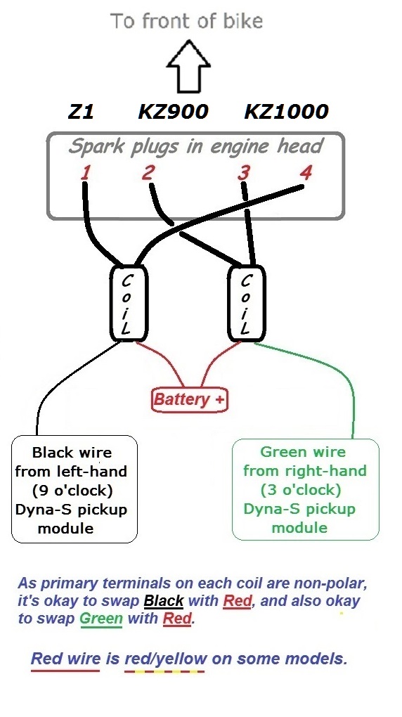

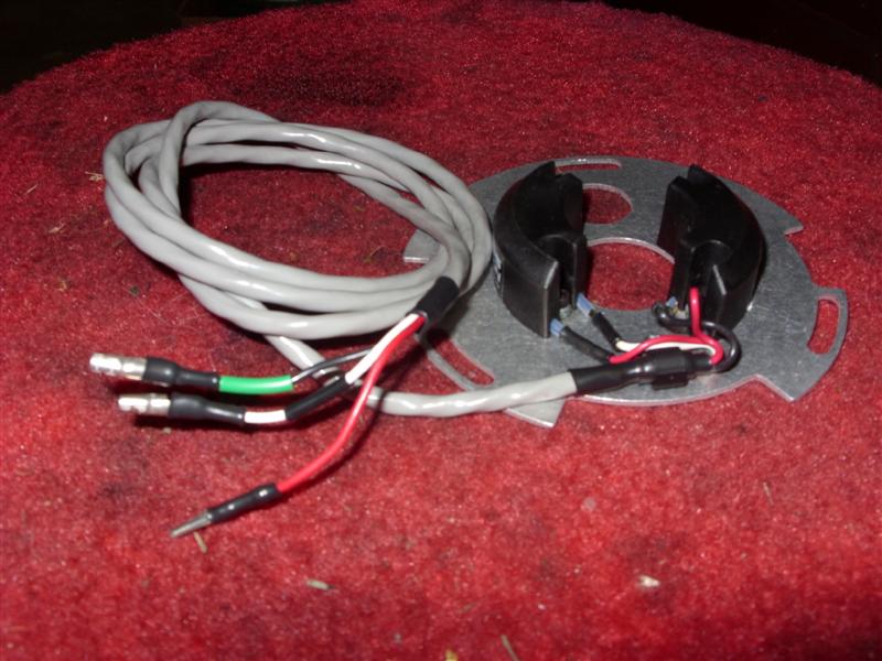

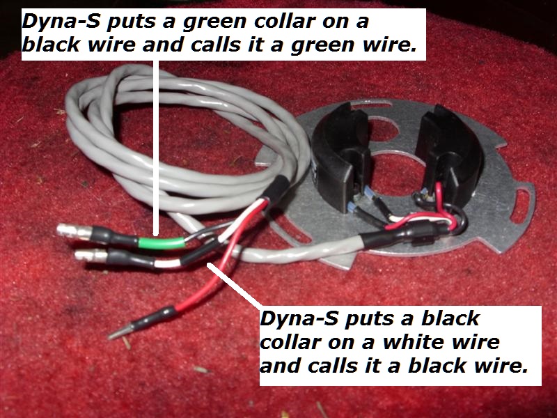

Ignition wiring for a total loss ignition without any charging system components should be relatively simple.
Is the Dyna-S complete with its red wire, green wire and black wire?
Which of the following ignition components are already fitted?
Two separate ignition coils;
Four spark plug wires;
Four B8ES spark plugs;
Four caps to connect the plug wires to the spark plugs;
Battery;
Negative battery cable;
Red or red/yellow wire from battery positive to each coil?
Good Fortune! :)

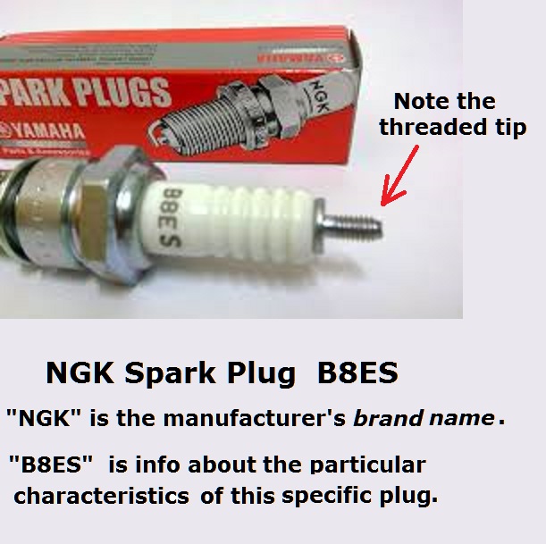

To be honest I haven't taken a good look at it, and I am told it is a complete dyna s, I am very green when it comes to working on bikes...how will I know if the plus are B8ES? No battery...I will look and try to get pictures later today to help

For info about how to interpret the code letters and numbers on the spark plug,
click here > www.blasterforum.com/threads/how-to-read...rk-plug-codes.43775/

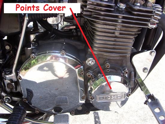

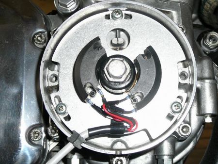

To see the Dyna-S, first remove the "points cover."
Here's what the Dyna-S looks like:
Note the three wires
Good Fortune! :)
