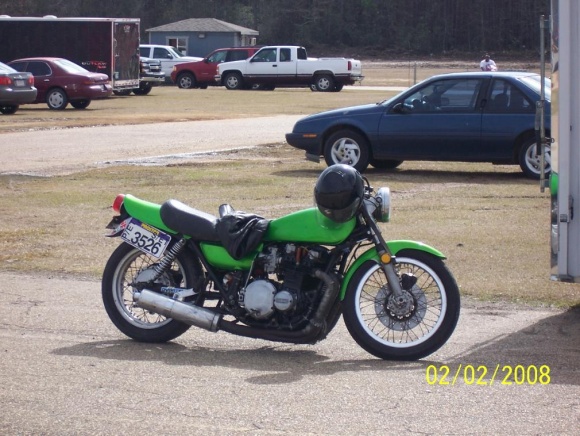

A no wheelie bar bike I would say takes about 150 hp to the rear to make it into the nines. Lots of ways to get there but minimum I would say is $3000 on up. Its easy to put $2000 up into the head and cams.

1975 Kaw Z1 900 61.5 WB 1393cc Jmodel head, street- strip sleeper. Best ET 1/4mile 9.43 @ 141 - 1/8mile 6.03@ 116. I bought this bike in 1995 as a street bike.In 1998 I installed a 1327 from a buddies dragbike.Ran 10.40s stock height and wheelbase. 10.20s lowered stock wheelbase. Went to 1393 with better head and went 10.00s- 10.03 best. Stretched it 3.5 inches 9.80s best 9.72 @136. Jmodel head 9.40s.Hurt a Busas feelings.

I would think 150 HP and if you are going to pay a shop to build a motor like that fo ryou your looking at $4000-$5000
