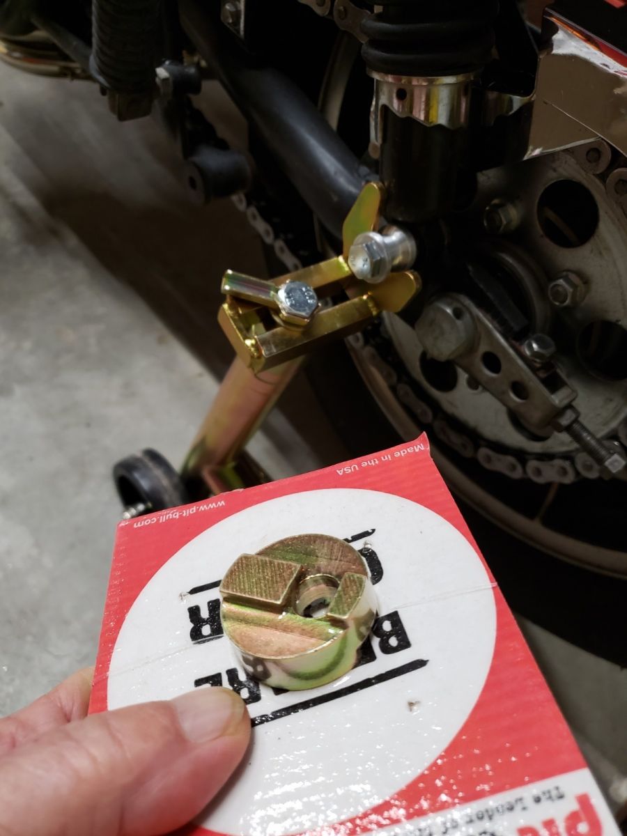

I made the spools and added these shims, 3 each side

I used a m10x1.25x50mm grade 8 bolt. Pit bull has an adjustable stand that will elevate to 15 1/4 the same as these 3 shims on each side. I think this is a stronger set up with a m12x1.75 bolt through the shims. I also have a head lift to match. My 900 with a Kerker the bolts on the spools.stick out rather far but are OK for just the shop. I should redesign the spools for allen head bolts but at a later date when its affordable, Im searching for a button head bolt also
