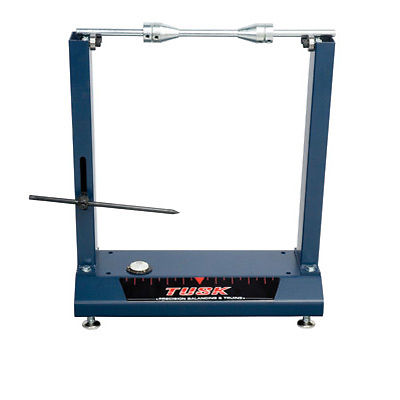

Anyone have any luck with these ? Going to attempt to true an 18" wheel and spoke assembly to my KZ hub. Or is there another stand you guys like ?

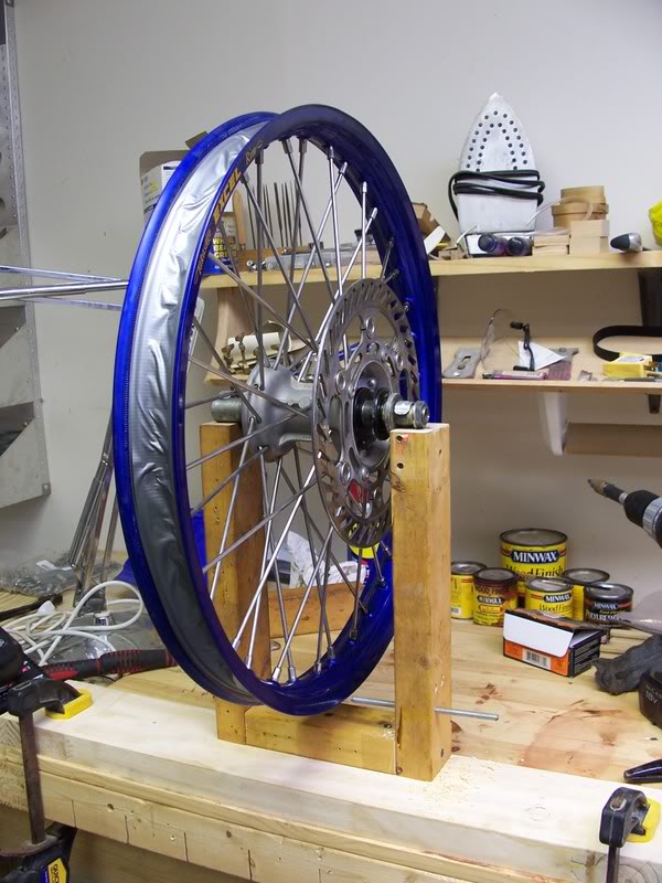

I made one out of 2x3's. I do the assembly and basic truing on that then do my final truing on the bike using a pencil or other pointer taped to the fork/swingarm. Zipties work too.
Couple of tips:

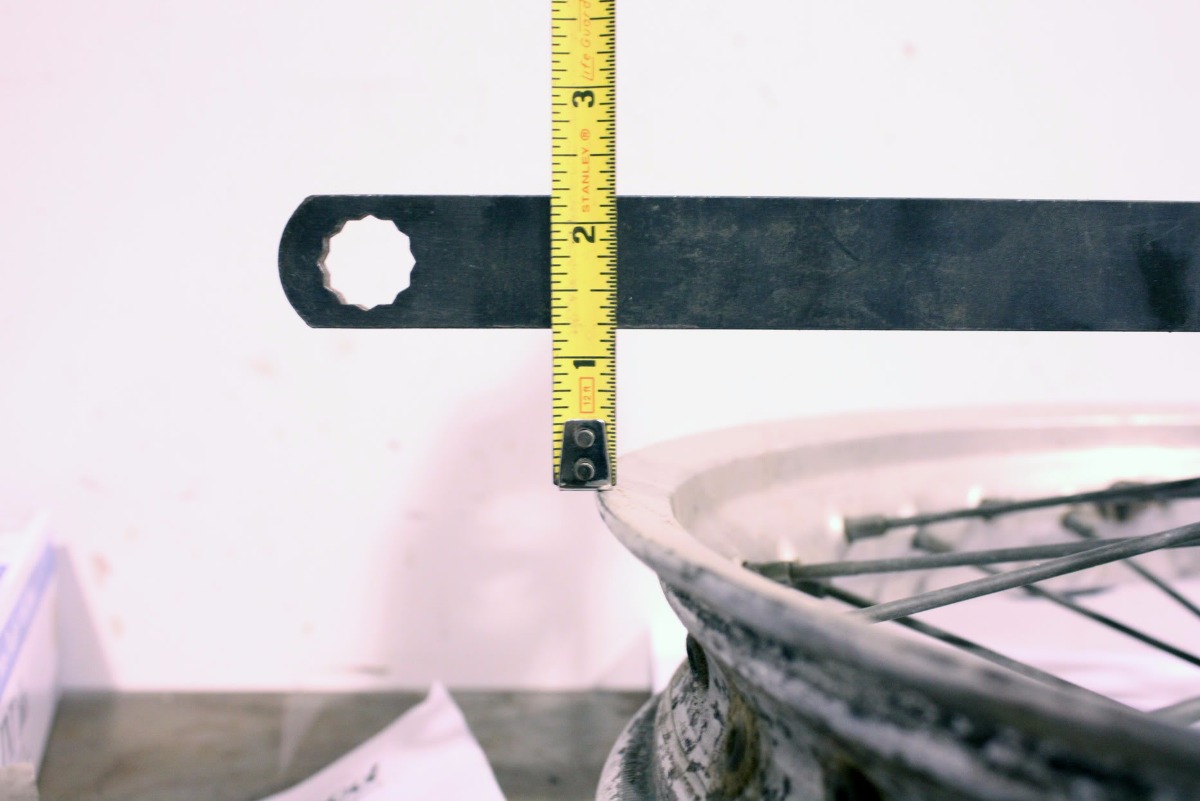

When you disassemble a wheel you should take a measurement from the surface of the hub to the rim. Lay a straight edge across the wheel and measure down with a tape measure. Take a photo so you remember exactly how you measured it. Not all hubs are centered in the rim so you need to put the offset back in while building.
When removing spokes, use the last spoke as a "key spoke". I use a small centerpunch to mark the hub and rim. This makes rebuilding a TON easier.
When the wheel is assembled, do the radial truing first making sure the hub is in the center of the rim. Then do a preliminary axial truing. Then mount it on the bike and do your final truing.
Also, I mark the inside of the rim so I know where I'm at when skipping around doing the radial truing.

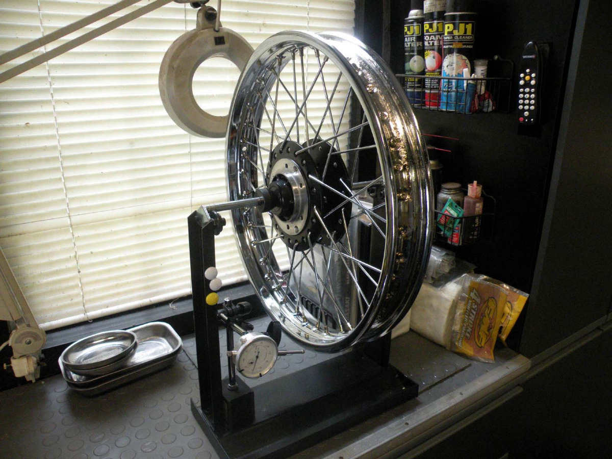

I've got the Harbor Freight version, which looks very similar. Tt works fine for me. The sliding cone inserts on the "axle" make it easy to use with a variety of sizes. I also have a dial indicator with magnetic base. The DI is probably overkill. I don't get hung-up on the exact measurements. It's really a fancy pointer that shows in/out quickly. . You'll never get a rim absolutely perfect. The magnetic base does make it easy to re-position to measure axial and radial run out. Notice the little white and yellow dots on the left upright. Those are magnets for a dry erase board. They work great as a temporary marker on the rim. I think a 6 pack of multiple colors was under a buck at Staples.
If you really want to make an investment in wheel building tools, I would recommend a spoke torque wrench. .It's a little pricey if you'll never build another set of wheels. It's one of those tools that you'll get a lifetime of use from.. I bought mine probably 15 years ago and have definitely got my money's worth. Over tightened spokes can be worse than loose ones.

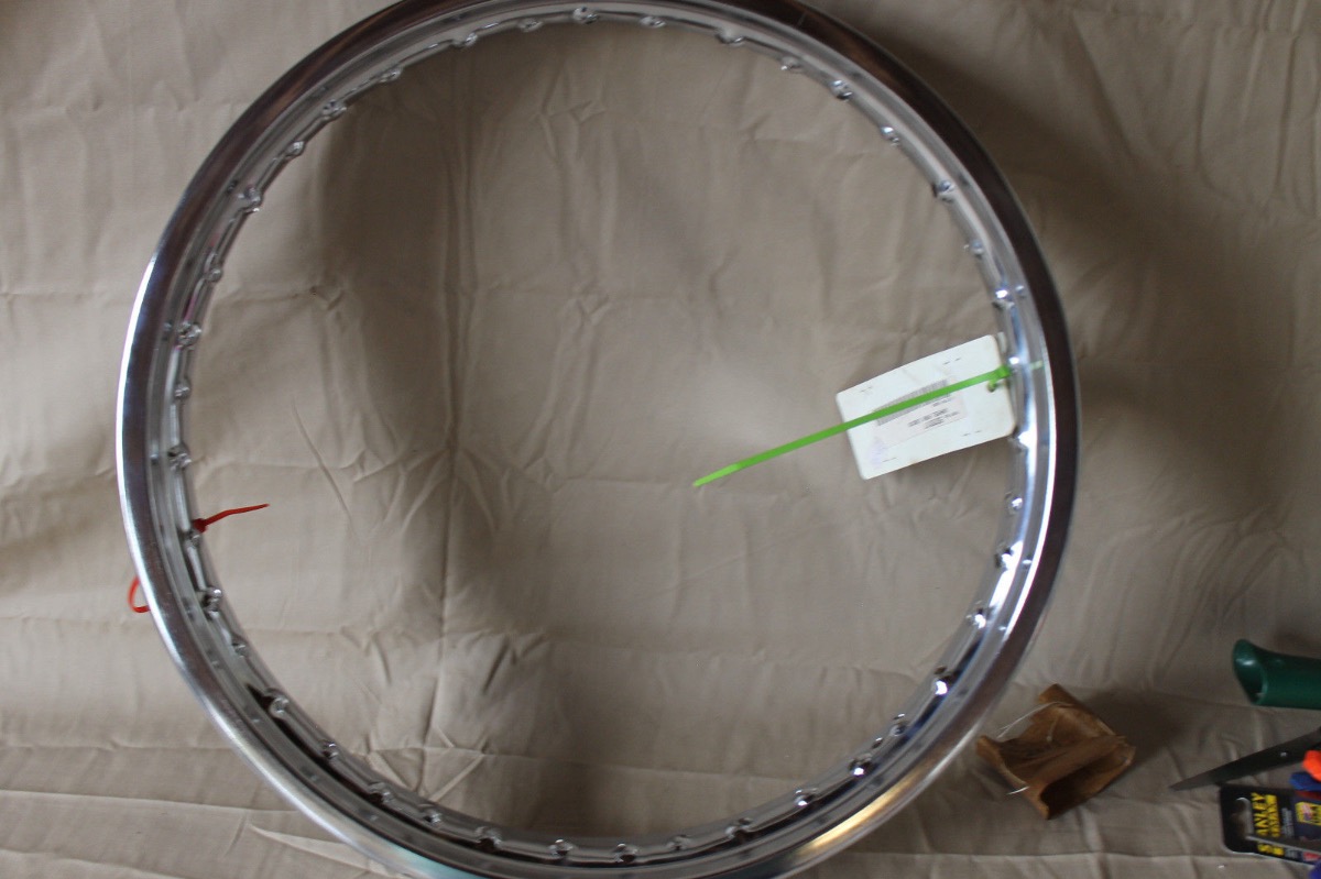

Kidkawie, On your 2 x 4 wooden stand, did you just take the stock front wheel axle and just lay on top of the upright 2 x 4's ?

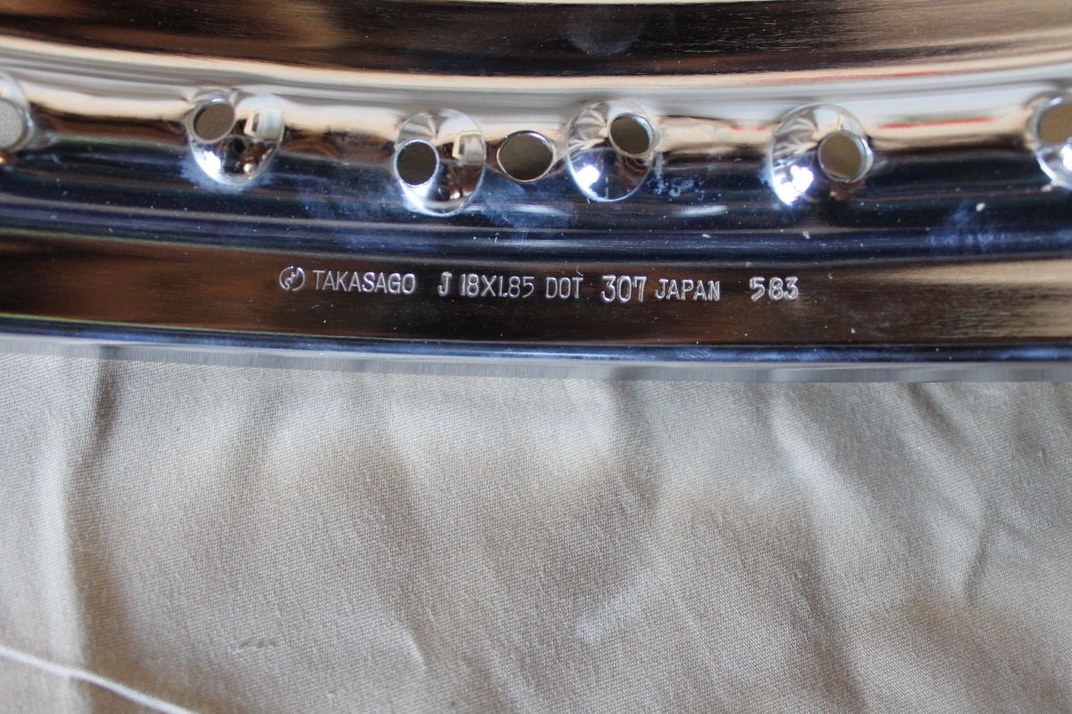

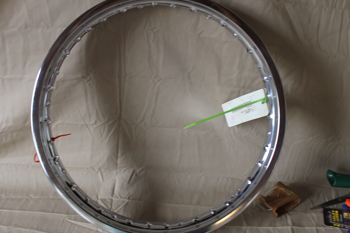

Also, I'm taking another KZ1000 hub I purchase off of Brian on the Forum and am going to lace spokes to an 18" rim ( 1.85 x 18 40-spoke Takasago ) I just recently purchased off of eBay.
Anyone know where I can Purchase a good set of spokes ( 40 ) besides Buchannon ? They're kind of pricey.
