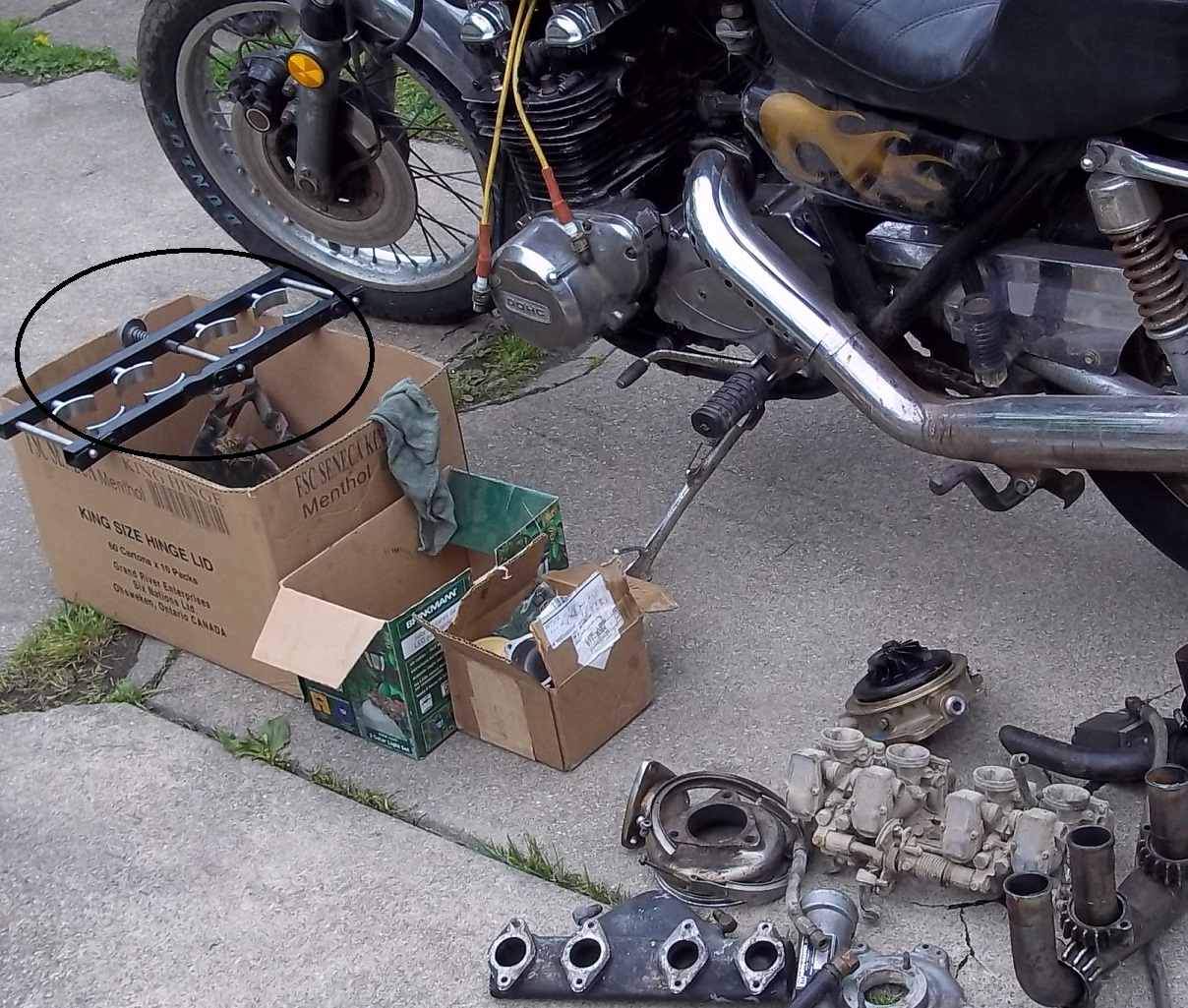

18 Feb 2015 08:10 - 18 Feb 2015 08:11LarryC wrote: I have one of those factory compressors....it sits in box ...best place for it IMO
These work great for me.
Yes the best, good ol' screw clamps. Plus you take a air grinder with a smooth whatever and smooth out the insides of the clamp first. And I have 2 pieces of aluminum stock. appox. 1" x 2 12" long. I set the 2 pieces of aluminum across the block at the insides of 2 & 3 piston just at the point were all 4 pistons are straight across just to hold on the down stroke of 2 & 3. Hard to explain! But this way you drop cylinder over all 4 at same time. Just enough of a drop, so the rings make it in. take off clamps and pull the spacer blocks out and there you go.
I did get this once in a pile of parts I bought cheap. I got $200 for this one on ebay 1-2 yrs. ago.
I tripled my investment on this score May of 2014
Attachment 1507078_849708621712164_5861422414565000379_n.jpg not found
