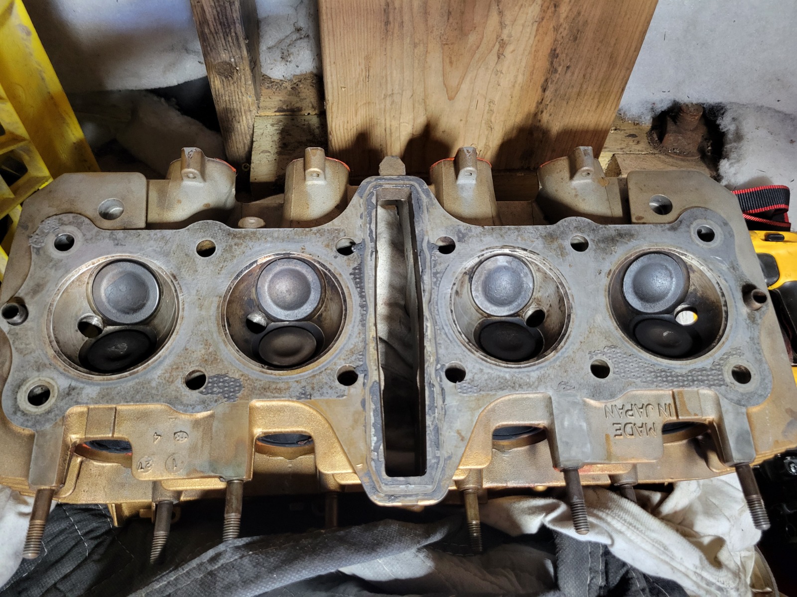

Re: Head match
14 Sep 2026 15:28 - 15 Sep 2026 00:24
Last edit: 15 Sep 2026 00:24 by Wookie58.
- zed1015
- Posts: 3370
- Thanks: 2080
Re: Head match
14 Sep 2026 16:17 - 14 Sep 2026 23:42
That is a normal Hemispherical combustion chamber so you can use the heads from Z1000J, Z1000R,GPZ1100B2,and most Z1100's with the hemi combustion chamber.
The years for the Bath tub head are 83 to 85 for the GPZ1100A ,83 to 85 for Z1100R , 84 to 85 for the ZN1100 LTD and 83 Spectre...
Is that your head in the pic ?
What's wrong with it ?
Last edit: 14 Sep 2026 23:42 by zed1015.
- lovethemkzs
- Posts: 95
- Thanks: 18
Re: Head match
14 Sep 2026 16:21
Thank you most of what you said I understand but not everything like bathtub but I know about the Hemi hemispherical don't know how to tell one but I know what they are and from the models you gave me I'm sure I can find me a new head and I appreciate your help in time thank you

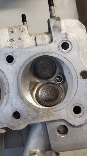

Re: Head match
14 Sep 2026 16:47
Here's a pic of the GPZ "bathtub" combustion chamber for comparison.
You can see the twin swirl pockets around the valves ( which someone somewhere decided it resembled a bath tub and the name stuck ) and squish area either side.
These can be fitted to the J hemi engines easier then J heads on bath tub engines due to the lower crown of the J pistons but you still have to check valve to piston clearances etc due to the larger valves in the bathtub head and its steeper exhaust valve angle.
The bathtub head swap is a fairly common hop up mod for the J's etc.
Some clearancing of the piston valve pockets at the outer edge of the crowns will be required.

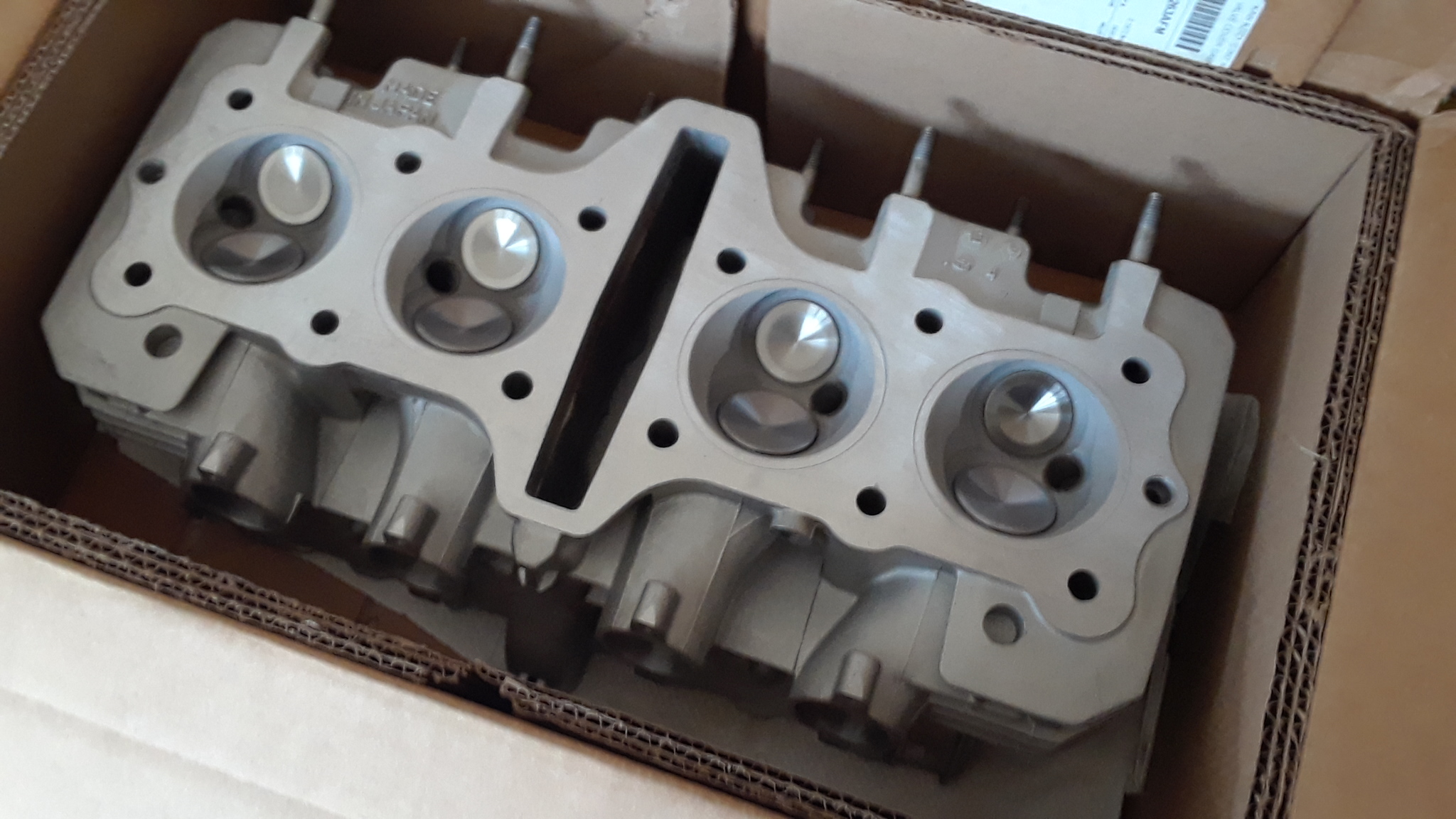

- daveo
- Posts: 3188
- Thanks: 906
Re: Head match
14 Sep 2026 17:10The 82 to 83 Spectre engines had the standard J-head I believe, including all the KZ1000 Police models produced until the early 2000's.That is a normal Hemispherical combustion chamber so you can use the heads from Z1000J, Z1000R,GPZ1100B2,and most Z1100's with the hemi combustion chamber.
The years for the Bath tub head are 83 to 85 for the GPZ1100A ,83 to 85 for Z1100R , 84 to 85 for the ZN1100 LTD and 82 to 83 Spectre...
There should be no shortage those J-heads to choose from, but the challenge will be to find one in pristine condition.
84 ZN1100 bathtub version head with stock size stainless steel valves:
1982 KZ1100-A2/1170 sleeper 😀
The following user(s) said Thank You: slmjim+Z1BEBE

Okay I didn't see the question yes it's my head the problem is I have my brother helping me reassemble and at the very last bolt on the cam caps he told me they're all moving and not tightening I should have known better he stripped every freaking one of them all eight I tried to heal the coils they didn't do a good job a company out in Washington said they'll do the whole engine over for 4500 that's including powder coating and everything I was about to do it but then I figured what the hell I just get another head I think that one's a little warped anyway but I have time serts I just bought I'm going to try them the helicoils worked in five of them I'm going to put the time search in the three that are bad I already cleaned them out and my parts washer and blew them out I I think I prefer if I can find a new head relatively in good shape I like that one you got in the box but that's a bathtub correct and I don't I'd rather go more or less what I got
