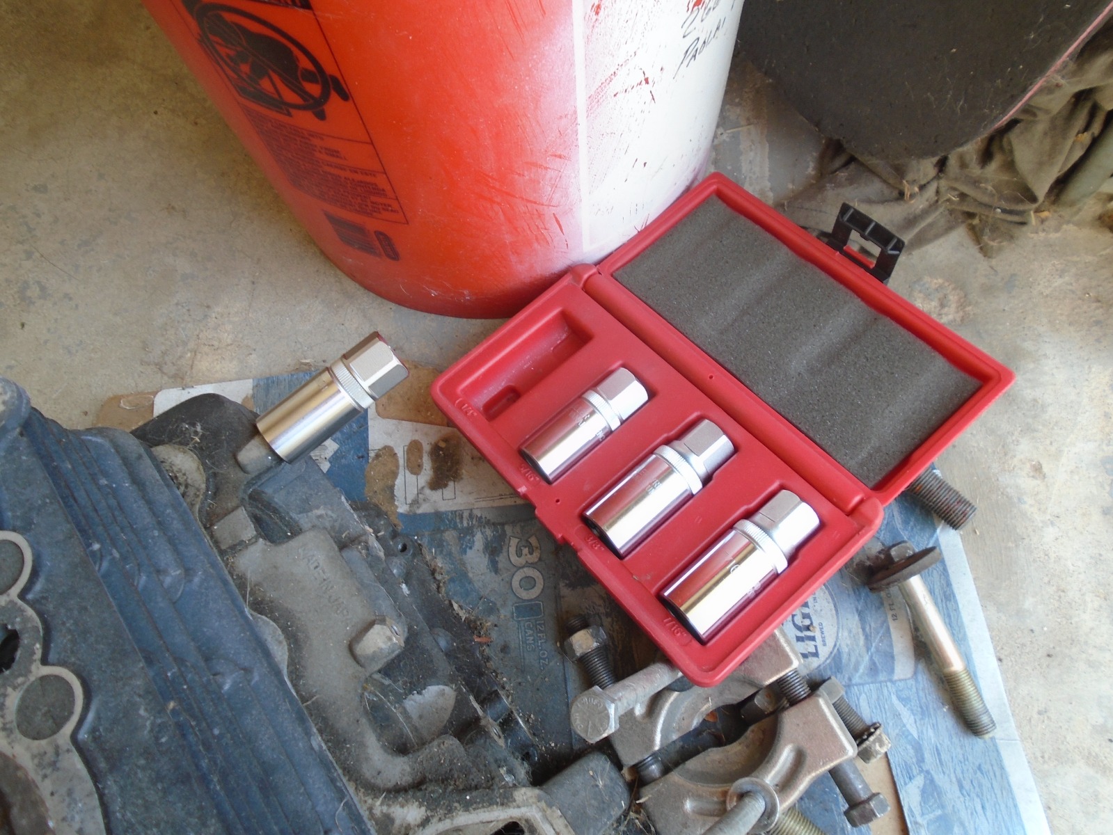

I used one of these to remove a rounded cap head screw that had minimum access.
