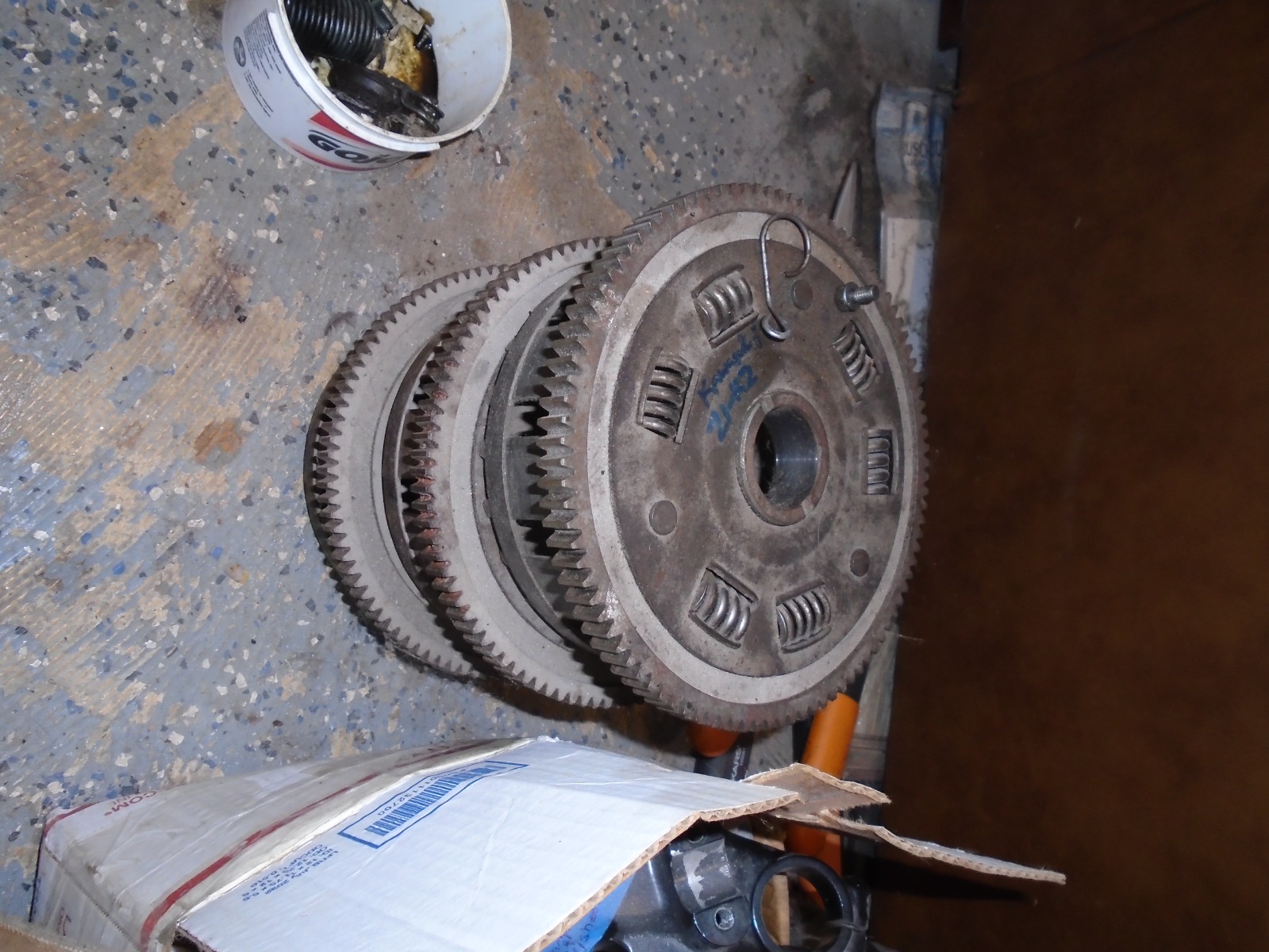

Yes,After a break of 8 years, you forget a lot of things, and as I said, I've never just removed the lower half of the housing from an otherwise complete engine...
I still have an complete Basket with all inner and outer parts here, in a very good condition: You can´t move the springs radial or axial when you touch them, looks like new.
Yes, and it´s to moisty, to cold, to srwe this days on it, have to wait for better temperatures,..ya can see the right time, when the chickens wear thinner clothes...

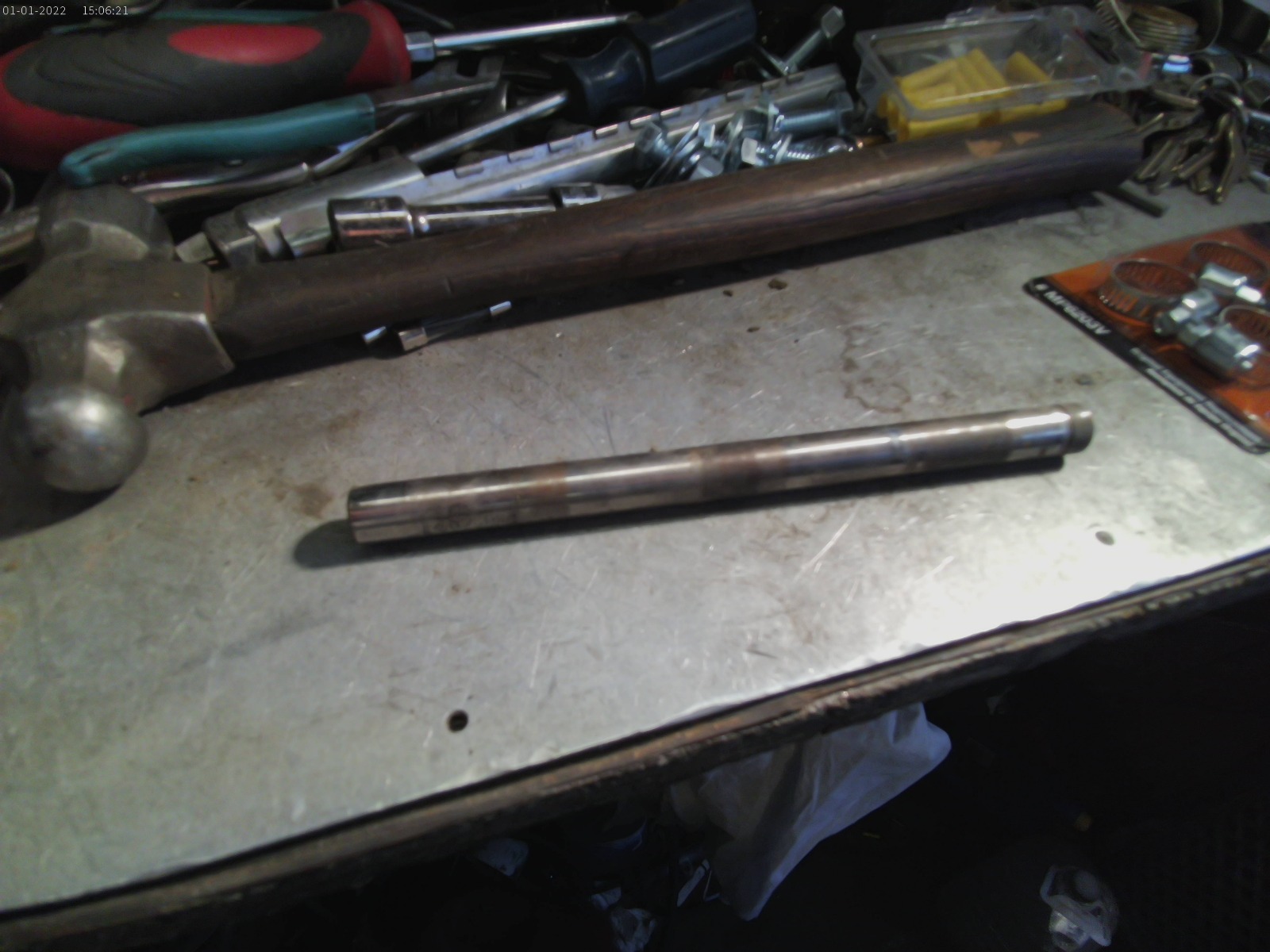

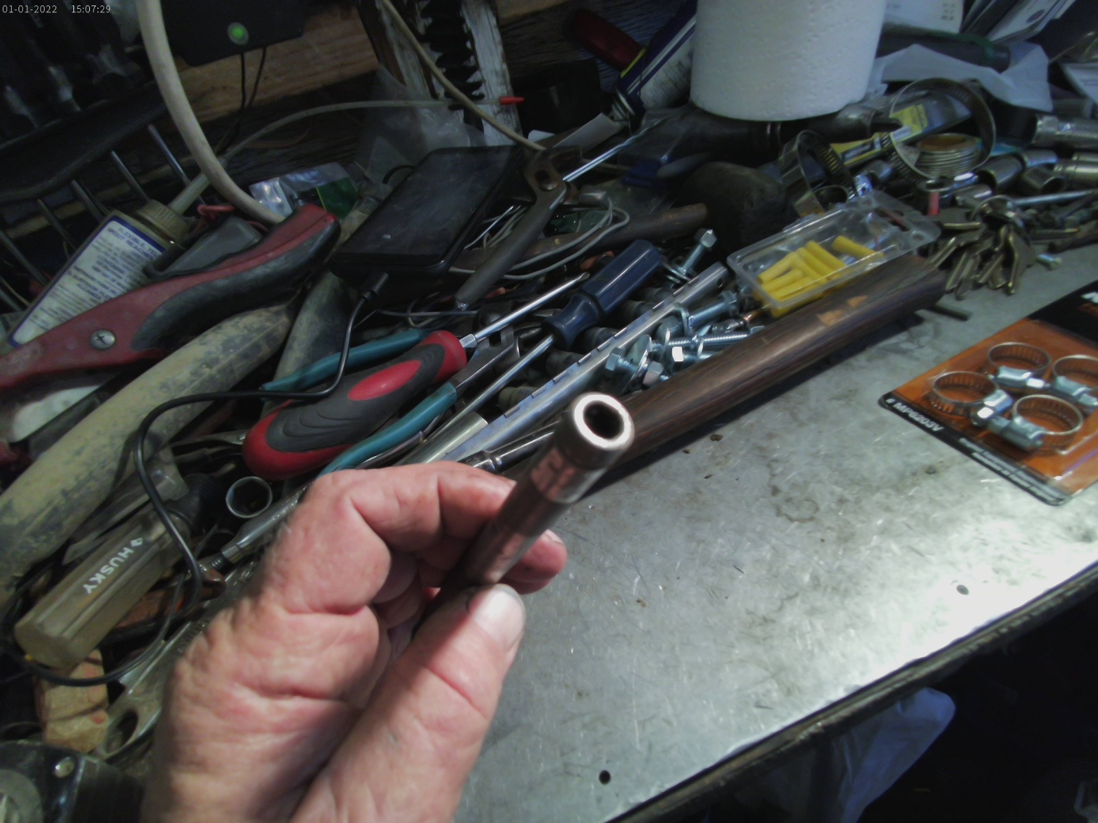

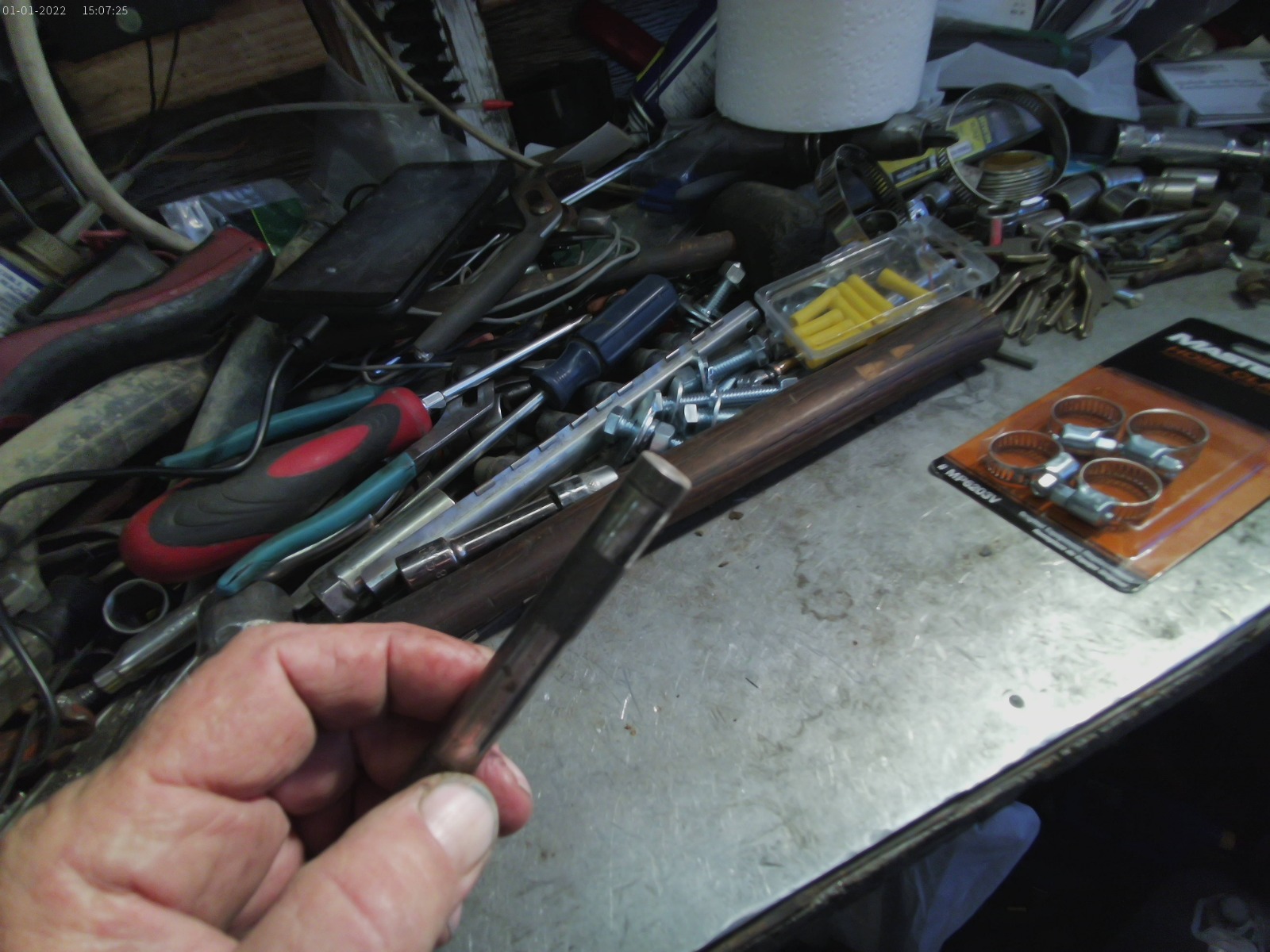

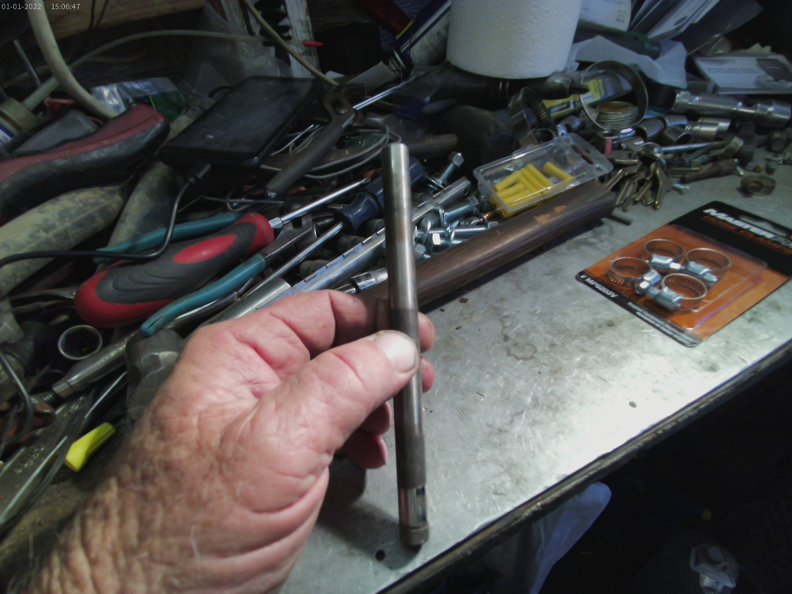

I did that to swap my transmission. The best thing I did was to install a solid shift shaft as the old one was hollow causing mis shifts in second gear and destroying the shift dogs on the gears.
APE sold solid tool steel ones.

That´s maybe also a good idea +solution, but i for myself, have never had any trouble with that Kawasaki gearboxes...exept a broken retainer spring on shifting linkage mechanism

The one I have came with a tranny I got on eBay. The one shown must be the original and when I looked it up it was said they went with solid ones. The second I installed in 15 started popping out of gear in only a few years. Then I noticed APE was selling them along with a billet main fork. The later bikes came with a heavier one so I used the new one I bought. 1075 kit and I RIDE THE PISS OUT OF IT no problems so far. It's been almost two years. I'd say it's worth looking in to.

I have used the solid shift shaft on a couple of my bikes but in general for the stock 900 and moderate driving I don't think its absolutely needed, but if it makes you feel better slap it in there. They are not that expensive .
