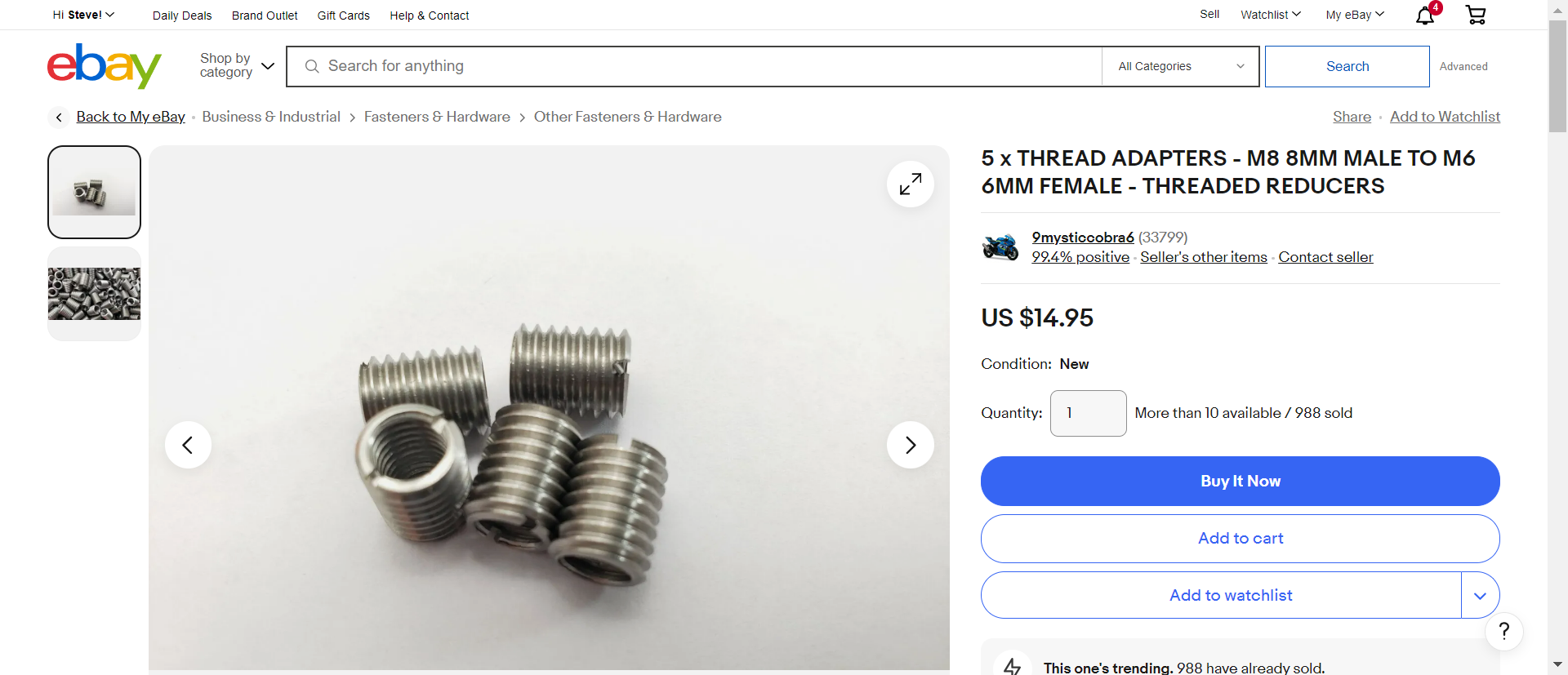

What kind of heilcoils did you try? Pics? You may have to go with inserts like these if the holes are too big for Time Serts.

yes the mounting holes for the camshaft caps.  the inserts listed above should do the trick.

Not to complex things but.. If You'd stripped one of the threads in/under one of the locater dowels, don't use an insert. You'll oversize the milling for the dowel. If all your problems are specific to ONE camshaft then you can just stud them. Ya can't do both, won't be able to get the camchain on.
