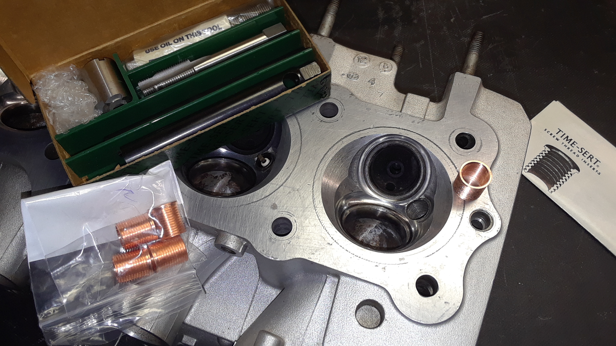

I read a bunch of posts and decided to go with a timesert repair. It's an expensive kit but seems like a high quality, durable fix. I've been looking at how-to videos and see a couple techniques to catch the aluminum filings. One is to use a bunch of grease, and the other is to use a shopvac (maybe with a straw taped at the end) to suck out the filings. Doesn't seem those two techniques are compatible since the grease would make it difficult to vacuum up the shavings. Anybody have any experience or wisdom to share on the best approach?

Time Sert was an excellent choice IMO.
I employed both approaches, and ruined a good tooth brush to wipe off the greasy aluminum shavings from the tap into a small cardboard box.
The grease applied was just enough to coat the thread cutter teeth and grab most of the fine shavings. What that missed was sucked out of the plug hole with a shop vac hose with a foot long piece of clear flexible vinyl tubing from the hardware store attached to the end.
After that a blow gun and air compressor got most of the remaining aluminum out. Best to wear safety glasses during that process, because the stuff flies all over the place.
Be sure to rotate the crank by hand to get the valves out of the way of the tap and insert setting tools before starting the process.
The end result is worth the expense of the time and money spent, especially if you can find a good used set.
I decided at the time to do all four holes though the other three didn't require it, and may do another head before it's installed to save that hassle down the road.

Repair went beautifully, easier than expected. I've always thought spark plug hole repair would be such a nightmare, but it was literally a 15 minute job with the right tools.

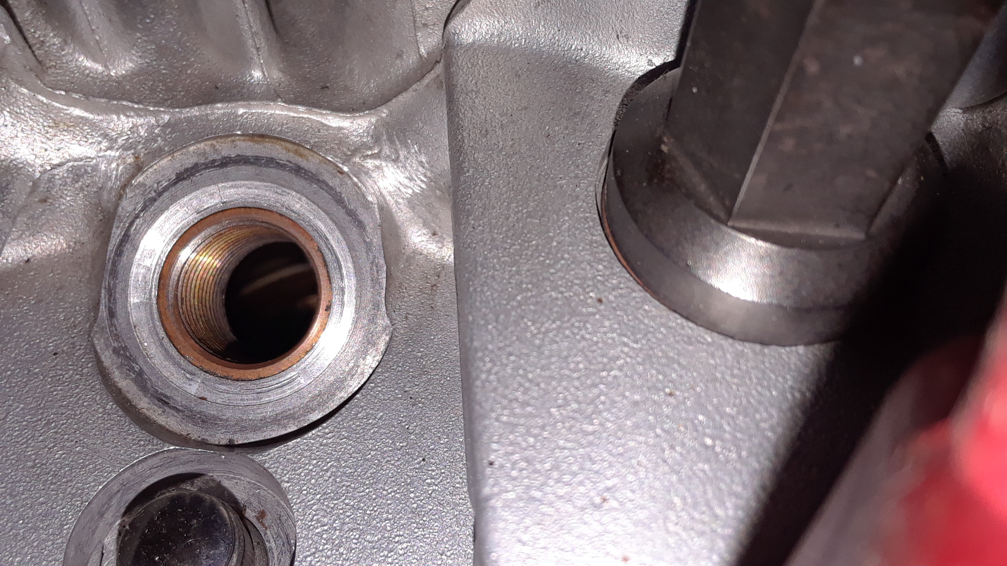

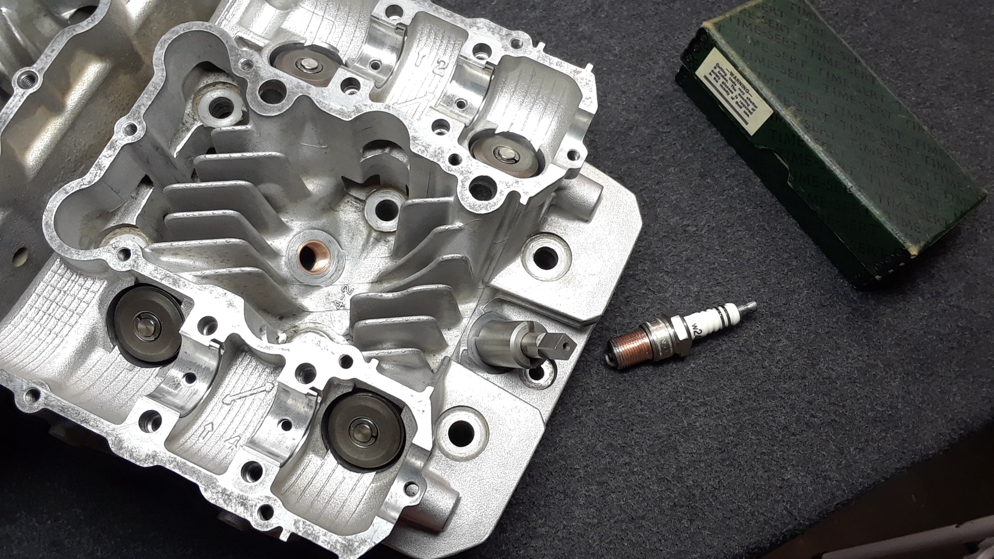

The 84 ZN1100 head pictured had Timeserts installed on the engine.
This head will likely be done on my workbench.

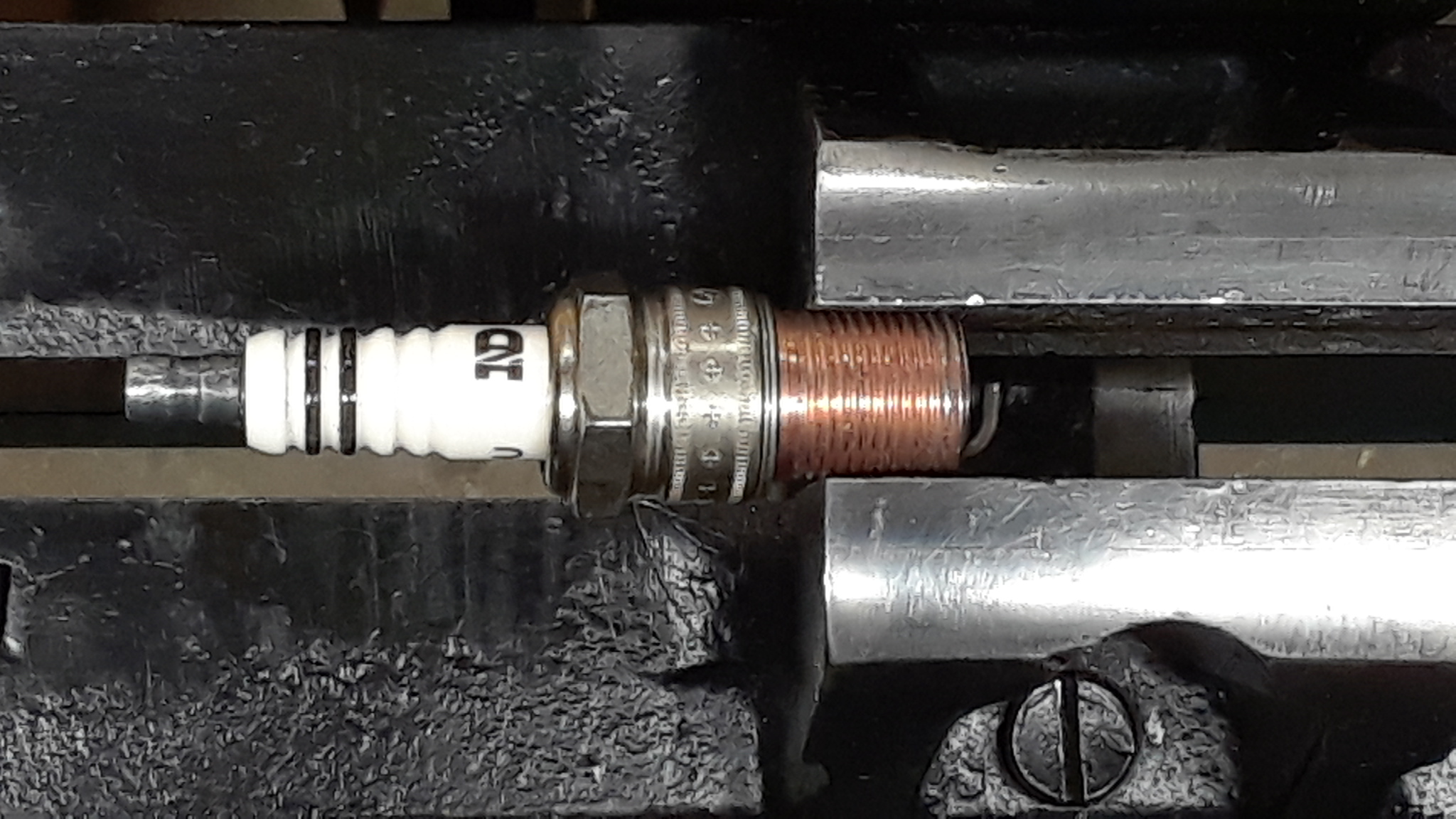

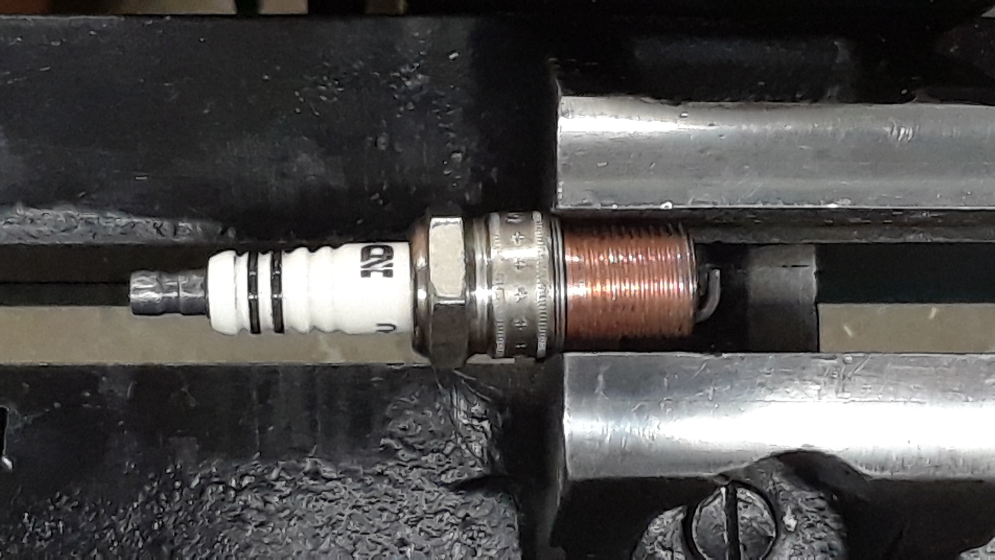

Head with four new Time-Serts installed, and spark plugs torqued to 16 ft. lbs.:
Two inserts seized with the plugs and pulled out:
Note: The integrated depth stop(s) of the countersink tool MUST make full contact with the head. It is critical that the top of the insert is BELOW the head surface when set.
Fortunately had an extra 44111 insert, and I was able to reuse one that pulled out:
When attempting to salvage do this:
Not this:
